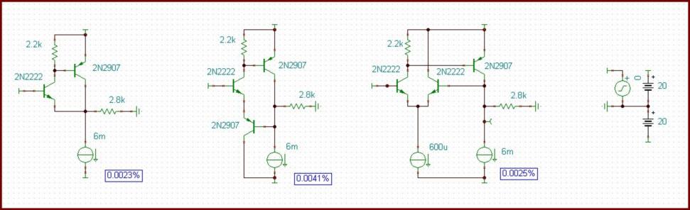

Hi Hugh
---Question: What is the principal harmonic of the NTP?
I ask this because as it's a single ended series circuit I suspect that it is H2 in the NTP (good name!), and this is quite benign.
If so, what is the profile of this distortion? I would suspect it is monotonically decreasing.....---
The sims results are quite surprising !
Not those you or me were thinking of for H2 and H3.
CFP
Fourier coefficients
k Amplitude (C) Phase (ø)
0. 615.77m 180
1. 9.99 -90
2. 117.78u 178.3
3. 179.47u -89.08
4. 76.86u -125.53m
5. 39.68u 89.67
6. 21.08u -179.58
7. 11.99u -86.66
Rush + EC
0. 1.22 180
1. 9.99 -90
2. 203.25u 178.18
3. 318.25u -89.01
4. 141.18u -68.4m
5. 72.05u 89.7
6. 37.35u -179.45
7. 21.09u -86.31

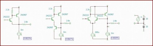

With a diff input, like the circuit at the right but with a current mirror, disto is 0.00125 %
0. 2.4m 180
1. 9.99 -90
2. 125.64u 1.79
3. 26.42u -85.64
4. 1.78u -9.57
5. 814.78n 89.35
6. 205.69n -170.64
7. 351.86n -18.17

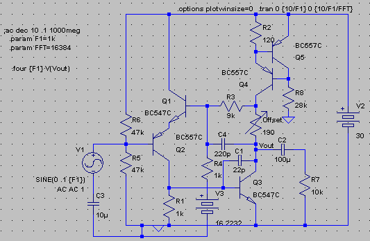

Hi everyone.
Since the original design is somewhat unrefined and difficult to use, I'm posting this version which should be nearly universal. It performs as well or better than the original. Unfortunately, it's not so much a CFP anymore, with the capacitors.

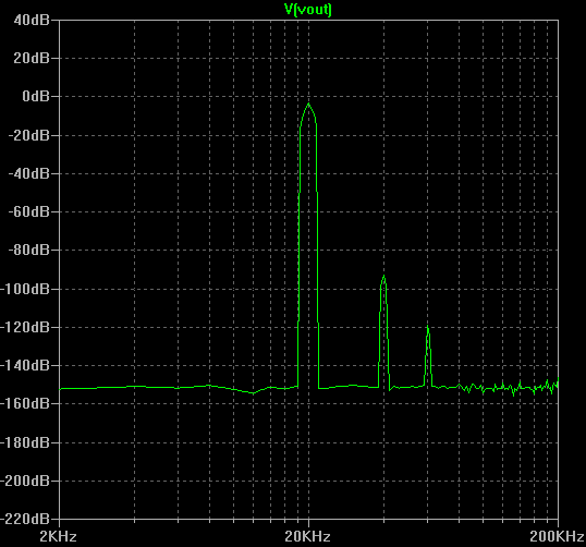

It works with very low distortion and good spectrum into a 10k load (typical amplifier) at 1V pk-pk output, but to go beyond that and have the same performance takes some more modification. It can be used without an output cap, though output voltage will wander with temperature (this could be a problem). If it's used without an output cap, the offset resistor should be adjusted for 0V output. If no output cap, the offset resistor can be omitted.
This should work at most supply voltages (assuming the transistors are within their limits - if the Jfet is too low voltage, add a resistor in series with it to drop the voltage).
If you build this, please let us know how it sounds.
It currently has a gain of 10, determined by R3 and R4, but made approximate by the Offset resistor.
- keantoken
- keantoken

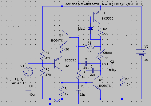

Hi
I have your email.
Can I use a bjt transistor ccs or just a resistor to replace J1 ?
And how about a 20R resistor between Q1 and Q2 emiter ?
Thanx a lot
Paul
Hi
I have your email.
Thanx a lot
Paul

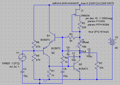

A 20R resistor will improve stability, Hugh has suggested this. I don't know if it's necessary in real life, but my simulations work well without it.
You can use any CCS. A BJT CCS should improve THD slightly, but I don't know about the spectrum. It might improve THD20 because of lower parasitic capacitance. I wouldn't use a resistor because that adds a lot more loading, which is sure to increase distortion.
- keantoken
Hi keantoken
Yes, I've read about the inter-emiter resistor in the #12 post from mr Dean.
All ok with this new schematic with bjt ccs and inter-emiter resistor ?
Thanx
Paul
Thanx
Paul
That type of CCS only works with Jfets, not BJTs.
More like this.
I'm sorry, I made a mistake when I said a BJT CCS would only improve THD slightly. THD was improved a LOT.
- keantoken

I replaced C5 with a battery to get around a simulator problem. It should still actually be a 22uF capacitor.
- keanytoken
That was an experiment. It drops gain to 0 above audio frequencies, so that I'm not amplifying EMI along with the audio, which may interfere with other equipment. This circuit is fast, so it's capable of amplifying RF. I'm not sure if using C4 for more than phase lead is advisable, but I don't see that it could hurt anything.
- keanytoken
Hi
Maby keeping C4 at 5p to keep the circuit high slew rate but adding an input filter to cut rf.
Thanx
Paul
- CFP gain stage, modifications.
