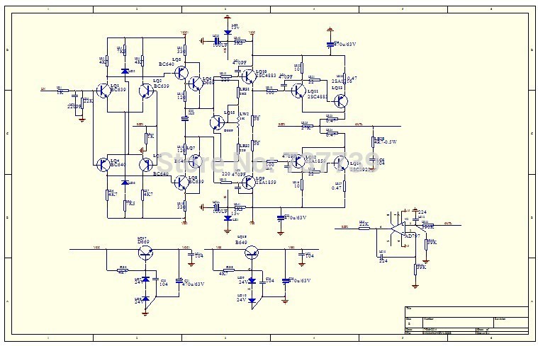

Perhaps I'm using not a perfect transistors for bias control. I've read the best choice is high HFe at low current sot23 devices.
As by now all problems with this amp were oscillations. I solved it partially, the amp is stable at some current state. Obviously I have to find a sweet spot in caps choice to suppress the oscillation in desired load.

Btw, i managed to make the OP bias current to work without Vbe multiplier with the use of diodes string for biasing. I have 3-4mV on emitter resistors. However drivers are quite hot with 150R bias resistors. I hope this is not due to oscilations.
Maximum bias current on OP devices can be set at 7.5mV on 0R1 emitter resistors with simultaneously 28.5, 29mV on positive pair, 33.5, 35mV on negative pair of input transistors. Setting more than that on OP devices or on input transistors leads to rapid current draw ( voltage drop on emitter resistors of OP transistors may increase to 20mV and bulb tester fully glows).
However, this instability disappears for a while, with appropriate bias current decrease on OP devices, if direct an air flow on input section of the amp board.
Any ideas why this happening?

Today I tried to connect the mono signal to positive input of the amp with bias current on OP emitter resistors - 7mV and the sound comes out from the speaker only couple of seconds than overcurrent appeared and I turned it off. The same happens if I repeat the procedure. Also as I wrote before the amp isn't stable when inputs are shorted to GND. Without input signal the amp is stable.
I noticed also a strange behavior of the amp.
When Minus input is shorted to GND the amp OP bias is set to very low 0-1mV on emitter resistors and there is DC offset on output -0.5V.
When Positive or both inputs are shorted OP bias is set to high range 16-18mV on emitter resistors with DC -0.2V on output. If to measure the bias current on emitter resistor of input devices while I touch the resistor by DMM leads OP bias is dropping to zero (as my light bulb tester is glowing down completely), when remove the test leads, bias resumes to previous range.
When both inputs are floated OP bias is in range 5-7mV without DC on Output.
Does anybody know what could be a reason of this?

When negative input is shorted OP devices biases only from one side, other side bias is zero.
Recently I found the reason of overcurrent while connecting the input signal to Positive input of the amp. My input cable was picking up noise from psu.
Tried to play music with input signal on positive side, negative side left floating. Thus bias is the same on both sides of OP devices. The result was fascinating. Effortless, positioned, detailed and natural dynamic sound like someone is sitting inside a speaker. It was really astonishing compared to my previous setup.
I noticed, when a heatsink gets warm or even close to hot the op bias is rising what means bias tracking doesn't seem to be working correctly. For this purpose I'm using 4 1N4004 diodes thermaly coupled to collectors leads of op devices.
Berlin 933 circuit power amplifier schematic

I haven't got yet the amp to work with Vbe multiplier.
Recently I tried to use Vbe multiplier without long wires, just directly soldered the transistors and new oscillation appeared. I can't bias the input more than 1.6mA.

Do you know how my baby to make to work? Could it be some layout faults? What is strange, all input transistors now bias equally and stability depends much also on vbe multiplier. With diodes string the amp was more stable, I could bias input up to 3mA and 8mA output. I tried to change vbe multiplier transistors to mje15034/35 without success.
