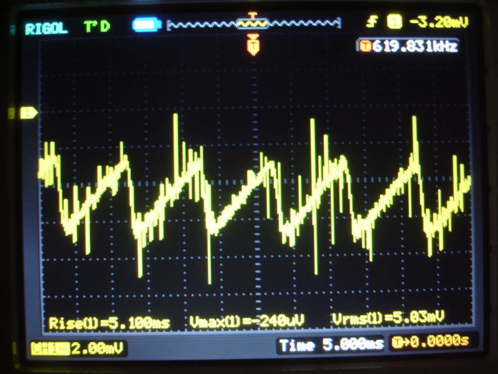

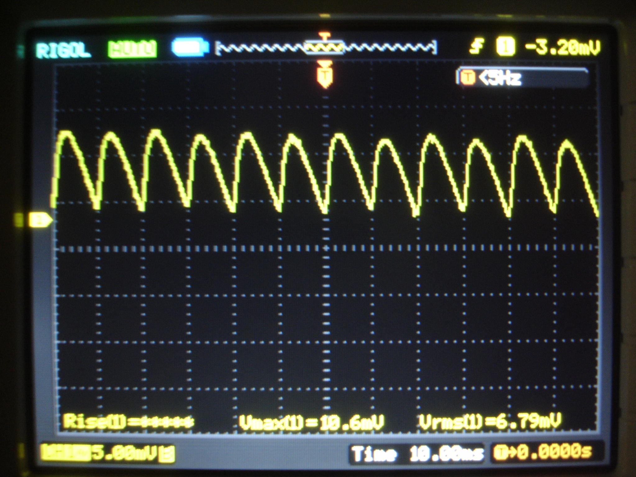

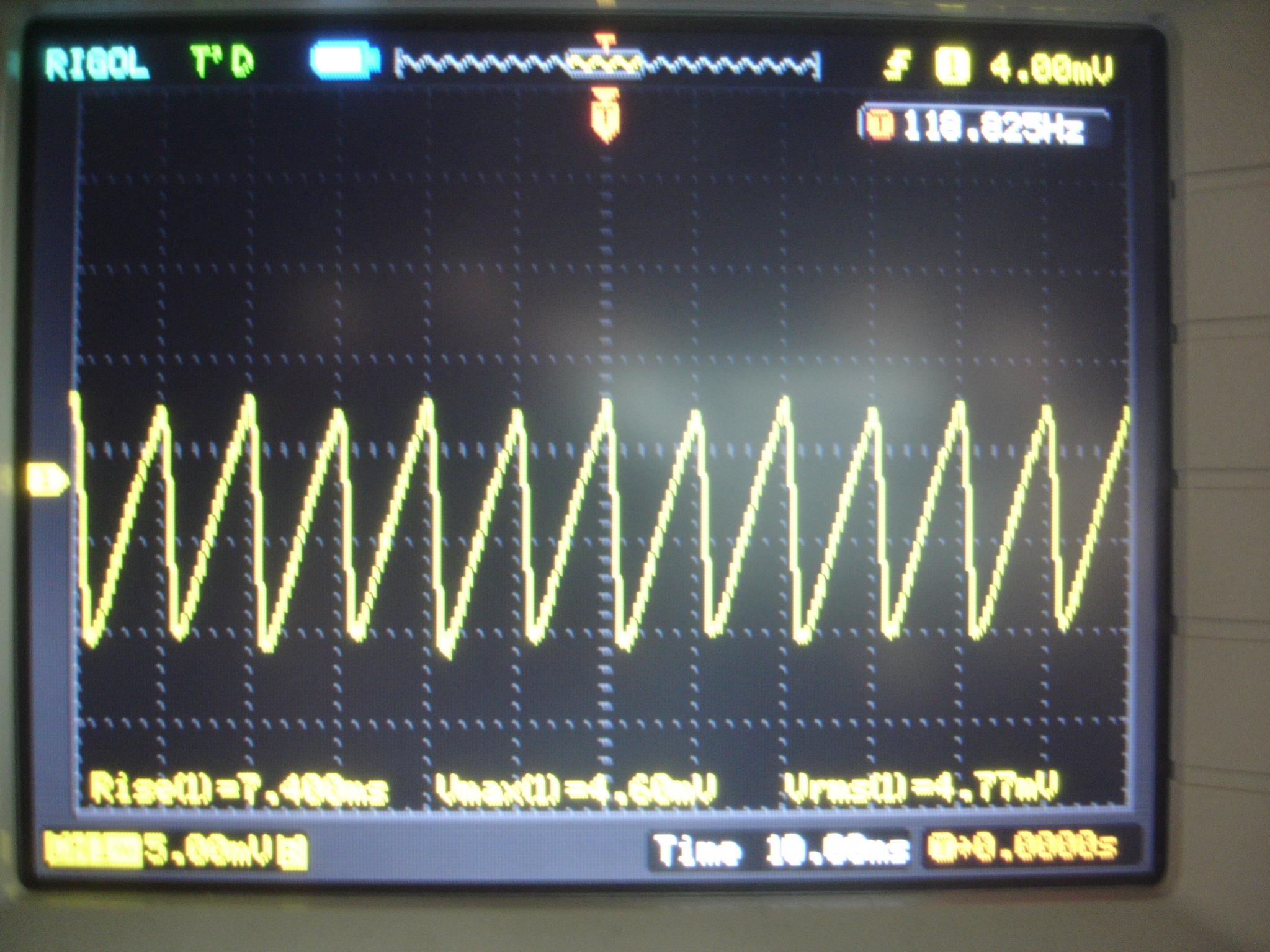

CFH9
1)ripple on positive rail when peeceebee connected to power supply
2)ripple to negative rai when peeceebee >> >> >>
3)ripple to positive rail when CFH9 connected to the same power supply
4)ripple to negative rail when CFH9 >> >> >>
Somthing is wrong here!

Looks like signs of certain oscillation.
What does it look at the output like?

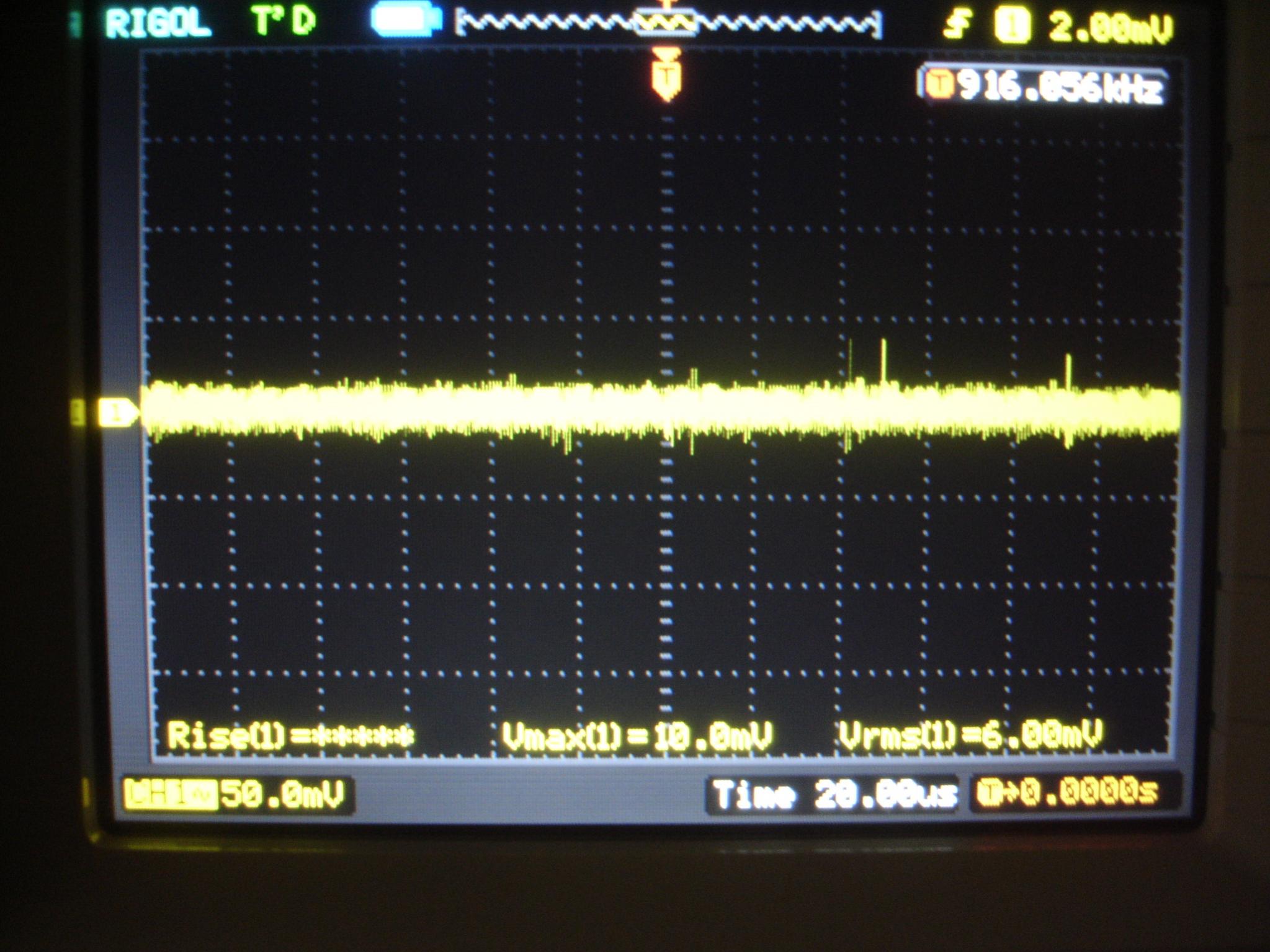

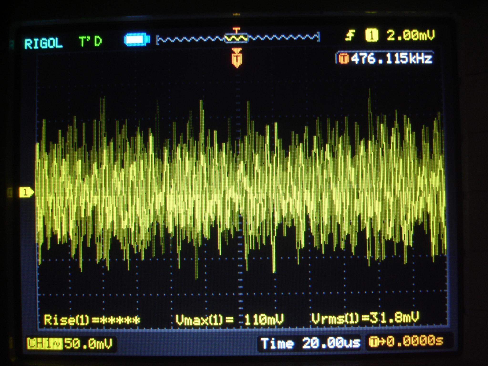

First picture output when input connected to P.C(No signal)
Second the output when input is shorted.
Gate stoppers 100R added,1N4001 to the VAS added,VAS current lower to 10mA tried....

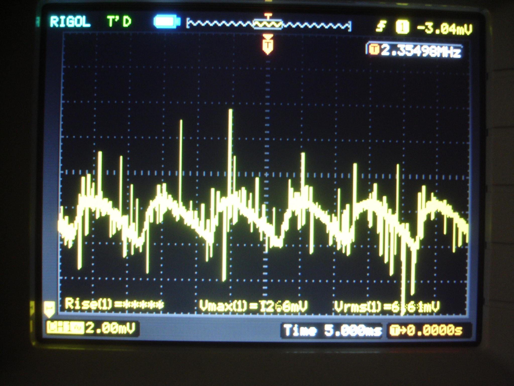

Yikes! That looks like oscillation somewhere.
The measured ripple is only 2.5mV on major division though. There is high frequency hash for sure. Possibly the bandwidth is too wide? Or could flying leads on legs of VAS and OPS do this?
Hmm... some "digital noise". Somewhere around 1...2MHz.
Yes, looks like low-volume oscillation - not violent, but influencing the whole circuit and making the rails rather "dirty".
No,you mustn't take in account this 2MHz. This has been measured even when gnd clip and probe tip are connected together.(shorted probe) and not powered amplifier.Hmm... some "digital noise". Somewhere around 1...2MHz.
OK, I see... anyway, rather high-frequency thing.
You can try to catch it, syncing by the trigger at some low-time settings - then we will see the real frequency.

Looks like parasitic oscillation. The first suspects are the four MOSFETs. They have inches of supply rail traces with no adjacent ground track and no at-MOSFET decoupling.
Try installing a 100nF at each MOSFET's drain pin to power ground on PCB, four total.
