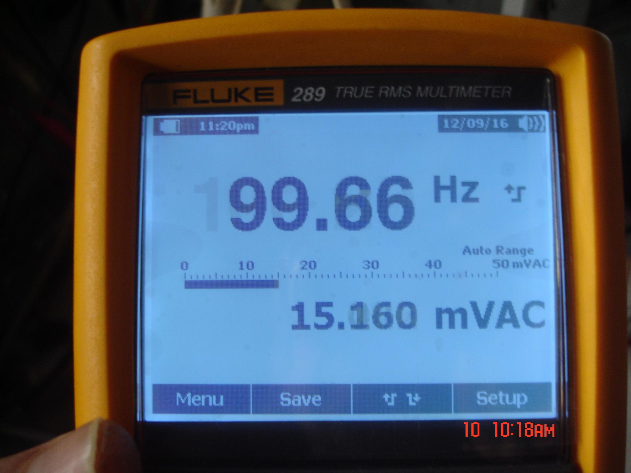

I have trace the rails by scope,if my memory serves well about 10mv ripple
Here is what the millivoltmeter measure on the rails.

In any case, seeing the waveforms at the output, at the rails, probably in the star ground on the board may really help to understand the issue.
The thing looks pretty strange right now - the rails are kind of fine, the ground is kind of fine, the spectrum is full of "garbage" from 50Hz to 5KHz. What is it? Let's see the waveform - it may give some ideas 😉
We suppose it's a saw, but... it may be something even more interesting 🙄

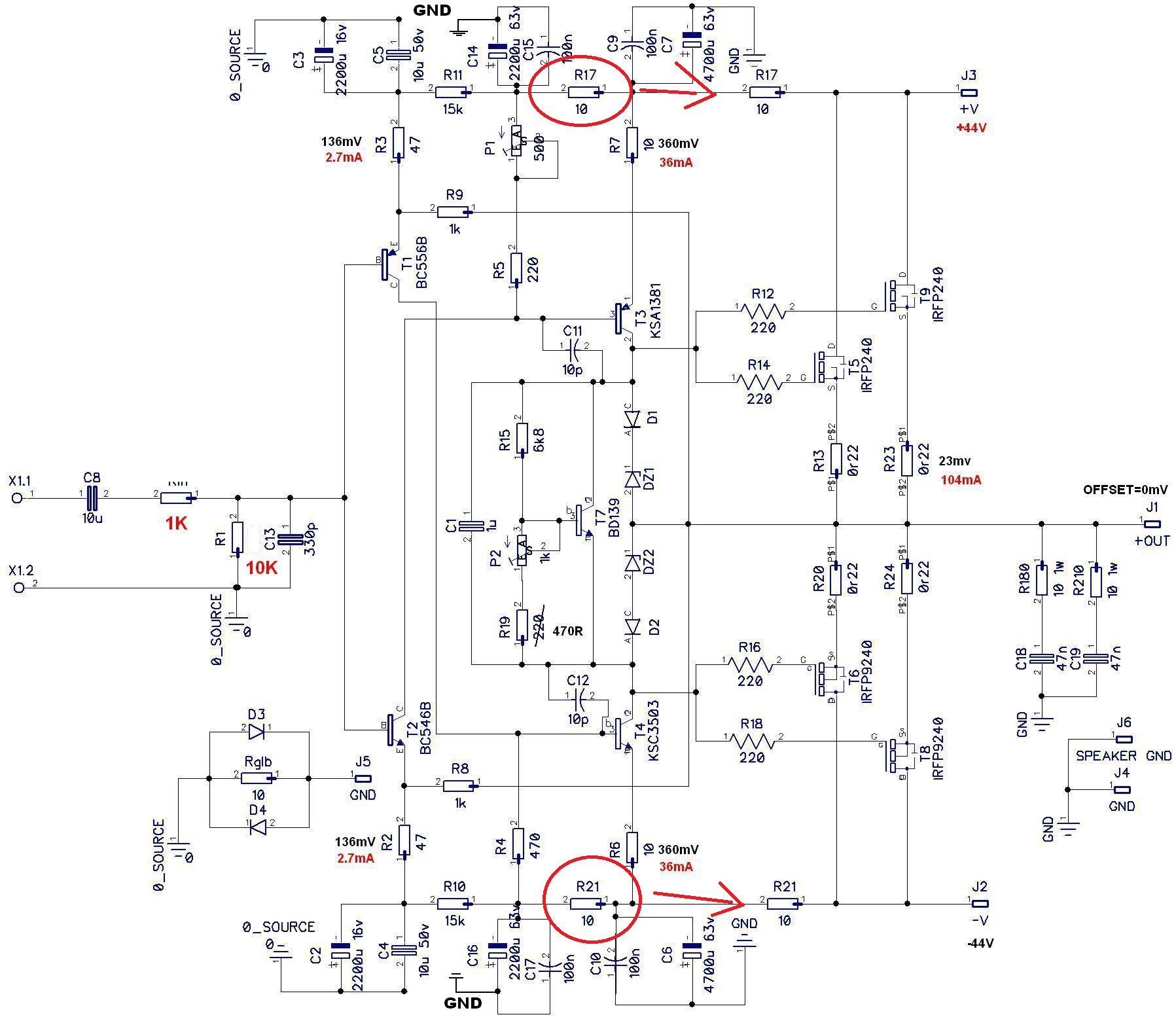

The CFH7/CFH9 amp schematic is very similar to previous CFA/VSSA-type amps as shown in Post 1, so I wonder if those amps also have low PSRR issues? If not then it has to be the layout that is causing this. Perhaps it is a ground loop between the PSU and the input stage?
Thanks for all the debugging Thimios - and sorry it is giving you so much trouble. I wonder if the flying leads on all the actives may be causing some of this?
It may be that the solution is to give this amp the extra PSRR it needs via the cap multiplier, another pair of actives and place it right before the 4700uF cap so that only a small 470uF electrolytic is needed.
The circuit would resemble Idefixes Juma cap multiplier (Cx) blended onto same board. So I see the PCB being elongated to fit one additional pair of IRFP204/9240 for an on-board Cx. It would be called CFH9Cx 🙂 Then the PSRR is not an issue anymore.
I think Still4given built the CFH7 (Sonal layout) and did not have a hum issue.

I see 2 different things about VSSA.
Current VAS with 36ma is very much increased from 15k to 18k.
R17 and R21 come after the VAS. VAS does not have network RC filter as PEECEEBEE
Thiago,i have try to power vas fron a separate capacitance multiplier without any improvement.
Can you try the following?
Install diodes in series with the 10R in the rails between output stage and vas.
Temporarily remove the small capacitors in parallel with the 2200uF feedback caps
And then power the whole amp from a single power supply.
I always thought small 100nF bypass caps next to large electrolytics were a good idea?
It's the opposite. You need some damping resistance between the capacitors to prevent the inductance creating an unstable 2pole reaction.
They can cause ringing due to impedance mismatch?
No, it's the inductance combined with the capacitance without adequate resistance that allows the high Q to take over and ring (inadequate phase margin)
95% of amp designs have a 100nF film cap next to power rail caps or feedback caps.
and this is wrong.
Compare to the advice for opamps:
Use the low esr cap at the power pins and locate the electro a bit further down the supply lines.
It's the extra resistance of the slightly longer traces/wires to the electros that lowers the Q of the 2pole resonance.
Many layout designers are not amplifier designers.
I recently had very good luck converting a JFET (J310) into a CCS by tying G to S and adding limit resistor. It becomes a 2 leg series device that can be placed right where R2 and R3 are. Use J110 should give sufficient current and may help the PSRR?
To give you an idea of what that looks like see photo below where TO-92 packages are sitting on top of a vertical resistor. This is my DAO single ended class A head amp.
? are you sure you have described this correctly?
It becomes a 2 leg series device that can be placed right where R2 and R3 are..............
you can adjust a jFET CCS to pass less current by adding a resistor to the Source lead out. Then connect this resistor to Gate and this G/R junction becomes the output of the current reduced CCS. Drain remains as the input.
? are you sure you have described this correctly?you can adjust a jFET CCS to pass less current by adding a resistor to the Source lead out. Then connect this resistor to Gate and this G/R junction becomes the output of the current reduced CCS. Drain remains as the input.
The J310 has DSG pinouts, I connected pins 2 & 3 together, the current limit is upstream of pin 1 (but suppose it could have been on other side don't know if that makes a difference), the input (+ve side) is pin 1 and output is pins 2&3. Pin 3 was more convenient to use as output pin due to extra spacing between pins but really using pin 2 soldered to pin 3.
http://danssmallpartsandkits.net/J309-D.pdf
So if a J310 has 10mA capability, for this application, we need to calculate what the R value is to get the same current as if R2 was there by itself?
The current sources being resistors shouldn't cause this anomaly. I have been using resistors in all three peeceebees which are based on the same topology and they are as good or better in ripple rejection as thimios' trace shows.
X, CCS topology you describe looks suspicious to me, as well as to AndrewT...
Attached is a good Vishay paper on jFET-based CCS topologies.
jFET has to be negatively-biased, having the current-limiting resistor between the gate and the source.
Having g-s shorted, you have the output current, equal to Idss of the transistor, which is not so good for two reasons - 1) Idss may vary just for manufacturing reasons; 2) It may vary because of non-zero tempco (proper biasing can make it close to zero).
