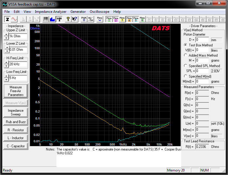

Can myself only measure up to 20kHz with DATS device but below show that nothing is linear as we would like.
BLUE: 100nF Panasonic film ECWFD PP RM:10mm
PURPLE: 10uF Wima film MKS RM:15mm
GREEN: 2,2mF Nichicon FG RM:5mm
ORANGE: 6,8mF Panasonic FR RM:5mm
BLUE: 35F COOPER Bussmann HV RM:7,5mm

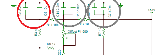

Byrtt,
Which 100nF cap are you referring to that is in the feedback network?
Ha ha will wash my mouth because haven't looked into your original schematic until now, but only looked at the various builds and it looks like now, that except layout by idefixes all others include a 100nF in feedback network as seen below (100nF/10uF/2,2mF in parallel).
Interesting that Sonal added the 100nF bypass cap on top of the 10uF bypass already added to the 2200uF elco already there as the mail input stage supply rail. I don't think the 100nF is in the feedback path as it supplies the rails for the input stage via the 47R current limiting resistors.
But, yes, my schematic doesn't have that 100nF cap there. It's on the middle VAS supply rail cap though.
Byrtt,
Thanks for the DATS impedance plots of various caps. You are right, most of my caps seem to follow the green line (1000uF, 2200uF and 4700uF no name brands) and end up with circa 0.05ohm ESR at 10kHz and around 5ohm to 10ohms at 10Hz. So for deep bass, the amp impedance will probably be limited by this - unless very large dia copper wire runs from main PSU is provided.

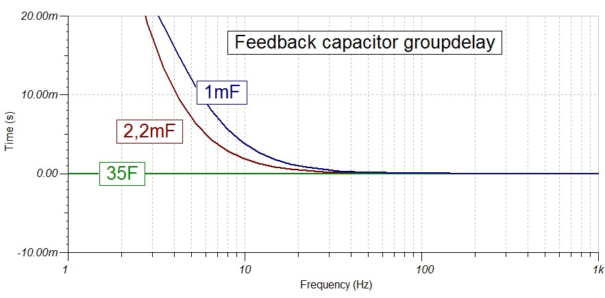

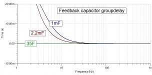

Can it be right i think from your latest two post that you read C2/4 and C3/5 little wrong : ) as being part of supply rail but its the ones called feedback capacitors. Try in your TI TINA sim and pull out C6/7/9/10/14/15/16/17 which all belong to supply rails and nothing will change in new sim because TINA's power supply is perfect clean and don't need those caps as we do need in real world, then try pull C2/3/4/5 and amp wont swing AC anymore. Thats why i care impedance without resonance for that feedback capacitor network position, well wish it to be linear which it isn't in real world as seen in DATS plots that can't show inductance reality for large elco's above 20kHz, only TINA think so and simulate with a perfect linear 2,2mF capacitor. Also if you bypass your input coupling capacitor C8 with a wire amp will still have lagging time domain in lows and high pass function in amplitude domain because ruled by actual value of feedback capacitor network, even there is no coupling cap in hot signal route. More info for those feedback capacitor network is if you bridge two amps then don't couple feedback caps to ground but use only one set of feedback caps on one amp and cross wire it to same point on the other amp so its a virtual floating ground.

Byrtt,
You are right - I usually think of the "feedback cap" as called the "shunt capacitor" and on a differential LTP input, it is connected to the two feedback resistors with the shared point of the two resistors connected to the negative side transistor base of the LTP, with the positive of the elco shunt cap connected to the smaller value resistor. With gain equal to ratio of two resistors (numerator being one connected to output stage). In the case of a singleton input stage, the current feedback here does indeed get connected to the caps which looks like a rail cap for the resistor-based input stage current source, but also serves double duty as the feedback shunt cap. Here, the lower the ESR, the better the bass response. Gain on this amp is 1k/47R or about 21x or 26.4dB, a bit lower than usual 30dB power amp gains that I usually see around here.
I think it is R10 & R11 that are causing the confusion.
Are they a positive feedback to help with setting input offset? The two emitters have to be held off signal ground by one Vbe each.
If one were to set these two to infinity, the feedback route looks completely conventional: output>1k0>feedback node>47r>signal ground/return.

When we now talk same you maybe better understand my post over your virtual audition thread too where pointed to the small but audioable broadband HF lift seen for your JK VSSA build compared to rest of the amps at that time. Repost plots below to show it looks like frq dependent lowest impedance spike for 2,2mF green trace cover that little bit boosted area. In sim where frq dependent feedback cap have lowest impedance output amplitude will be hottest, that's why I wrote that maybe the 100nF paralleled SMD resistor still4given had below PCB could be some the culprit to instability that was tamed with gate stoppers that you didn't like because in sim it killed HQ square waves.

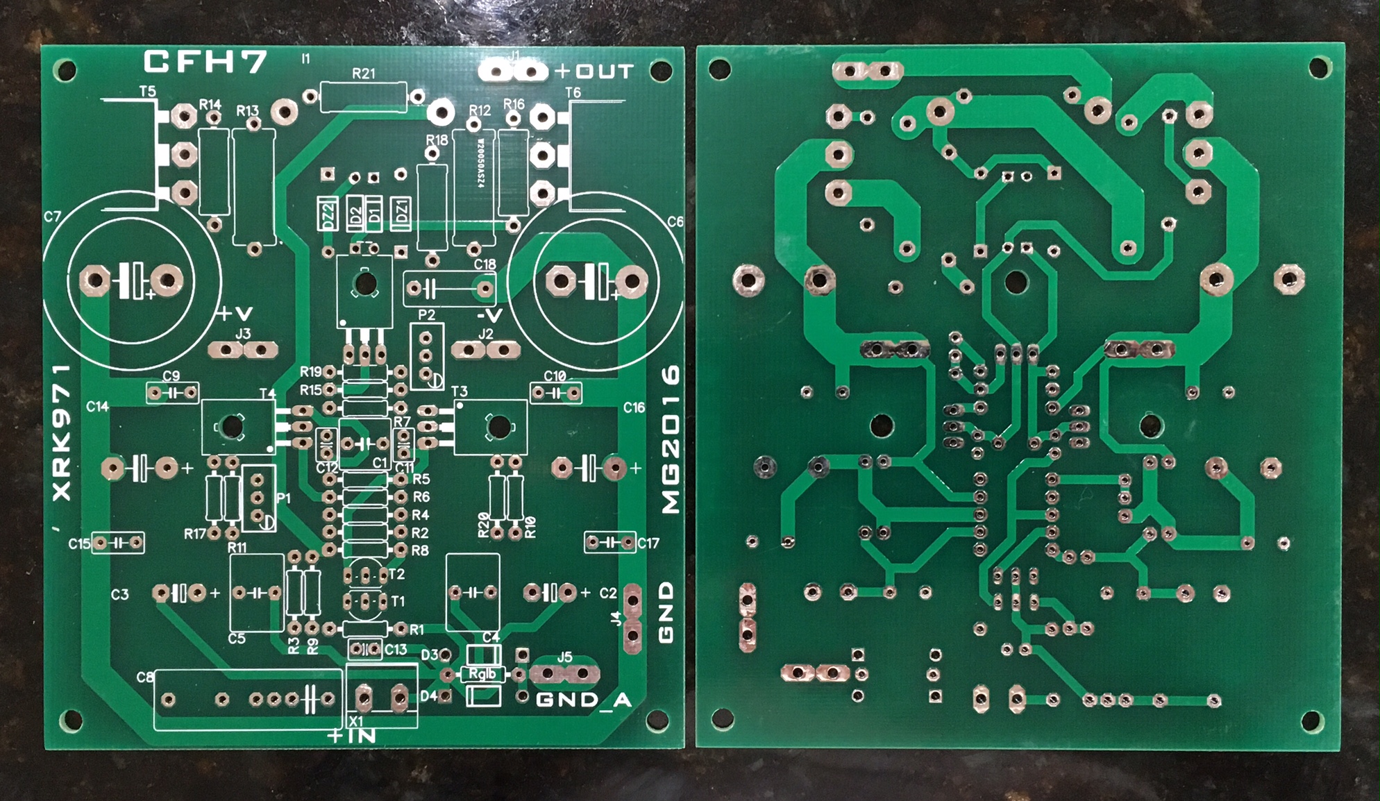

CFH7 PCB's arrived
This is the Idefixes design v1. Looks great - but looks like a drill thru-hole for securing MOSFET heatsink is missing. I can manually drill that I suppose. Looks like a straight forward build though.
Gerbers for this board can be found here:
http://www.diyaudio.com/forums/solid-state/294834-cfh7-amp-11.html#post4795571
I believe this is the parts stuffing guide then:

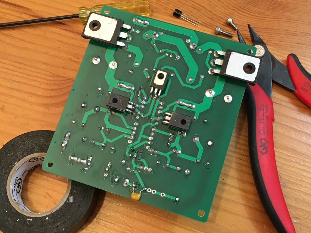

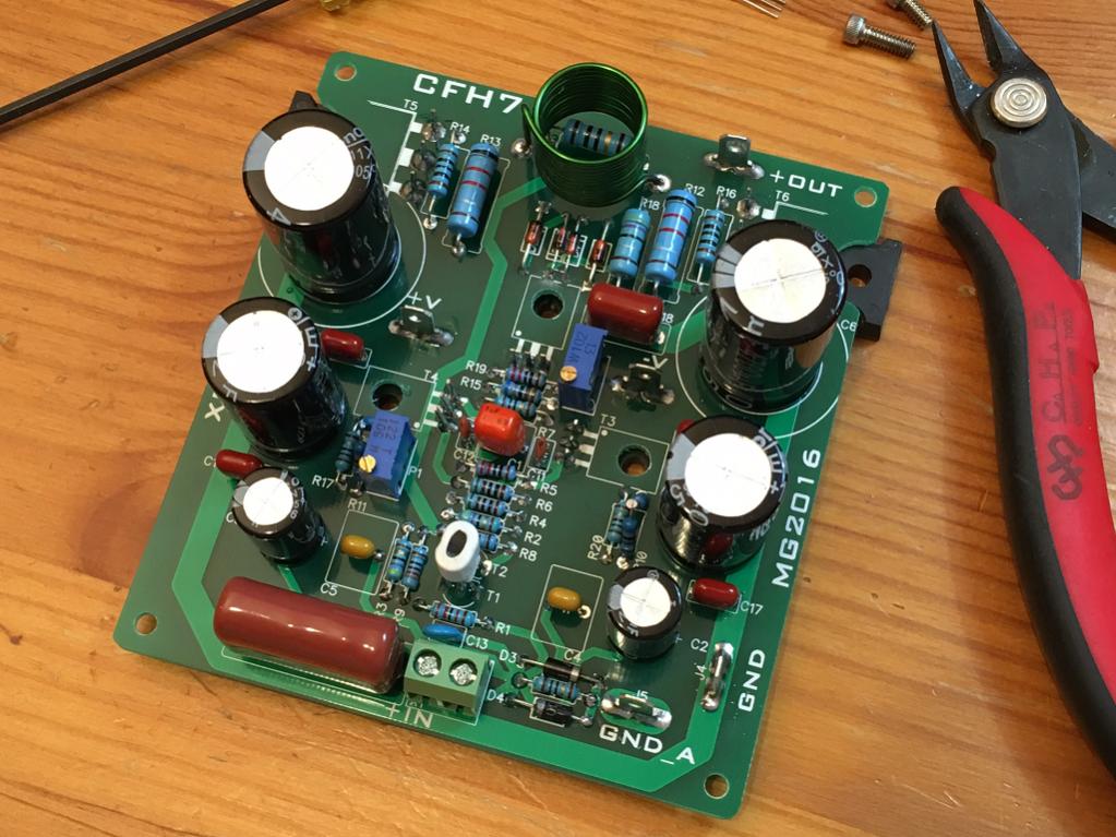

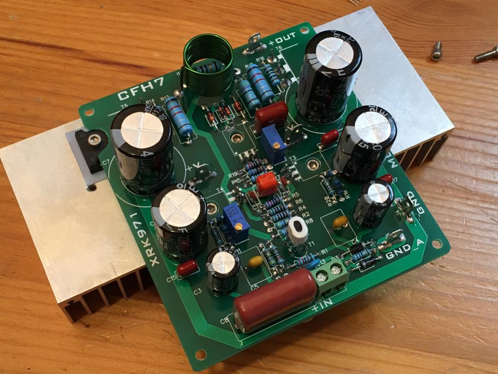

Build progress
Making progress on the build, one amp is done and other just requires installation of transistors. Initial test the Vbe multiplier works and bias current can be set to almost any arbitrary value. I have it at 150mA now. However, I cannot zero out the offset. It bottoms out at 0.88v. I will have to figure out if I need a bigger or smaller value pot for the DC offset.
Maybe it is related to the inability to set DC offset close to zero, but there is 60Hz hum on this amp. Seems like there is a ground loop on the input stage? Will need to look at it with fresh eyes tomorrow but if anyone has ideas? Not sure why the 500R pot + 220R does not seem to be balanced by 470R resistor. The pot has to be set to zero ohms to get the offset low as possible. Note that I even matched Hfe of the input transistors BC546 and BC556 bot with Hfe=375. Feedback resistors are 820R instead of 1k (ran out of 1k and I could use a little more gain). Also, using 1000uF instead of 2200uF feedback shunt caps (ran out of 2200uF's).
Or is this hum caused by the big U shaped ground bus making a loop around the input stage?
Frontside:
Backside:
Mounted on heatsink:
