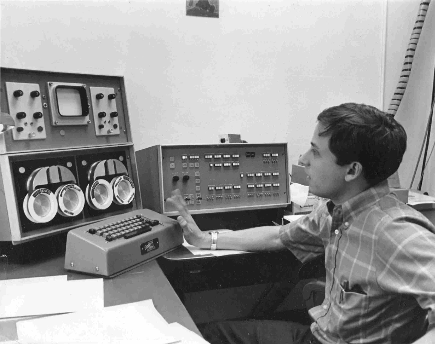

This is the first computer that DEC made. They built it for Lincoln Labs at MIT, I worked on it at Washington University Med School in St. Louis.
The big cable going to the right in this photo were to the COMPUTER, the input console sat on the desk...
The PDP 11 had more than 12 bits, but it was still Octal.

Edmond, you are dating yourself, a 12 bit octal PDP-11 wow, did you use paper tape to load it?
Our team used it to test modules of the F-15 Fire control and radar systems for the Saudis.
Hi Kris,
The PDP11 was a 16 bits machine. In the early seventies however, we did have a 12 bits machine, the PDP8
As David remarked, you must toggle 12 switches (one for each bit) several times, i.e. word for word. I can't remember how many words (maybe 10?). In this way the so called bootstrap loader was entered, which in turn started the paper tape reader to load the operating system, called OS/8 (hope I'm correct).
THOSE WERE THE DAYS 😉
Cheers, E.
Yes, those WERE the days. I remember toggling in the boot-strap loader every time you wanted to run the machine/software. We had a lot of PDP-11/RT-11 in use and I was able to put together a whole system from spare boards and used it at home. I used it with DADisP software --- which is great as you can do circuit changes and see results in real time plotted on the screen. Watching a MontiCarlo run and see the curve change on the screen is Still very cool.... SPICE was young and clumsy then.... even with the math co-processor IC. But it was fast as the archectchure was developed for number crunching. Once, I used the PDP-11 for an interface to run/gather data for an experiment called Coal Gasification.... now used to extract gas from deep underground coal seams. Lots of fun stuff. Then HP bought DEC and soon afterwards the PC was taking over and DEC is no more. BTW - the early Microsoft op system was taken directly from the DEC system.. stripped down.
