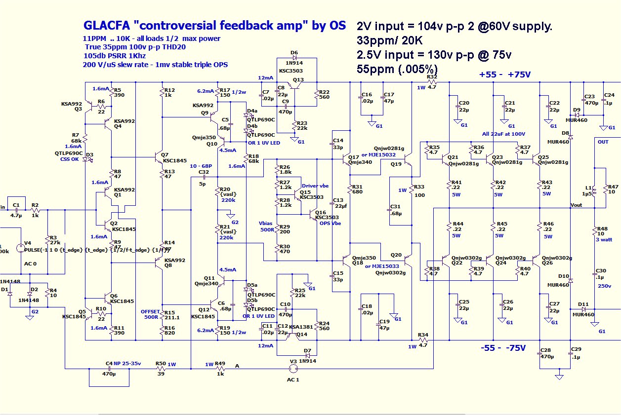

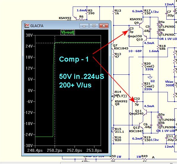

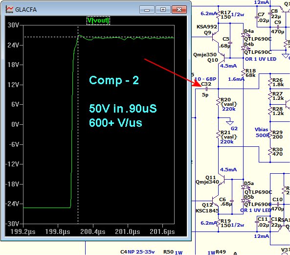

Thank you , Bob.
Comp. 1 below is standard (luxman does this on the M120a).
Not bad , but not a "slewmaster" .
Comp. 2 below is the MIC . wow!
I have done the "housekeeping" on the design (last attachment). In simulation ,
I can not find any issues. In fact , none of my sims have a greater
model/passive component tolerance.
I scaled to 75V rails and "pushed it" . Slewed from rail/rail (-6V) in .2uS ! (with MIC).
PS - Bonsai recommended MIC to me - credit where it's due !
OS

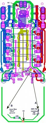

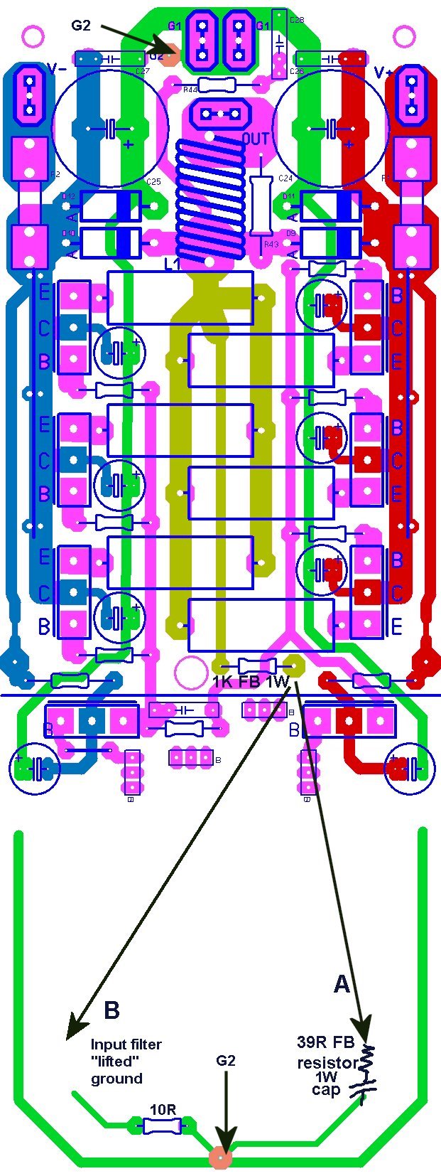

Os,
From where the decision to connect the feedback shunt resistor to main audio ground and not to input signal ground?
Os,
That is the question I asked Mr. Marsh.
Actually, "G2" is the secondary star connected to the high current
main star (G1). This was Andrew T's idea and serves well in reality.
What I noticed with CF ... If I connect to the lifted ground "behind"
the 10R resistor ,the 50ma currents from C4 modulate that ground.
On the NX or a typical VFA (less current) , this will only take a few PPM
off of the THD.
On the VSSA , I hooked it's 2 caps to the lifted ground and THD
suffered considerably. Unless I get an answer , I might just have
a jumper to connect to either ground on the prototype.
OS

I'll try the visualization method of communication.
Below is the ground scheme , I use this for VFA , but I tie the "drawn"
R-C to the lifted ground. Both NFB and G2 will be wires bridging the PCB.
OS
