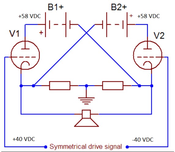

Let me answer the question with a question. The schematic depicts two floating batteries/supplies, each with 39 Volts DC. Assume that you have no other additional power supplies / DC sources.
What is the maximum signal swing on the speaker, that can be achieved in the circlotron configuration?

In the middle of the circlotron's 4+4 ohm speaker, you have your ground reference.
In the case of the traditional architecture, the 8 ohm speaker has one of the ends grounded.
In the circlotron: what is the maximum voltage peak that can be achieved on one of the ends of the speaker, when compared NOT to the midpoint, but to the OTHER end of the speaker?

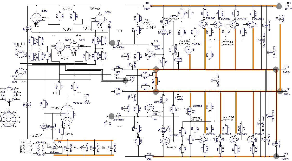

Beware: this is a fast and dirty, preliminary and untested, un-simulated draft version of what was on my mind, .... before i abandoned it (in essence, not even sure if it would work):
Electron tube front end;
Short signal path;
AC coupling (beginners mode - coupling capacitors - allows to treat front end and back end somewhat separately);
Fully symmetrical forward paths;
Fully symmetrical negative feedback paths;
Thermally stable Sziklai based OPS, without need for thermal compensation;
OPS batteries: 4x floating 58V DC, 10 Amps; 0.2F filter.
Brutal Force electron tube pre-driver;
Non-standard driver, Sziklai "master" with negative temperature coefficient
Paralleled "slaves" with "irrelevant" temperature coefficient;
Driver and Output transistors screwed directly (no electrical insulation) on to the copper speaker bus-bars, via silver paste (such as for microprocessors). Speaker bus-bars electrically insulated from heat sink. Contact area between each bus-bar and heat sink: 4cm x 38cm;
4 x 0,3K/W heatsinks;
2 x toroidal 1,1kW, 2x 43VAC, 12A.
Current gearbox ratio between Sziklai master and slaves ensures isothermal stability
Speaker terminals mounted to the (extruding) copper bus-bars, rather than to the chassis.
Manual KISS bias for upper and lower branch;
Simple two-slope WAG current limiting; Red LED's signal that a current limiter kicked in;
{edit: some battery symbols need be rotated}
... Abandoned due to unsatisfying peak-to-peak output swing capability.
{edit: the picture as presented - has single slope current limiters}

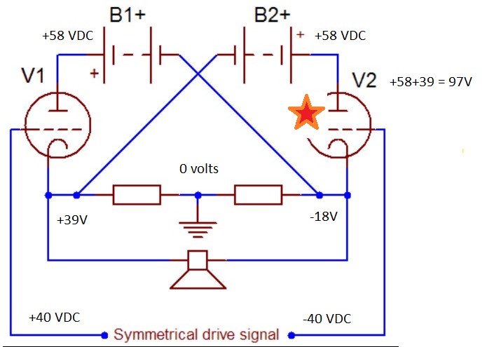

So here is a riddle:
Heavy input swing: +/- 40V.
Assuming 1V saturation of ordinary BJT transistors (not tubes), what is the output voltage on the speaker terminals?
What Vce voltage rating for the BJT transistors?

It is indeed a riddle. So you have drawn essentially the output stage in the Spice model on this thread. For each tube we substitute a NPN transistor with the collectors to the positive supplies and emitters to the load. I see you have included your virtual ground (over and above the invisible midpoint of the load) which the Spice model does not have. And I should say the answer is 78v but in reality it is zero? Did I pass? 🙂 Now my head is hurting so I think I will open a packet of chips and watch a movie 🙂
Wiki has drawn it. I just borrowed the graphic and put on some voltages. Yes, the tubes are simply NPN transistors. Plus from batteries to the collectors, Minuses to the speaker and emitters. The "virtual" ground is ... very real. It is your reference point for the voltages that control the bases of the transistors. It is in the middle of two half-speakers.
The question now is: how do you get 78 Volts on the full speaker, if the battery has only 58V? Assuming that one of the transistor bases "sees" +40V signal. It would be logical to assume that the emitter and associated half-speaker "sees" +39V. But referenced to what? To the other end of the speaker? NO !!!!
{ Archimedes: Give me a place to stand, and I shall move the world. }
It is referenced to the speaker midpoint. Now, since the speaker is actually a series connection of two logical four ohm speakers .... +39 ... 0 ... that would imply, that on the "other end" of the full speaker you have -39V. But .... Where is it supposed to come from?
Such a voltage is not available. Such a voltage does not exist. The battery has only 58 Volts. You can not get 78Volts from a 58 volt battery. What about the "other battery"? It does not help whatsoever. It is passive and is not doing anything. Apart from trying to fry the other idling transistor, stressing its Vce_max.
Maybe I am wrong in this thinking, but that is how I "see it".
OK, I'm probably too darned slow here, but gotta jump in -- this thing has had my brain all bent up for days.
syn08 (post #3) and mjona (post #7) lanced and dispatched several excellent points. But there are some other bits worth mentioning IMHO.
The diamond buffer has several issues. Operating both sections at the same current density (R37=R17==R68=R69) gains little and exaggerates transistor imbalances. I'd rather see a 5 - 8:1 increase from the first pair to the second. Also, the 'normal' output node (the joint between R68 and R69) cannot be driven as you would the inverting input of an op amp -- it needs a return path to ground. Without it we won't get the current unbalancing to the current-mirrors that we want. And it needs to stay within about +/-25 mV of the input -- the Bases of Q24 and Q28 -- so it is useful for global NFB. Just lift the op amp (U2, U3) ends of R45 and R47 and connect them to signal ground for each side. Gotta admit the compound drive is beautiful aesthetically; but what nightmare headaches can come from giving that stiff pair of emitters so much influence over U2/U3's outputs!
The current-mirror topology also needs some work -- 48:1 is too high of a current gain ratio. Try lowering it to 6 or 10:1 by replacing the 2k4 resistors R53 and R72 with 330R or 470R. Then give the diamond buffer more current by lowering R38 and R39, and let the 2nd stage have more of it by increasing R37 and R17. (Formulae for this are available, but I don't have them handy. Probably faster/easier to just tweak them in LTSpice, anyway.)
I haven't seen a cascode VAS yet that didn't have stability 'problems'. The doubled Q5/Q20 and Q21/Q22 are especially puzzling to me -- it can't be for dissipation concerns since the Vce is about 5V. More parts means a wider distribution of specs -- and much higher sensitivity to device variability. The Darlington only compounds your troubles. I'd remove them and select higher gain devices for Q5 and Q22. If you simply must keep them, add a forward-biased 1N4148 or similar between the Base and Collector of Q40 and Q27. That'll fix the unmatched # of Vbe's, restoring linearity and temp stability.
Even with these changes transistor selection will be crucial -- you can probably forget rolling part numbers. There may be only a few dozen devices in the whole book that will work without careful, tedious hand selection. There are plenty of good reasons that current mirrors are ubiquitous in analog IC designs; almost every one adds another challenge/shortcoming to a discrete design.
From the MJE1503x drivers (Q10/Q16) on, the problems get worse. These are current sources without a rational, resistive load -- the gain approaches infinity. C3 and C1 impart a 90 degree phase lag, adding another challenge to stability. Q1 and Q30 have no Base-Emitter resistor -- there must be one. Without it quiescent leakage alone can start thermal runaway, especially since this modest 2W device (the 2SCR375P at least) is tasked with driving 96A/1200W-worth of outputs. There is no temperature compensation or mechanism to control cross-conduction. The Collector currents of Q1 and Q30 have only the 390 ohm R20 and R79 to provide a return path to the bi-polar supply; the entire output stage -- both sections and their floating power supplies -- is/are pulled positive by those currents. The global NFB will then try to keep both outputs near bi-polar ground by the only means it has: Reducing the conduction angle which will dramatically increase crossover distortion.
Mooly , I think you were on to something by subbing FET's for Q1/Q30 -- solves the 'missing return path for their Base currents' problem. But it would be an increase from the (already problematic) 2 Vbe offset between Q10/Q16, and Q32/Q33 and the corresponding output pins.
Q13 is under rated. Even with R121 disconnected and no signal, Q13 is being asked to dissipate 1.42 watts. Even if it was capable of providing bias control, a more complex circuit would be required. I'd rather see R20 and R79 returned to bi-polar ground (someone else already suggested) -- that would allow good quality NFB without having to use an instrumentation amp topology or other sophisticated (read 'slow') techniques.
The existing input buffers would allow asymmetric signals in the output sections, which could cause problems. Much safer to convert the Balanced inputs to SE, then phase-split back to Balanced for the VAS. And yes, it is surely much uglier.
Take out one of the offset servos, U1 or U4. Having two just invites them to fight each other, making the result half as accurate. What we care about is the quiescent voltage across the speaker. The voltage between either terminal and bi-polar ground -- not so much.
It's a very aesthetically pleasing design, I agree. But I'm sorry, I don't think it will work -- IMHO.
