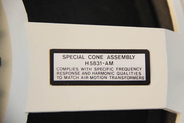

Trying to recreate the speakers we used to build in the 70's. The H5831-AM was custom built for Audio Mart in Kansas City, MO as an alternative to the Altec 515B. We used them in the Monitor Elite's, mated with Polydax PR17HR70 for mid and ESS Heil Air Motion Transformer for highs. We also did 2-way versions without the mid with the Altec 515B's or 416A's, which crossed at 1000Hz. I have some of the 3-way x-overs but have not checked the cross freq's yet (and don't remember from way back when).

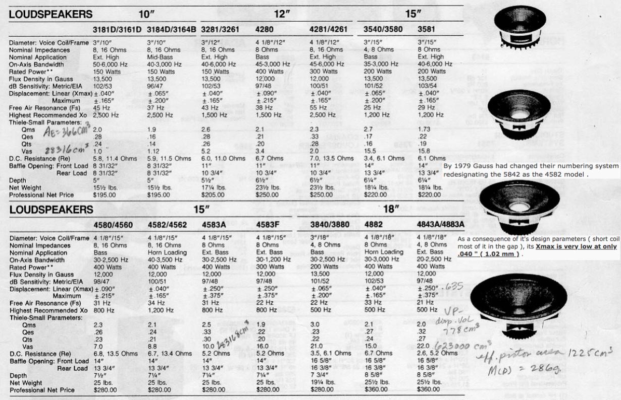

Must be something in the air, was thinking about Gauss speakers again today, used them back around 1974 through 1978. Used the 5842, which was re-designated as the 4582 in 1979. Really low Xmax, which would explain the harmonic distortion when driving them with 400 watts below Fc in a horn enclosure..
The H5831-AM specs are probably similar to one of the drivers below, possibly the 3580 or 4583F.

Seems all the Gauss loudspeakers had either 3" or 4 1/8" voice coils- going to a 5" would be a major change in tooling.
The dust cap must be at least the size of the voice coil, photos of the H5831-AM appear to be around 4 1/8".

Just pulled out the woofers. Looking at this pair I agree that they are not a 5” VC. That story I heard was incorrect. I bought my Gauss 15s, 4 Polydax 6 inch mids, and Heil tweeters from Audio Mart. Heil tweets were indeed rare to find back then. There was a 2 way version available from audio mart at that time. I don’t know if the same woofer was used to mate with the Heil. A friend of mine had his Gauss woofers re-coned with foam surrounds. They produced lower frequencies and from a much smaller box. Anyone else hear of that? I still have all the components so I guess my winter project is decided.
It is possible to recone speakers with non-standard parts to vary the TS parameters, though the Gauss 4.125" voice coils and double spiders are hard to source.
