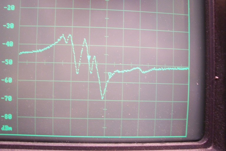

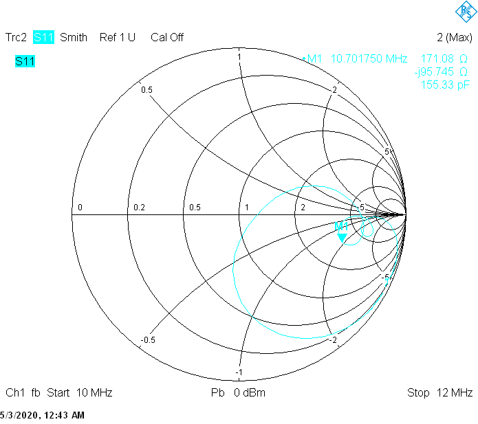

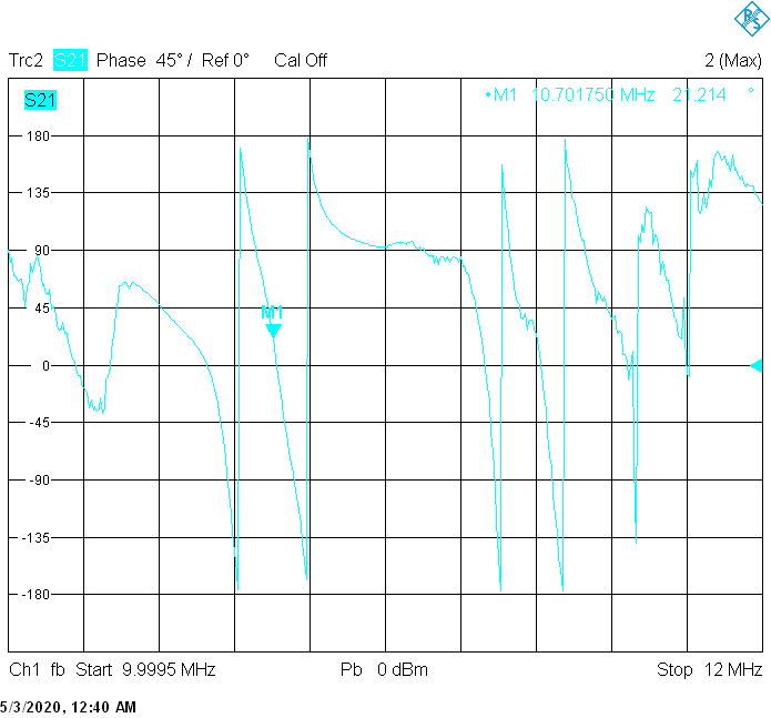

I've played some more with the ceramic filter. I narrowed the span to the more interesting range 10.7MHz+-200KHz and added more markers at +-100 KHz.
The second plot is calculated port impedance in Ohms + phase angle, calculated from s11. That does not look like a nice linear phase shift vs. frequency.
I don't get it. In post #8, there was a dip in the transfer around 10.76 MHz for configuration 3, which meant an impedance maximum. You now again get a dip at about the same frequency (slightly lower, 10.73 MHz), but as you have a parallel configuration, this time you need an impedance minimum to get a dip.
Sorry: I changed the graph parameters for the second set of screenshots (center frequency = 10.7MHz, span 1MHz), as there was nothing interesting elsewhere.
I mentioned it, but I should have made it clearer.
Taking this into account, the two sets seem broadly consistent.
There could be minor differences due to the different loading impedances.
I didn't take care about the I/O pins of the filter, but since conf. 3 & 4 are symetrical, this shouldn't matter

Yes, it looks rather disastrous. Which pins of the filter did you measure?
You are right, I didn't read your post carefully enough. Configuration 3 looks best again, although the distortion may still be too high.
