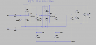

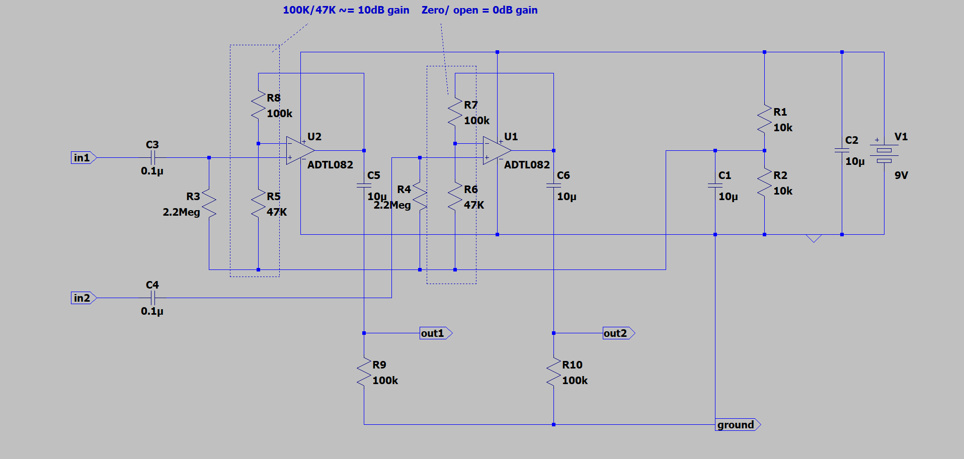

That is excellent information. All I need is a circuit diagram. Is it possible that you can provide this for me? Thanks1. If you want any bass from a ceramic cartridge, a 1meg ohm input impedance is minimal. 2.2 meg Ohms or higher is recommended. They do not require RIAA eq when used with a hi-impedance input such as was typical of very simple vacuum tube record players.
2. Instrument amplifiers like ina217 are too slow for audio and the DC precision is useless.
3. For this purpose, a FET input op-amp is the best choice, with gain minimal or none. Years ago, I had a Phillips cassette recorder where the line inputs were a 2.2Meg resistor to the (unbalanced) microphone input, and that worked well with ceramic cartridges.
Ok, so this is a high impedance buffer for two channels. I used TL082 because it's in the LTC library but TL072 is probably better choice. Note that this shows two single op-amps, but TL072/82 are a dual where both share the supply pins. I show feedback for 10dB gain but you may want to adjust that for whatever gain works with your system. Gain = 20log((R8+R5)/R5) and 20log((R7+R6)/R6). A 9V battery is probably enough but you may want two, ie 18V.

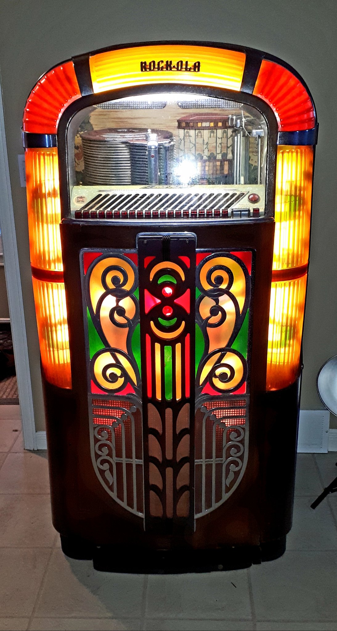

This the cartridge that is used on my 1946 Rock-ola jukebox. It plays 78 RPM shellac records and tracks at 8 grams.I would reverse the question: do you insist on this cartridge? It will sooner or later ruin your LPs. You could buy a modern MM (moving magnet) cartridge for $55. Unless it is the 78rpm version, but there are alternatives for it, too.
Steveu,Ok, so this is a high impedance buffer for two channels. I used TL082 because it's in the LTC library but TL072 is probably better choice. Note that this shows two single op-amps, but TL072/82 are a dual where both share the supply pins. I show feedback for 10dB gain but you may want to adjust that for whatever gain works with your system. Gain = 20log((R8+R5)/R5) and 20log((R7+R6)/R6). A 9V battery is probably enough but you may want two, ie 18V.

Excellent! I really appreciate your efforts on this. Would you be willing to share the LTspice asc file?

I see. My family had a Garrard record changer when I was young. It had a ceramic cartridge with sapphire stylus. There were two styli on the cantilever, and it could be turned over to play 78s.This the cartridge that is used on my 1946 Rock-ola jukebox. It plays 78 RPM shellac records and tracks at 8 grams.
