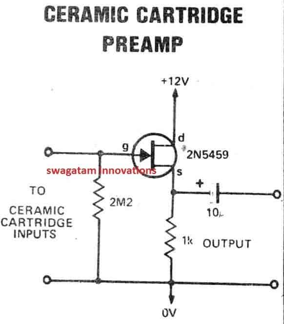

If you want to directly connect the output of the ceramic pickup to a line level input of a different amplifier (meaning not to the internal tube amplifier), I would recommend a FET source follower (3 components plus battery). The PU is mono, isn't it?

You don't know what you are taking about! Your the only one confused here and there is no mystery. Read the entire thread. A ceramic cartridge needs an input impedance in the meg ohm range or you will lose bass response. Line level inputs are in the kilo ohm range. Why I want to use a ceramic cartridge is irrelevant and frankly none of you business though I did explain it earlier in the thread. Read the entire thread before you make anymore stupid comments. So you want more specifics re what I will plug this preamp into:A generic no name amp?

Also, their output at times is enough for some amps. No need for a pre amp.
- Technics Stereo Integrated Amplifier SU-V78
- Marantz Receiver SR-6011
- 2 x 4 MiniDSP https://www.minidsp.com/products/minidspkits/2-x-in-4-x-out

Due to manufacturing differences in those amps, they all likely have DIFFERENT analog line level loadings, and sensitivities.
For instance, one might have a 22K input load, another could have 10K.
Another might have 100K.
So with that stated, unless a service manual can weed out and determine those differences, it's almost impossible to design a single adapter that works the SAME way for all of them.
Aim for 150mV output level buffer amp and hope for the best.

Then it's equally impossible to design a tuner or a CD player that works with all of them.
- Analogue Source
- Ceramic cartridge to line level input circuit
