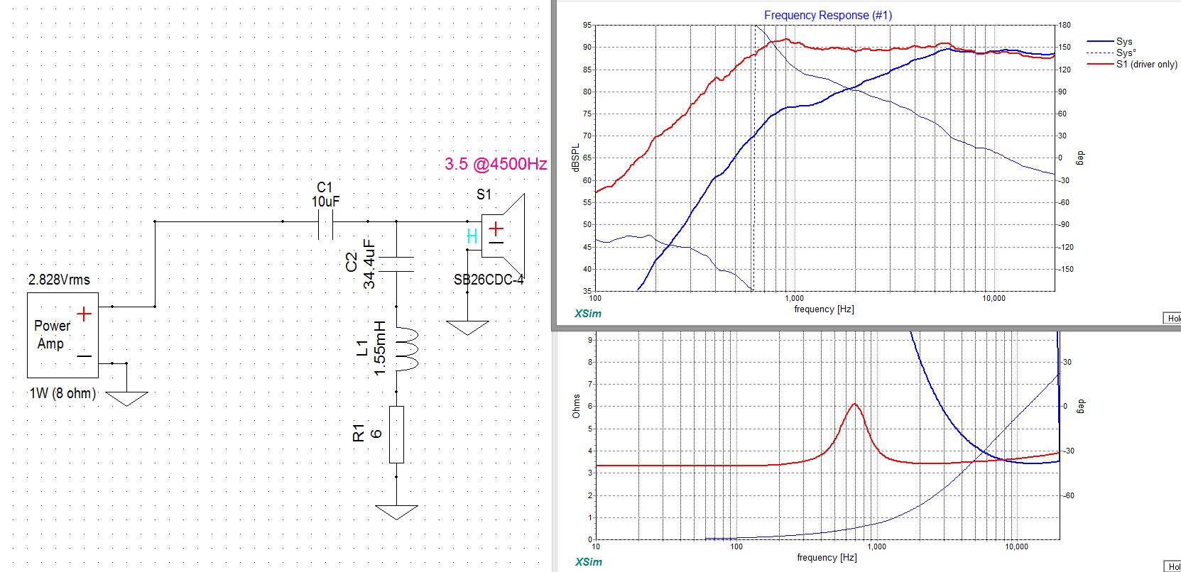

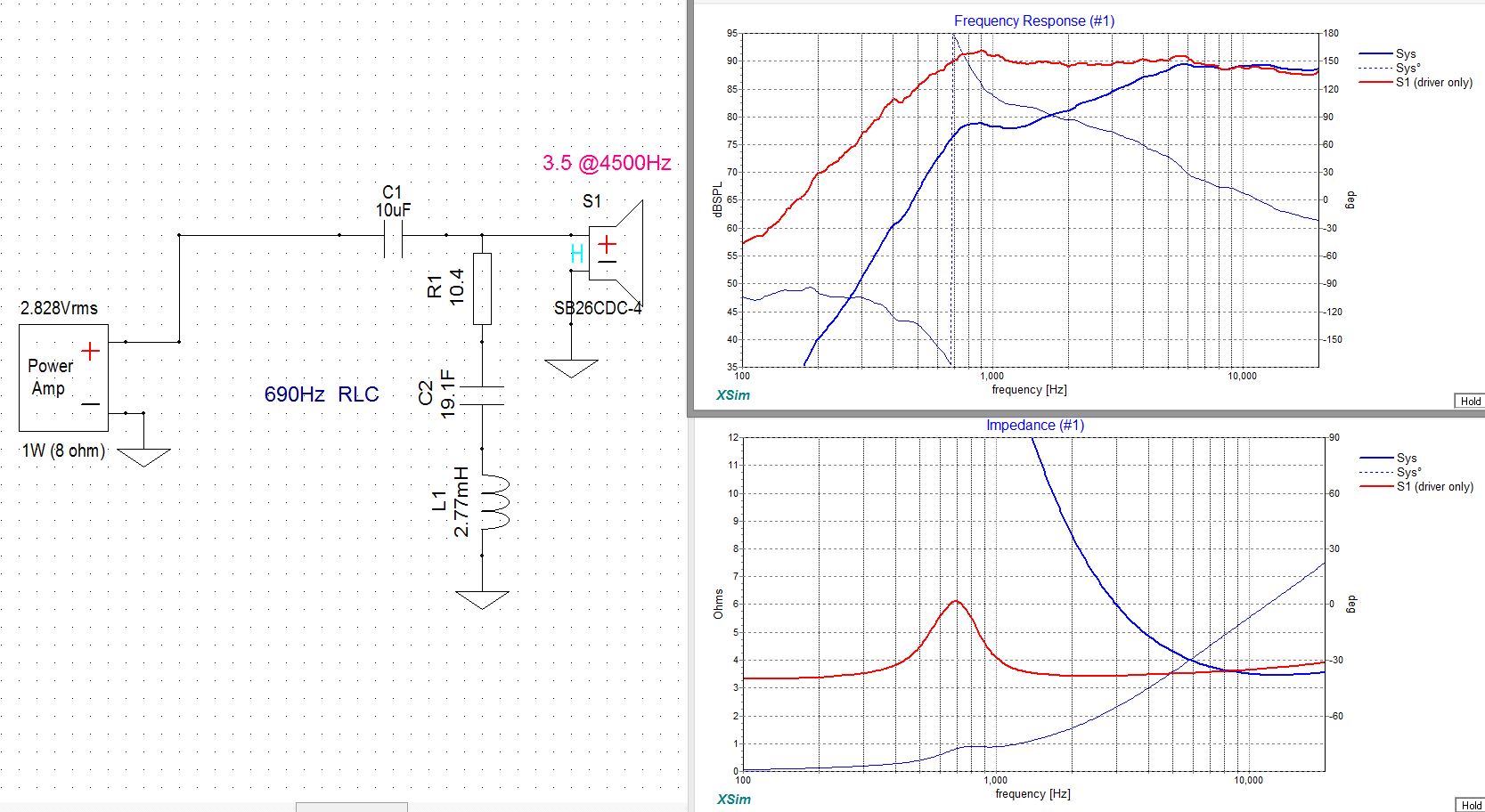

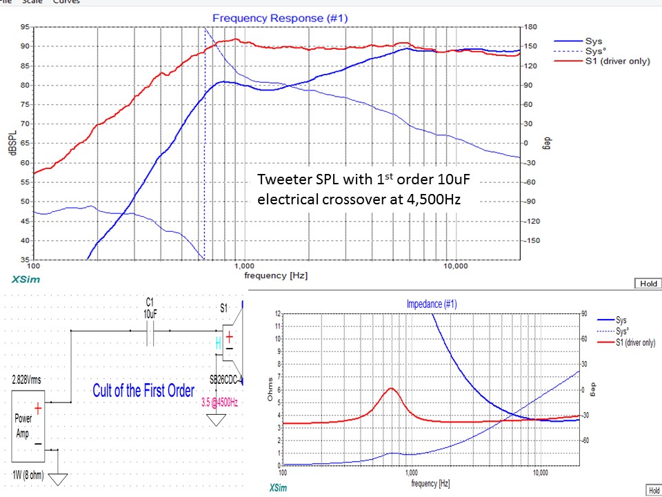

Attached sim of just the SB26CDC-4 dome tweeter on a pyramid baffle with a 1st order 4,500Hz crossover = 10uF capacitor.
If you add a 12db RLC filter at the 690Hz resonance, it has very little effect on the tweeters natural acoustic roll-off, which will combine with the midrange SPL.

Following the Cult of the First Order Rules

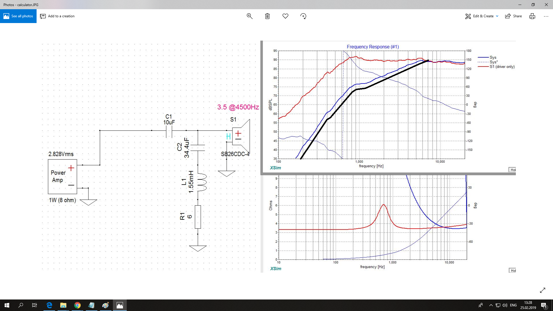

Your LCR values are not what I was modelling. How did you end up with them? I used this *tested* method and am expecting similair result as per this thread:
Series Notch Filter Designer / Calculator Help
I don't have access to such software yet,
can you model the sb26cdc-4 tweeter with my values in the LCR?
series notch filter
C = 34.44 uF
Inductor
L = 1.55 mH
Resistor
Rc = 5.977450980392158 Ohms
I really need to clear this one up, because this was supposed to work better I suppose.
I managed to get Xsim going! where did you get the zma and frd files for the sb26cdc?
series notch filter
C = 34.44 uF
Inductor
L = 1.55 mH
Resistor
attached....
Note the different slopes.
Note notch filters shift phase.
The Cult of the First Order only allows one series C or L (plus resistor) for each driver.

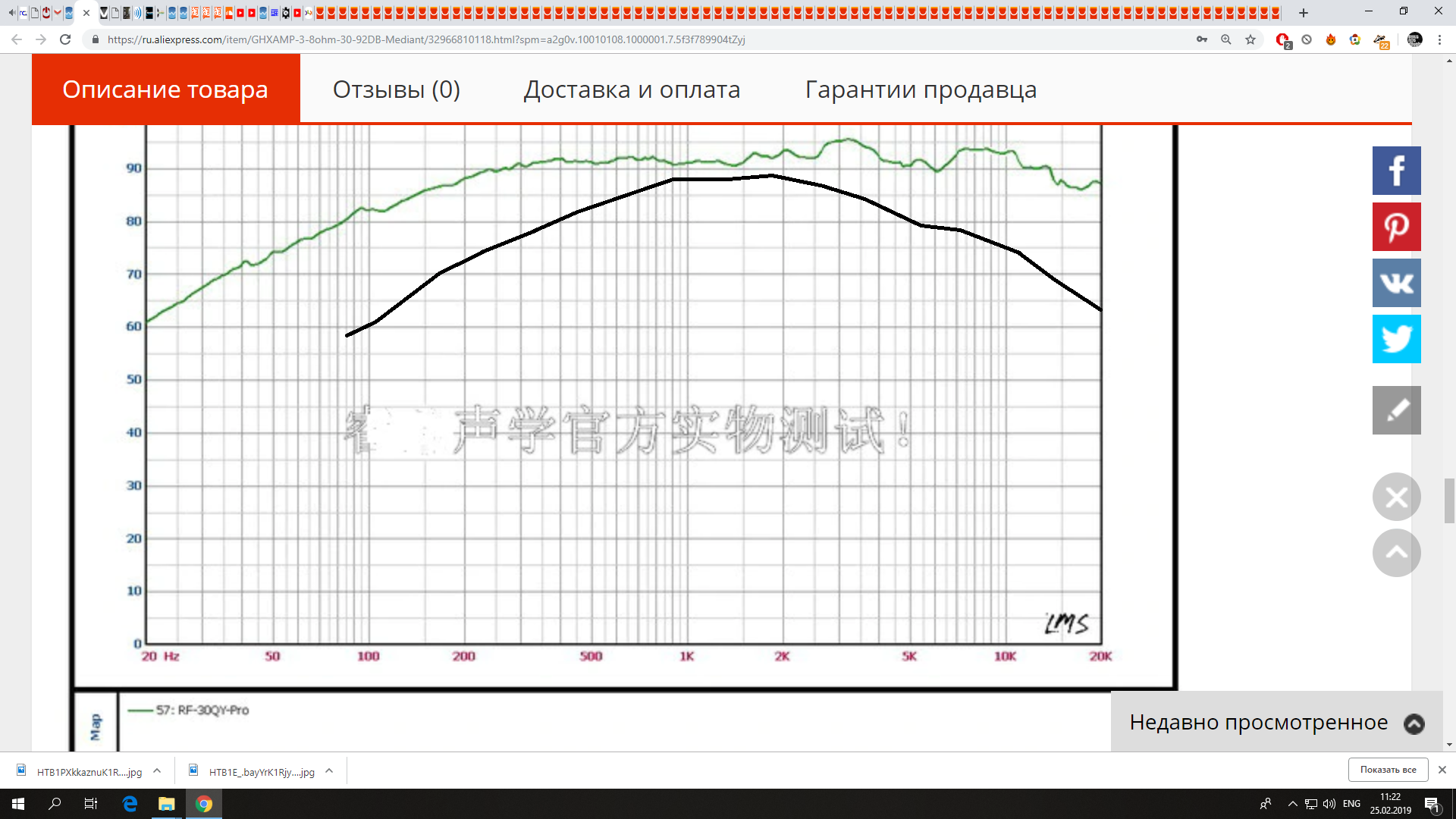

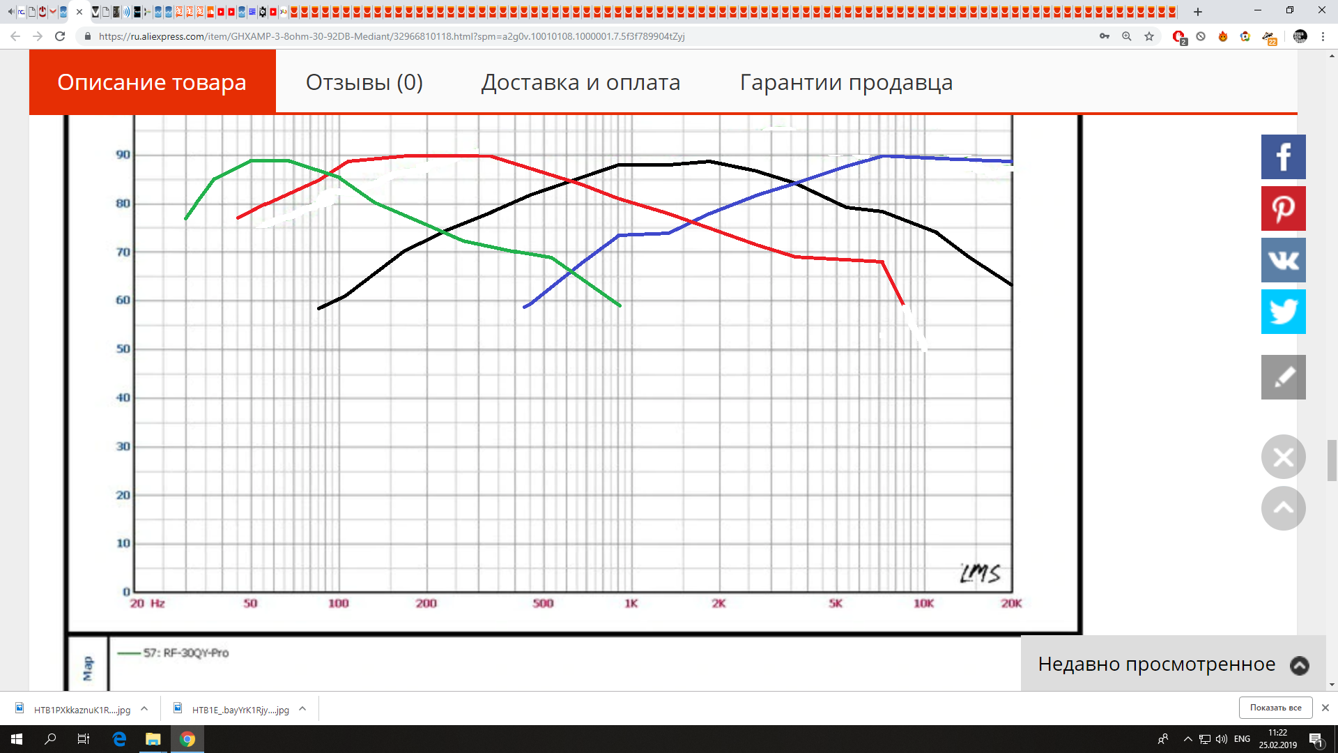

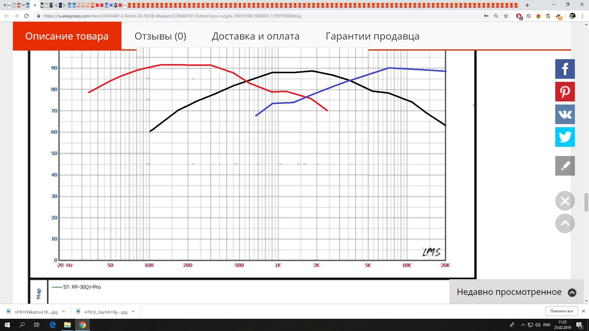

PROGRESS!!
The weekend was productive Fellaz! I have revamped the system, I will make a post here with all the info and I will EDIT the main post after, to be able to link the models.
I have mapped all the drivers seperately, and then have combined them into a TRUE 1st order electrical 4-way response graph.
The reasons behind this is that I realised the crossover points between the drivers must be -6db to have a flat response, therefore I have made assymetric crossovers to make sure Im as flat as possible.
The tweeter is already modelled with the series LCR notch in parrallel to the driver, but I havent added the effect of the Zobel impedence equalization networks which are in parallel to the cone drivers.
Thier job is to make sure that the higher frequency zones after the low-pass points to the cone drivers are rolling off at least as intended, if not quicker (meaning 9/db octave instead of 6db/octave). This will even out the bumped kinks you see on the red midwoofer graph, and the black midrange graph past thier low pass points.

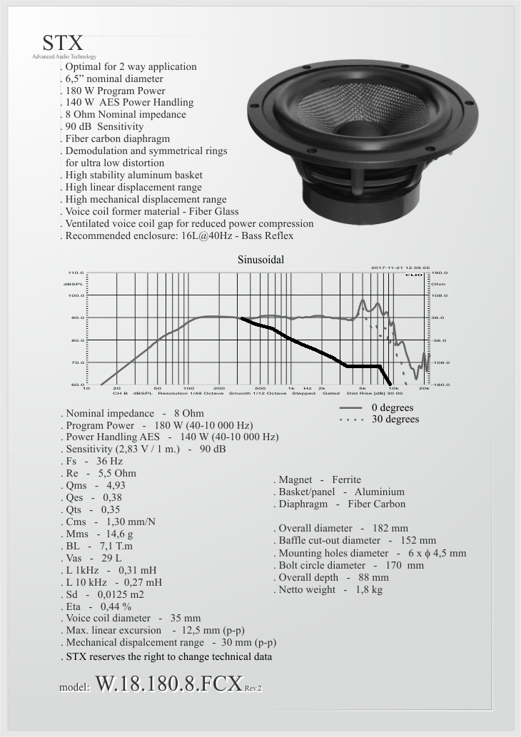

3). 6" MIDWOOFER
44$ STX 180.8 FCX v2 6.2OHM
1st order low pass CROSSOVER VALUES: (337hz -0db, 450hz -3db, -675hz -6db)
L1 = 2.19 mH
16$ Z52-2,2/1,5 TOROIDAL IRON POWDER INDUCTOR 0,11 ohm (WILL USE 2.2mH)
INDEPENDENCE EQUALIZATION ZOBEL CIRCUIT:
C = 4.05 uF
Rc = 8.75 Ohms

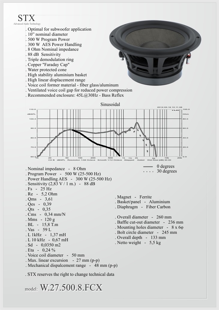

4). 10" WOOFER
82$ STX W.27.500.8 FCX 5.9OHM
1st order low pass CROSSOVER VALUES: (66hz -0db, 100hz -3db, -133hz -6db)
L1 = 9.39 mH
20$ Z52-9,1/1,5 TOROIDAL IRON POWDER INDUCTOR 0,22 ohm (WILL USE 9.1mH)
C = 25.19 uF
Rc = 7.38 Ohms
(NOTE: the midrange GREEN plot is for 4 ohm unit, I've subtracted 2.75db)

FULL SYSTEM ACOUSTIC RESPONSE TO ELECTRICAL FIRST ORDER (ZOBELS NOT MODELLED).png503.5 KB · Views: 784

RF-30QY-PRO-8-OHM-1st-ORDER--3db(675hz)--3db(2700hz).png734.9 KB · Views: 246

HERE IS THE PLOT FOR THE 1ST ORDER ELECTRICAL 3 WAY
SB20PFC30-4 + RF30-QY-PRO-8 + SB26CDC-4
All three drivers playing the most critical 900-1300hz zone FLAT (AN IN TUNE WITH SYSTEM SENSITIVITY). Daddy Troels G would be proud.
FINALLY IM GETTING RETURNS on my investment of time!!
Here are the crossovers:
TWEETER:
C1 = 8.66 uF + BYPASS
SERIES NOTCH PARALLEL TO TW:
C2 = 33.93 uF
L = 1.57 mH (~0.375 OHM)
R = 5.69 Ohms
MIDRANGE:
C1 = 33.65 uF + BYPASS
L1 = 0.44 mH
MIDWOOFER:
L1 = 1.63 mH
For those of you who cant get KZK WHITELINE / K78-34 capacitors, I would do JANTZEN ALUMEN-Z or SUPERIOR-Z on the tweeter, CLARITY CSA or MUNDORF EVO OIL everywhere else (ZOBELS INCLUDED). For midrange inductors, JANTZEN FOIL-WAX, MUNDORF FOIL OR GOERTZ FOIL. For Midwoofer inductor, 14-15AWG aircore will fit the bill.
ZOBEL IMPEDANCE EQUALISATION RECOMMENDED
FOR MIDRANGE:C = 11.8 uF, Rc = 9.25 Ohms
FOR MIDWOOFER:C = 20.57 uF, Rc = 5.88 Ohms
