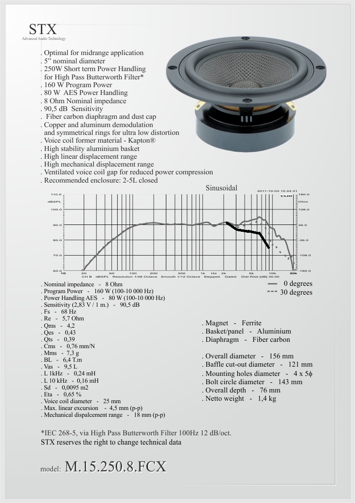

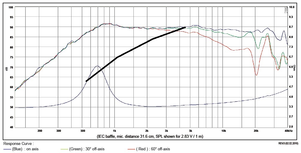

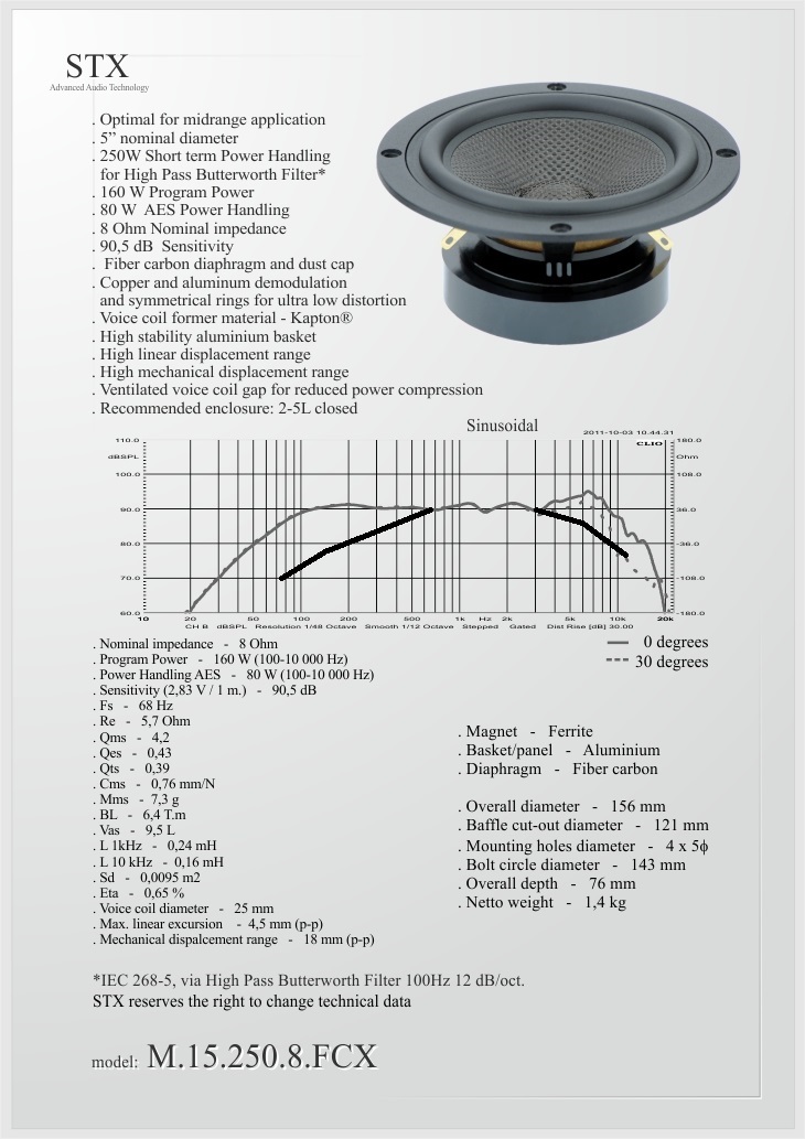

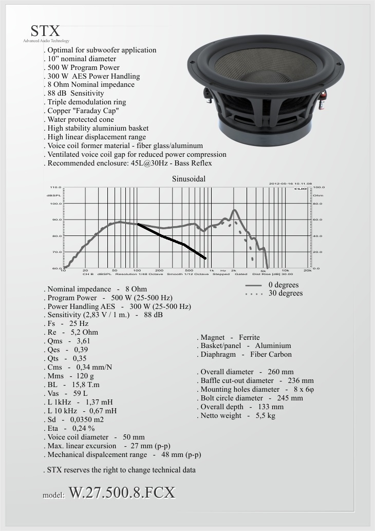

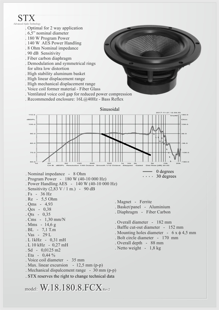

I have posted the theoritical graphs before I make real measurements. I will update the ORIGINAL POST because things have gotten messy. My apologies for this!
Please note that the Tweeter has a series LCR circuit in parrallel to the driver. This eliminated the effect of independence rise @ resonant frequency, making a steeper slope, and allowing better power handling. I was still adviced to add a fuse to the tweeters. Will this negatively impact the sound of the tweeter?

M.15.250.8.FCX. intended 1st order electrical slope.jpg189.5 KB · Views: 203
20W.18.180.8.FCXrev2 1st order electrical intended slope.jpg179.6 KB · Views: 188

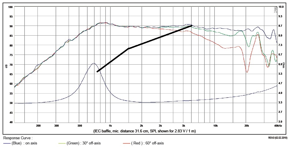

I have made my last post just minutes ago, and by looking at the post above, Im thinking it will be better to lower the -3db symmetrical crossover point between the midrange and tweeter down to 3375hz from 4500hz. Pretty Sure I wont compromise the tweeter this way, all while reducing the effect of breakup (which is visual btw on the graph) and beaming of the rather beefy 95cm2 midrange driver.
Yes Yes Correct?
Yes Yes Correct?
Like this:

It's great to see some factory frequency responses with your targets, but if you place the drivers on a non-infinite baffle, you get completely different curves.
^^ Yes thanks, this is given for any system, any drivers, so it doesn't and shouldn't change the world.
A). Exactly for this reason I have closely matched the sensitivities, so the baffle loss/gains wouldn't multiply/scale the diffirences as much.
B). I wont make the crossovers until I measure the Drivers installed in MY baffles. These calculations are simply theoritical targets for now, with small deviations possible to align baffle loss / gain, as well as assymetrical crossover points.
I agree it MIGHT NOT be a flat frequency response, not even 0.5db, or 1db close. Im prepared already for that. It will colorate and accent SOME narrow frequency ranges, but:
I will still get away with great sound, even if slightly mismatched spl.
I will still get away with the purest passive audio circuit
It will sound amazing because I will use Hi-end parts to assemble those purest passive circuits, like KZK whiteline caps, and Jantzen WAX-FOIL inductors for voicing and Toroidal for the woofers.
And I still have headroom to use L-pads, if you know what I mean.
