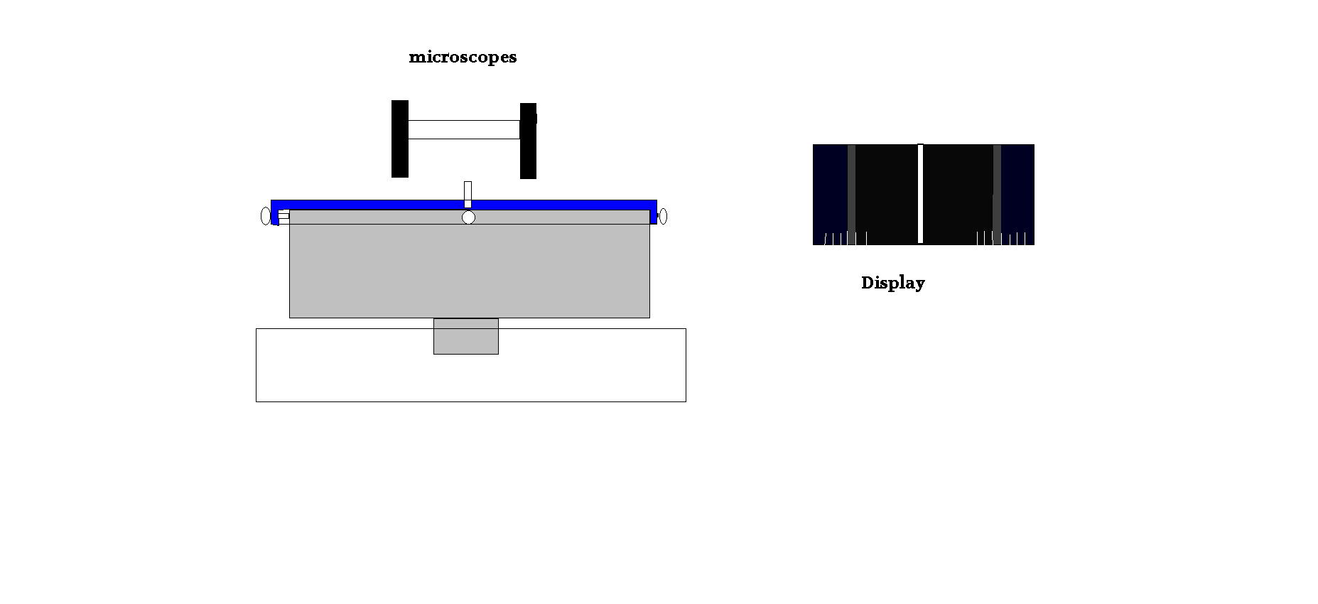

What about using USB microscopes placed above the player to help with the positioning of the record.
@Mark Witney,
It can be done, but probably is is not easy to do (I have an USB microscoop).
A laserpen is very cheap (about 15 euro), that's why I preferred the solution.
The advantage of using microscopes is that you can adjust the position of the record without it rotating. Add a method of adjustment at the OD of the record and remove the centre pin. No need to drill holes in the records.
