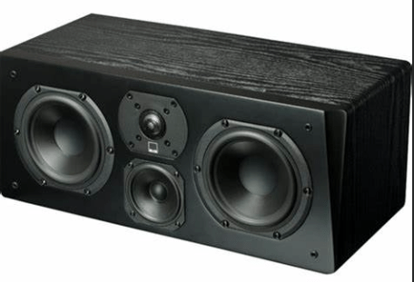

Hello all, I need some help determining a design for a center speaker for movie and tv use. I currently have the Polk s35 as a center which I think is a WMMTMMW array, the bass presence is non existence, voices are difficult to hear, and I'm not to happy with its dispersion.
My L and R are the Polk es50. I understand for 5.1 all the speakers should be the same, financial constraints and space prevent me from buying another es50.
The amp used is a Yamaha v477 set at 8 ohms
Room size is large and open
My main goals are:
  • Create a center that has a better overall presences than the s35
  • Increase dispersion
  • limit spending
I'm not trying to make the perfect center and I'm approaching this project as more of a prototype and learning experience (I have only built one pair of speakers before). The advice I'm seeking is general guidance. I have searched on this forum and on google for the best format for a center and I have come to conclude that it is a 3 way center (WMTMW) but I could be wrong and If I should match it to the mains, it should be a 2.5 design (M/W T M/W).
I have:
  • two 4 ohm 8 inch woofers,
  • two 4 ohm 5 inch mids
  • two 6 ohm tweeters.
  • an inexpensive 3 way crossover
  • Access to woodworking materials and tools
I was planning on wiring the woofers in series to equal 8 ohms, the mids in series to equal 8 ohms, but I don't know if the 6 ohm tweeters can be used. I'm willing to purchase two 4ohm tweeters or one 8ohm if it works with the design,
Thank you for your time,
Please don't spend too much of your time, again I'm only looking for guidance, I don't have the means to measure my design or anything like that yet.

Sideways MTMs do not work, this one is going to be a disaster.
The XO would need to be specific to the drivers used. And if you use them only 1 mid + 1 tweeter.
A centre channel does not really need much below 80 Hz.
dave

First….matching front and center is a myth…..always has been….
Second…..as Dave pointed out, speakers in a horizontal configuration are worst case…..dispersion is narrowed dramatically and the more drivers, the worse the effect due to interactions from each drivers wavefront….known as comb filtering
……there’s no surprise your center channel sounds aweful
Easy and inexpensive solution….no build required…..a single KEF Q150 coax speaker on its side. The driver is round and centered so this really doesn’t matter….it will just help to fit under your screen as it’s smaller across than it is tall.
Done, problem solved and you won’t be able to build something for less that will outperform this solution.
If you use a subwoofer, the KEF Q150 comes with a foam port plug…..plug it up and cross to your sub at 80hz or so.
Enjoy!

As others have said, from a function standpoint, using one tweeter above one 5 inch mid is a good approach for that element if you want to use the drivers you have. If you want to add 8 inch woofers to the outside of the central group, you can likely get away with that with a low enough cross point. Unfortunately, the crossover you have isn't really suitable for that.

have fun!....without either accurate response graphs to model or measuring equipment, the likely hood of success is around the same as a scratch off lottery ticket.
Not looking to discourage or disparage.....complete transparency.......
