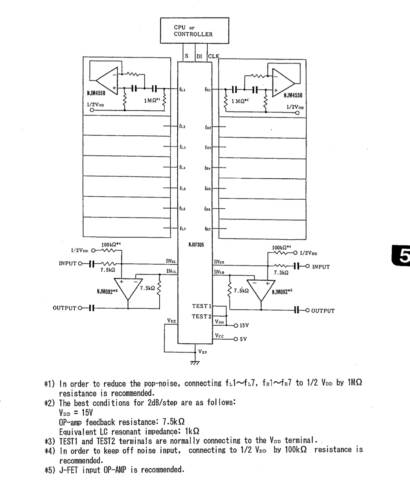

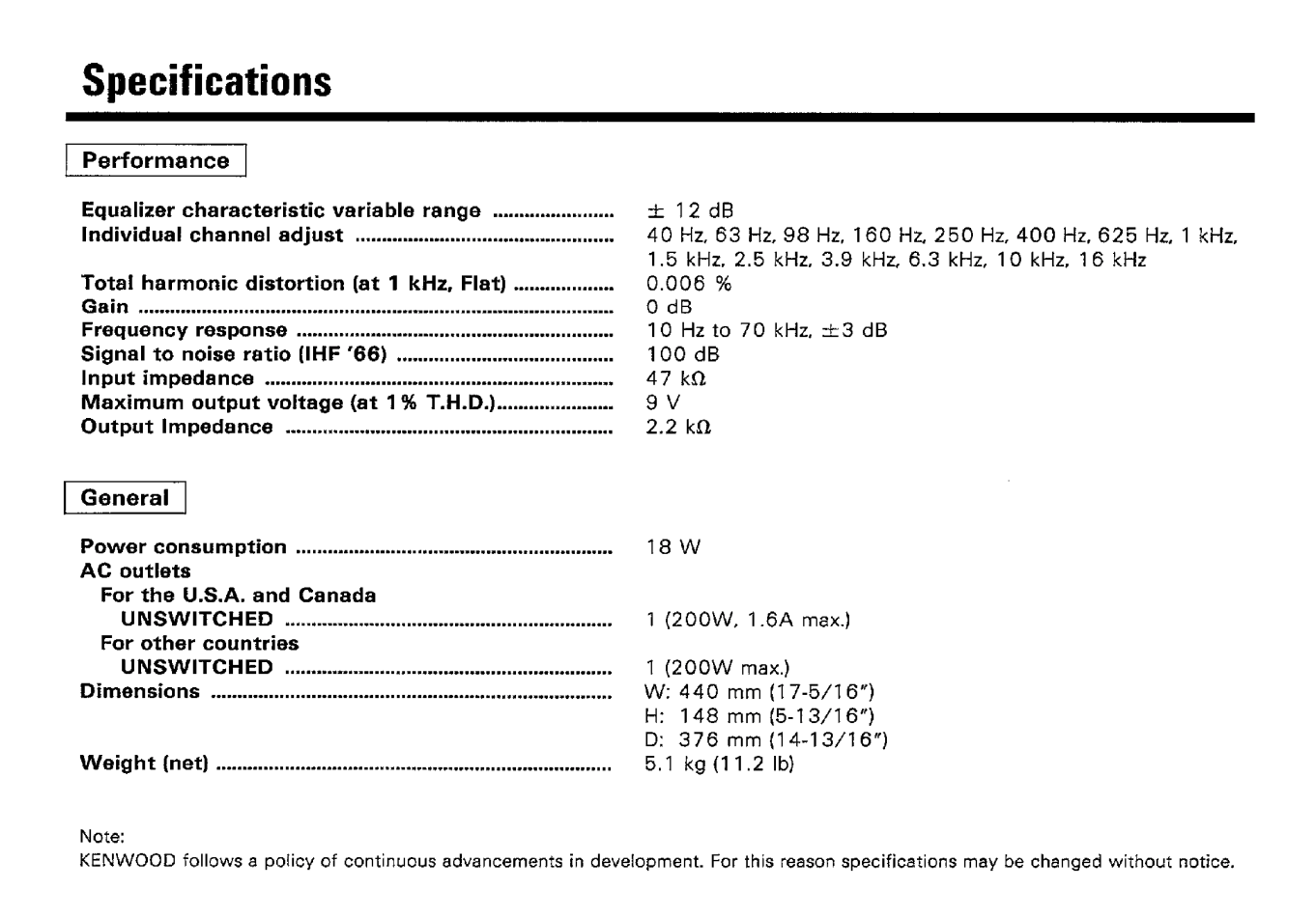

For those who were looking into doing this with less op amps and digital control, this combo of chips seems to be still available in limited quantities and support a series RLC eq, specify low noise, but not sure if that's exactly the same topology being discussed here.
Kenwood used this combo in their GE-7030 and claim .005% distortion. (they 2 mitsubishi equalizer chips and 1 NJR electronic variable resistor chip on each channel for a 14 band per channel programmability, like the below example showing the left channel eq/amp with a JRC4558 op amp buffer. I calculated the kenwood nominal vs. circuit values for frequency and Q using the formula in the data sheet below and they are close and all have a Q of ~ 10 vs. the reference design which shows capacitors selected (C1 and C2) to give Q's of approximately 2.2, so the coonstant Q in addition to the frequency, is adjustable by selecting appropriate cap values.
New Japan radio co NJU7305
14 channel variable resistor (looks like 2db steps +/- 12db)
Design doc recommends jfet input op amps
takes 8 bit data string to program the EVRs
Look like reasonably low noise, but I'm not well versed in these things. Data sheets attached.

Kenwood values vs. nominal... You can see that a few are off
Are probably best of loading up a suitable EQ App on their digital source. I actually figured out a way to make a Pro-Audio Digital EQ behave pretty much like the Palette back in the 90's or very early 00's.
The IC's you propose are decidedly low end performance, next to a 5532 and not suited for a Palette type EQ at all.
The biggest issue I see here is that too many look at some form of technical solutions without understanding what the "Palette" is, how it differs from any other EQ and why.

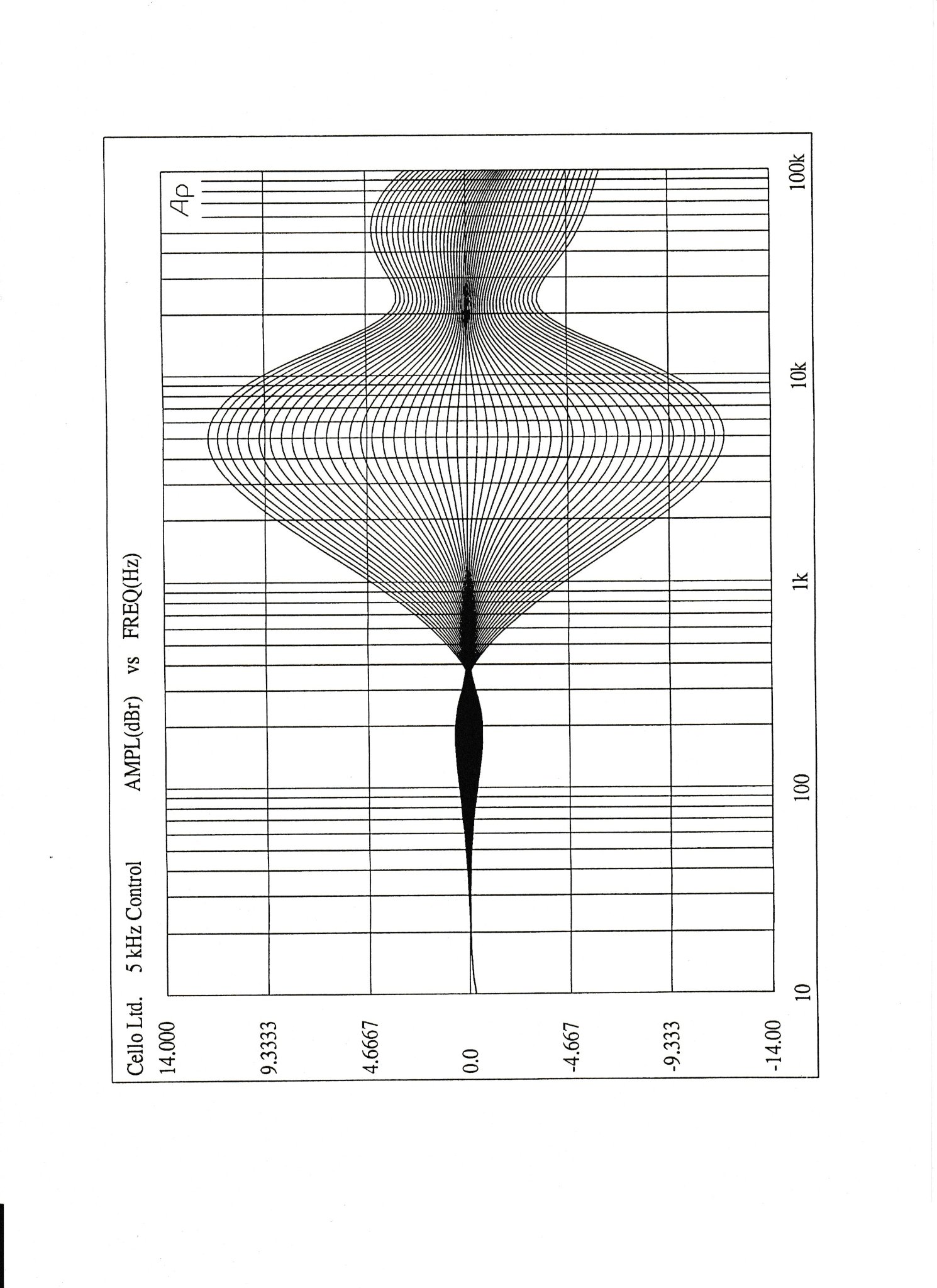

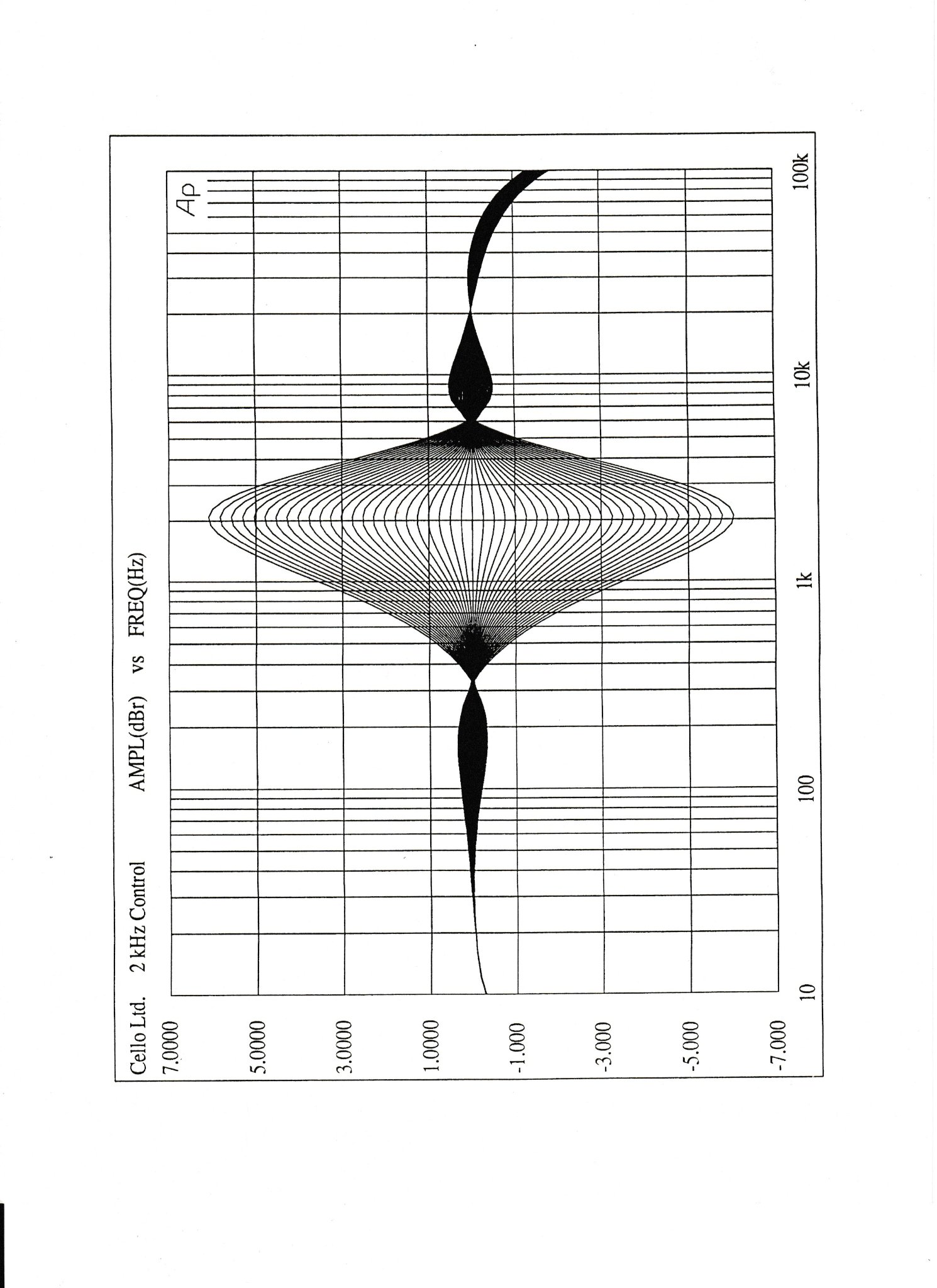

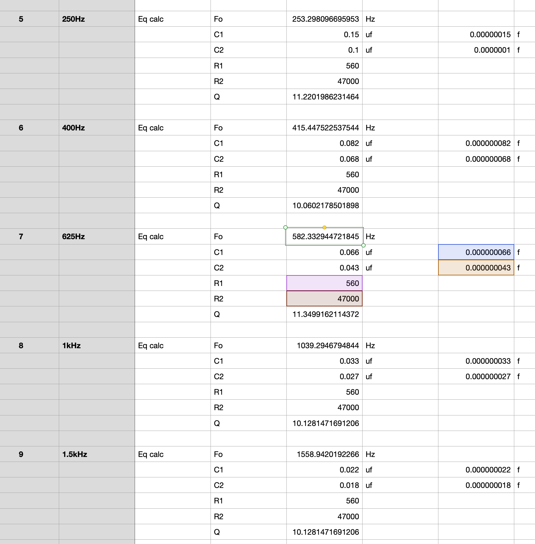

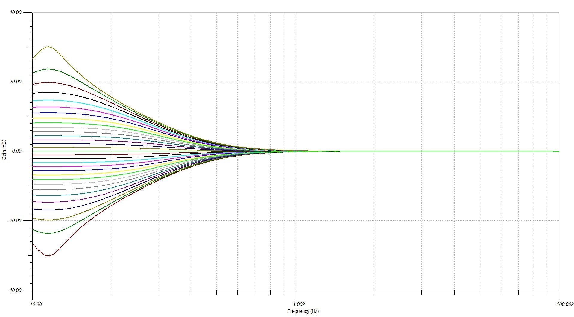

That was excellent! Any chance of any more families of curves?let's try this - 4 of 6
Craig
OK Craig,
Here are the last two.

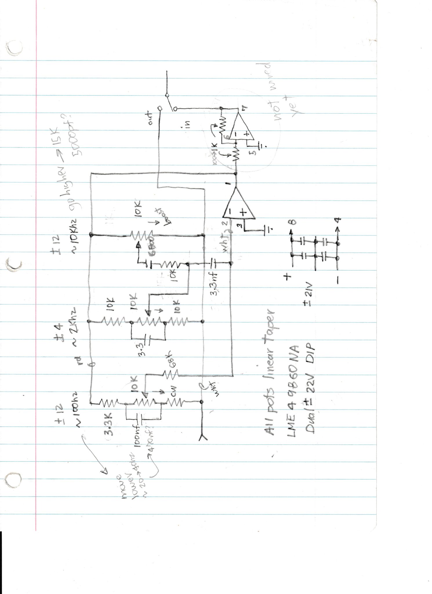

PLUS, During my time farting around with the Palette's, I happened upon some parts and was able to build up my own version of the Levinson LNP-2. That is the one piece of "Hi Fi" equipment that I would LOVE to own, BUT prices have always and will continue to be deservedly insane. The -2 includes a 3-band equalizer that I simplified down to it's bare essentials. NOT my design. It does the trick very nicely however and turns out to include the three frequencies I absolutely use the most with other more elaborate designs/units.

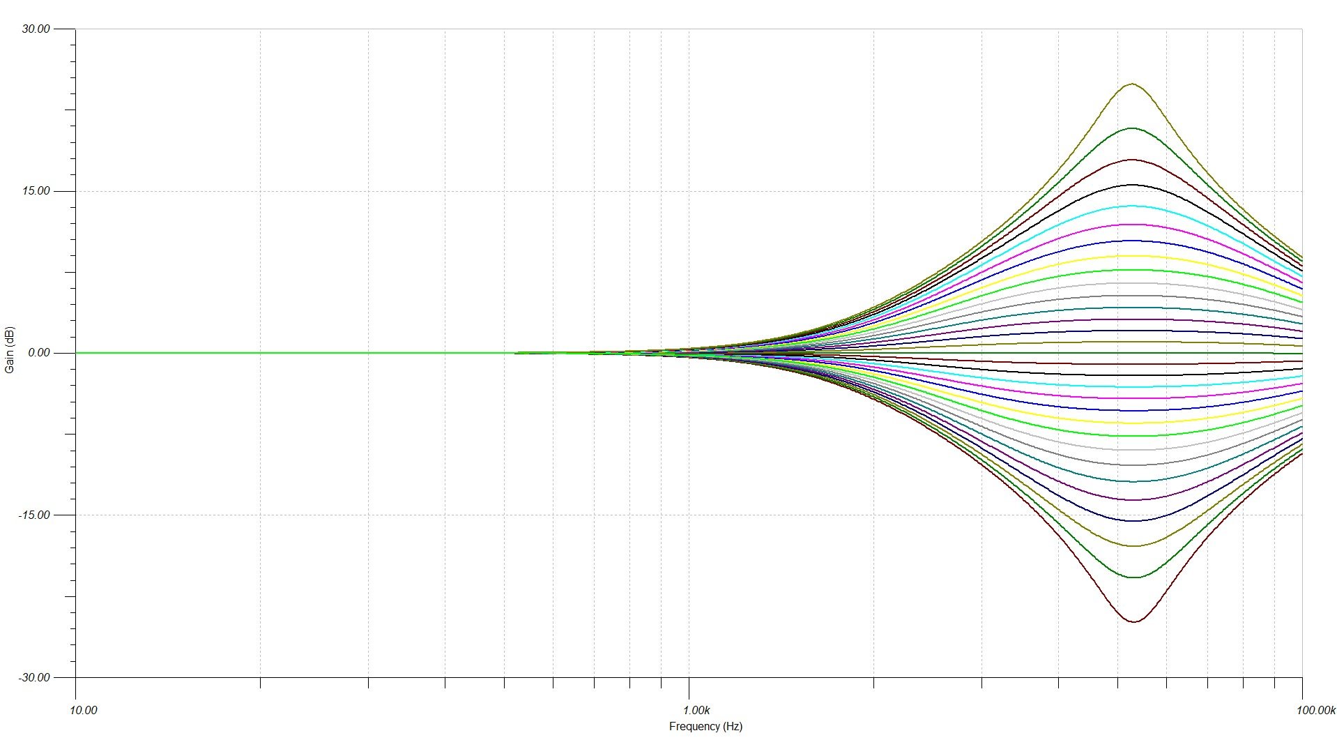

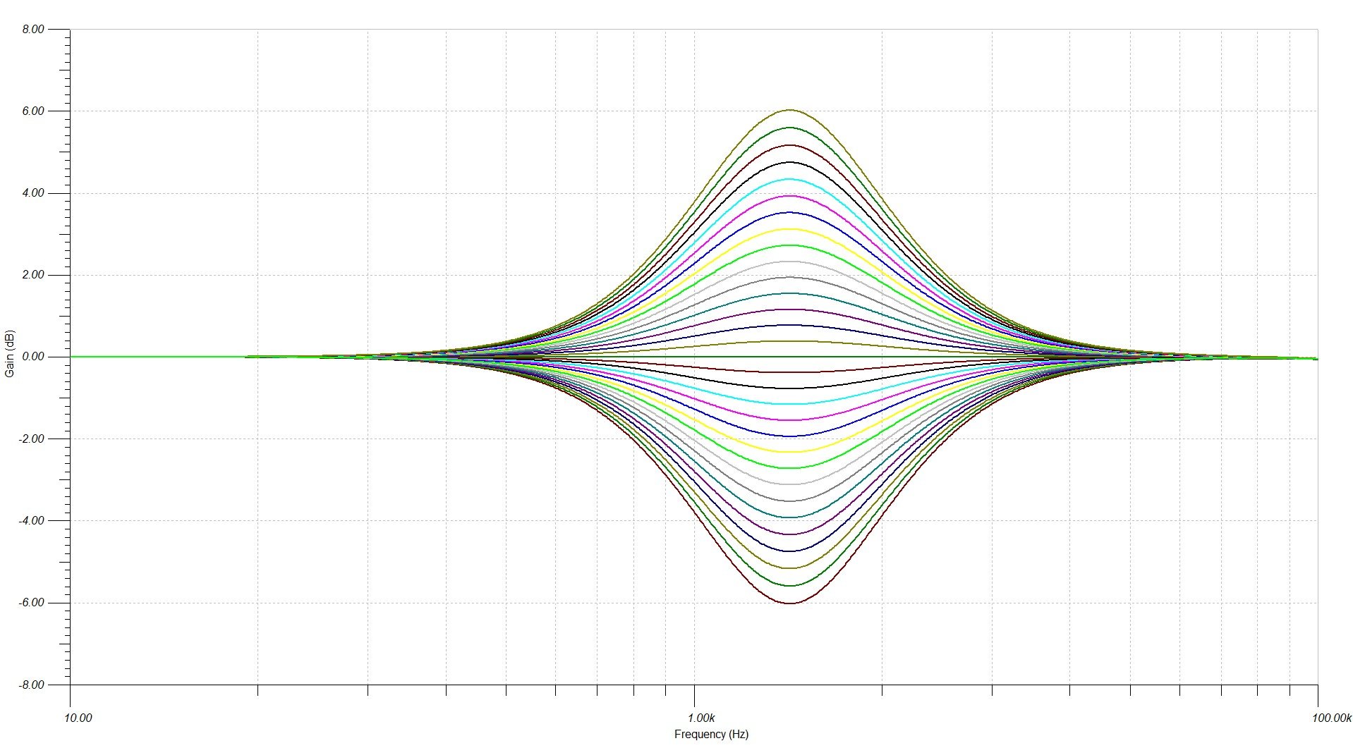

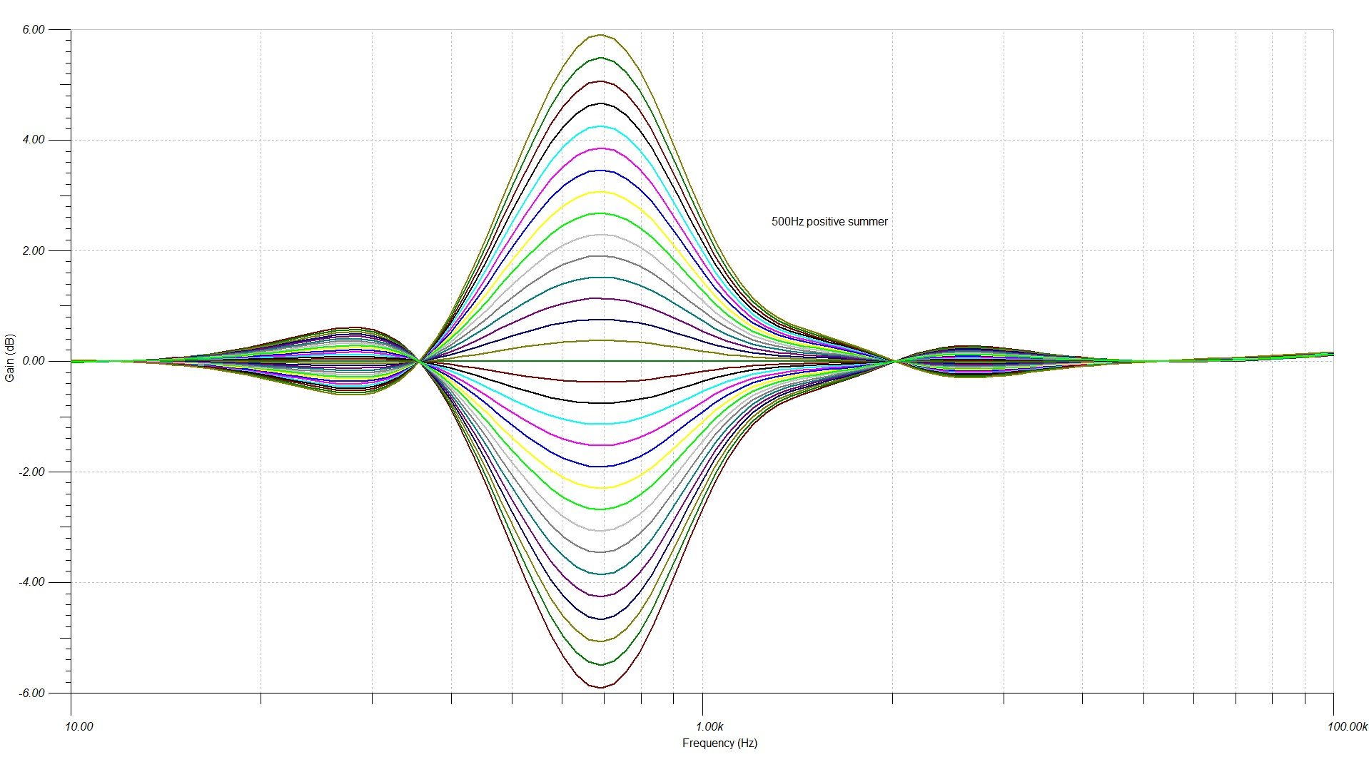

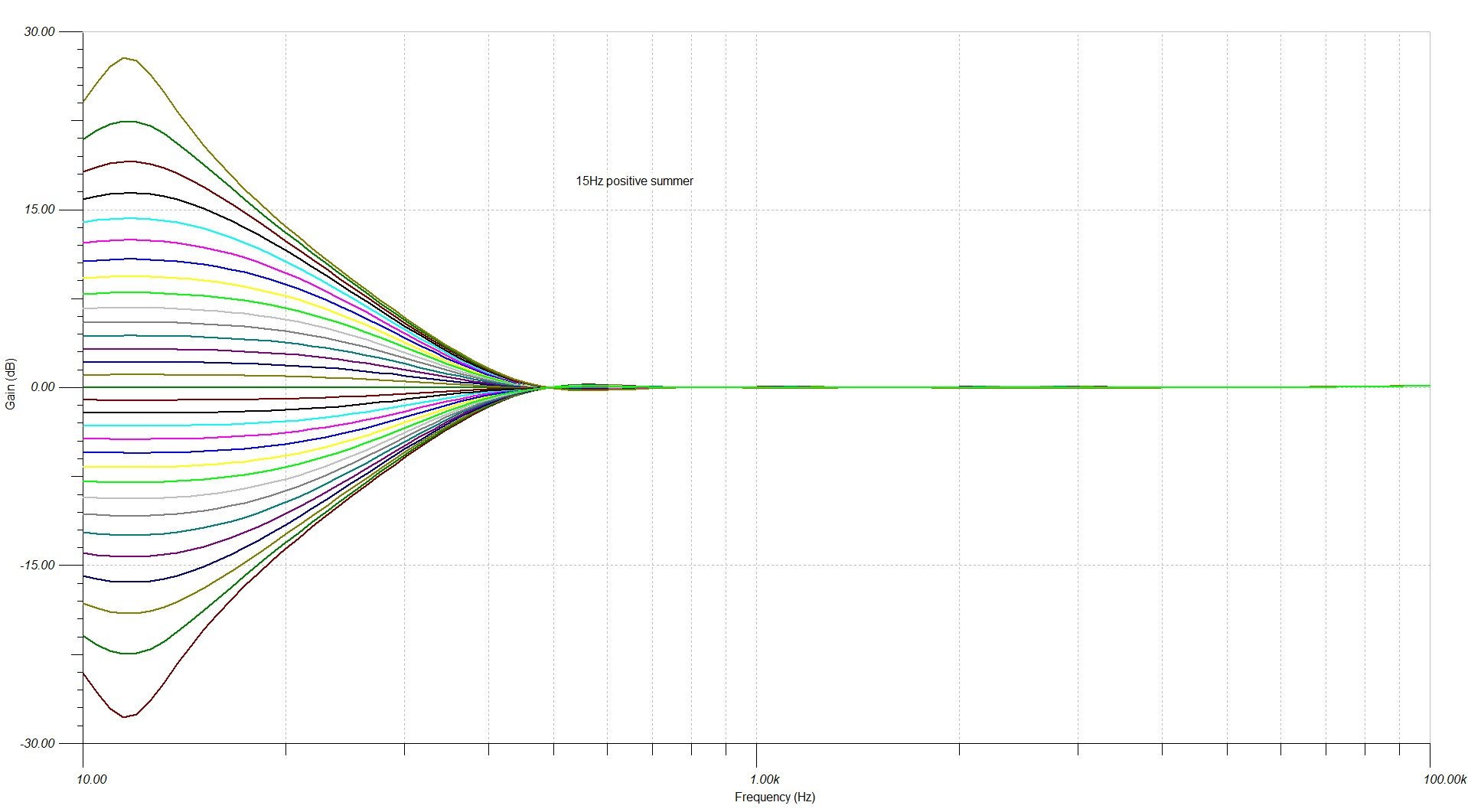

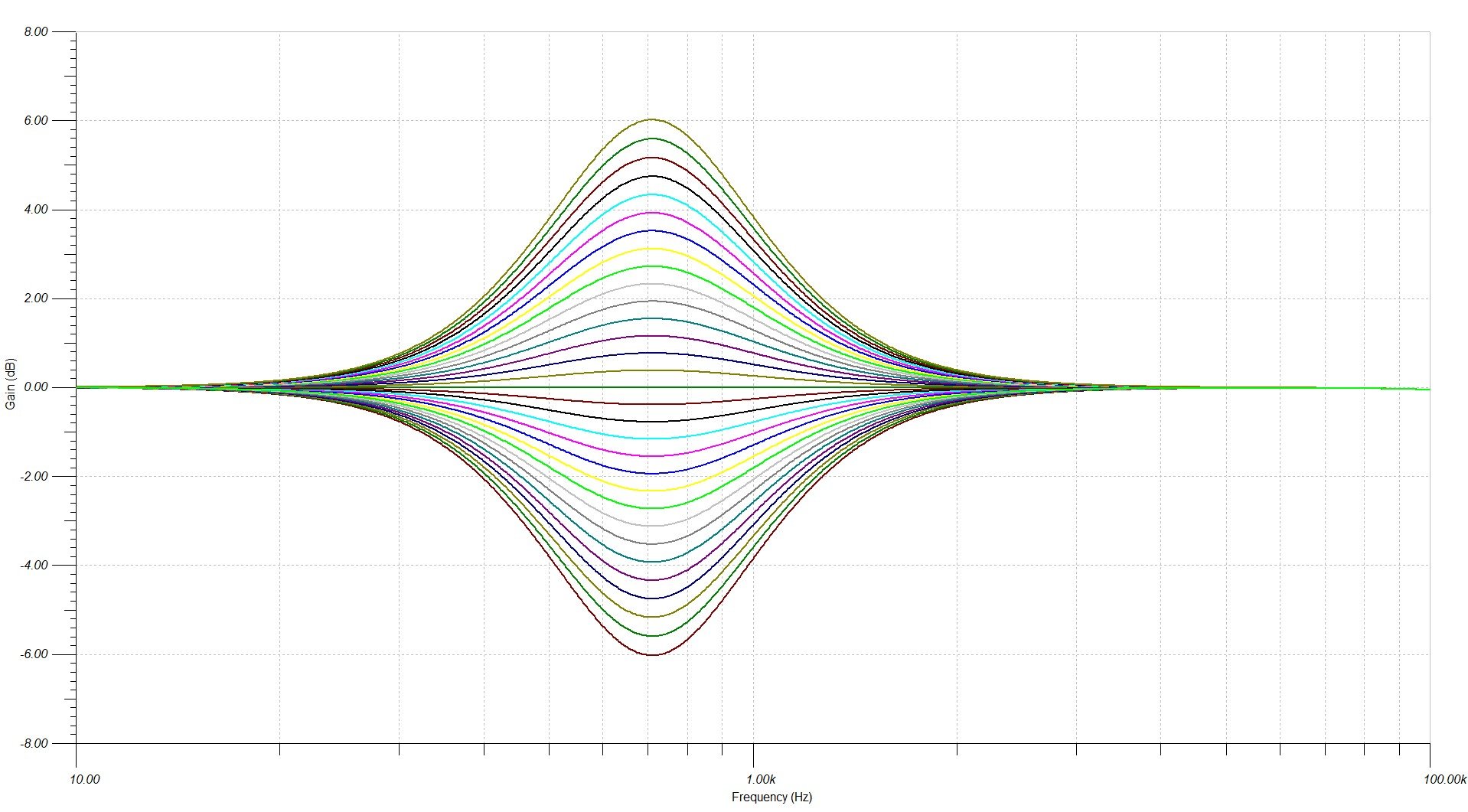

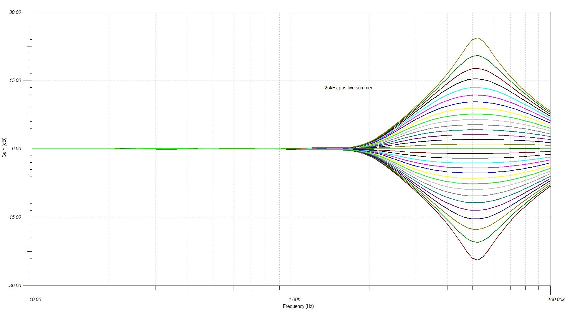

The detail in the original Cello frequency plots was fascinating.

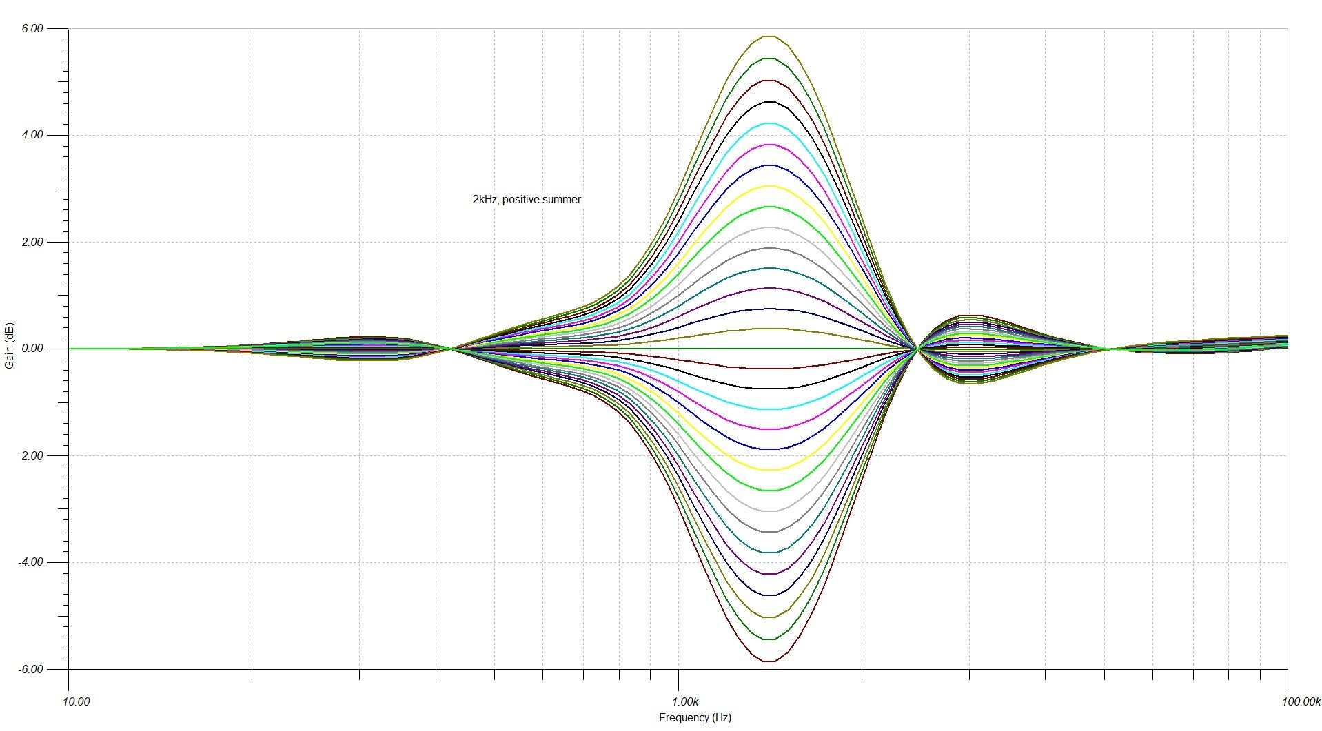

So I put the four band Burwen version, on which the Audio Palette was based, into spice. These show exactly the same detail as the Cello ones.
The interesting thing is that the drive method into the positive summing node is totally different between the Burwen and Colangelo/Jason implementation. The Burwen drives the summer from opamps, so they are being driven by a voltage source. Whereas the Cello version is being driven by a current source (from a discrete transconductance amp, OTA-1)). But the net effect in terms of the filter shape, and out-of-band artefacts is the same whether it is driven by a voltage or a current source.

However, as previously noted up this page, there is a noise penalty to a negative summer. For comparison, here is the output noise and SNR of three different opamps in the inverting and non-inverting summers. Spice of course. and noise calculated on a 20Hz to 20kHz bandwidth.
NE5532A. Positive summer, 3.4uV, 109dB (Burwen's choice of opamp)
NE5534A. Negative summer, 10.1uV, 100dB
OPA827. Positive summer, 2.5uV, 112dB (JFET)
OPA827. Negative summer. 6.7uV, 104dB
OPA1612. Positive summer, 1.7uV, 115dB (current generation of low noise bipolar)
OPA1612. Negative summer, 4.4uV, 107dB
The difference between the two is not small - typically 8-9dB. Sure you get smooth curves which is nice. But the noise penalty is significant
Using the 1.1nV/rootHz OPA1612 gives spectacular low noise in the positive 4-band Burwen. 115dB SNR is very quiet indeed.
That seems to be the reason that Burwen and then Cello's version chose the positive summer, and just accepted the non-ideal filter shapes.
