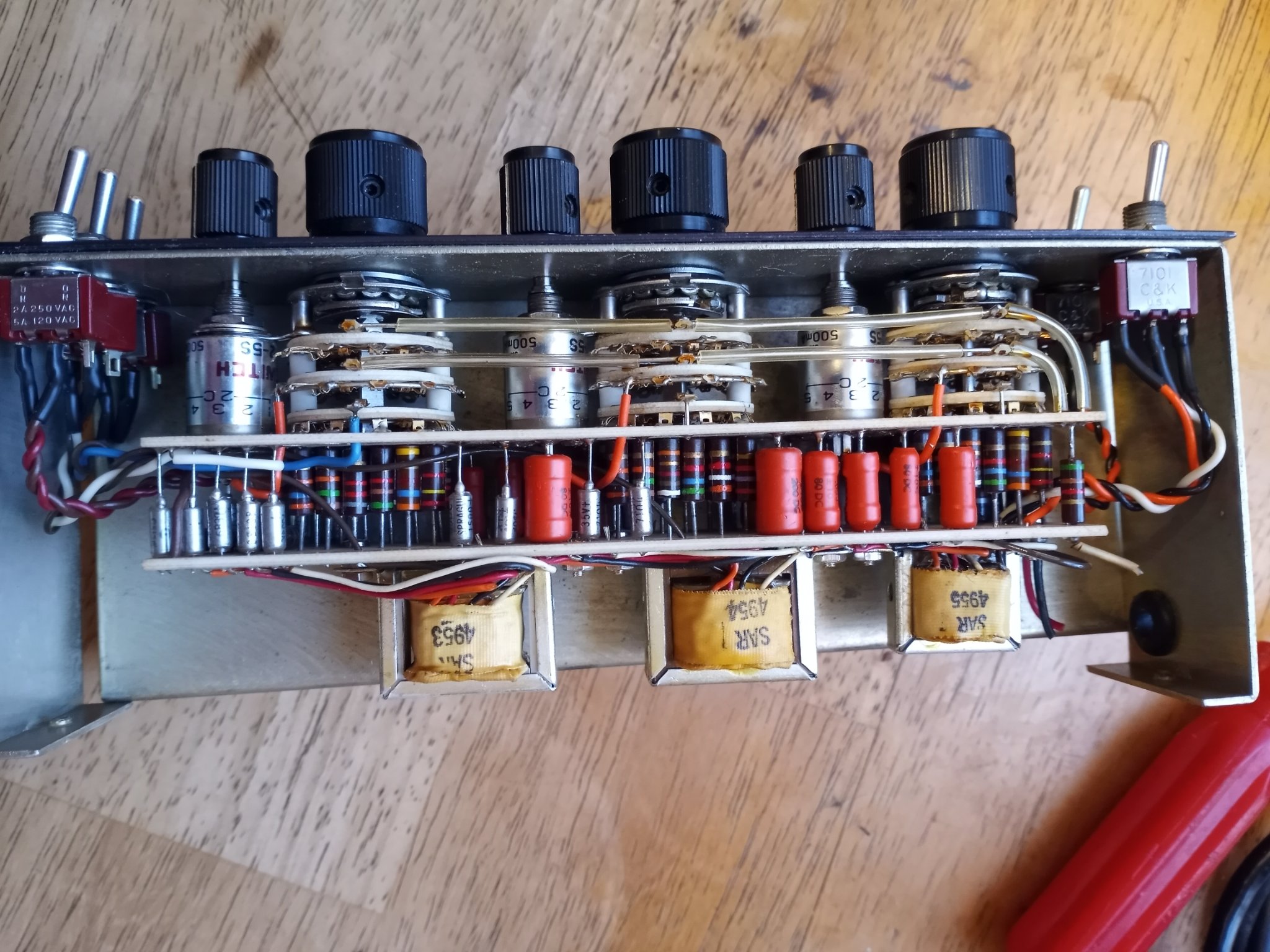

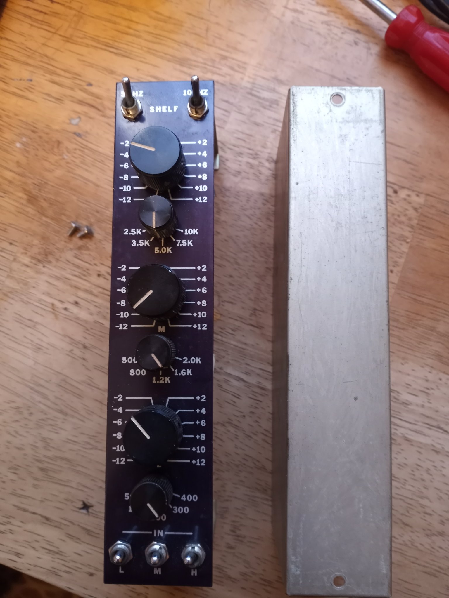

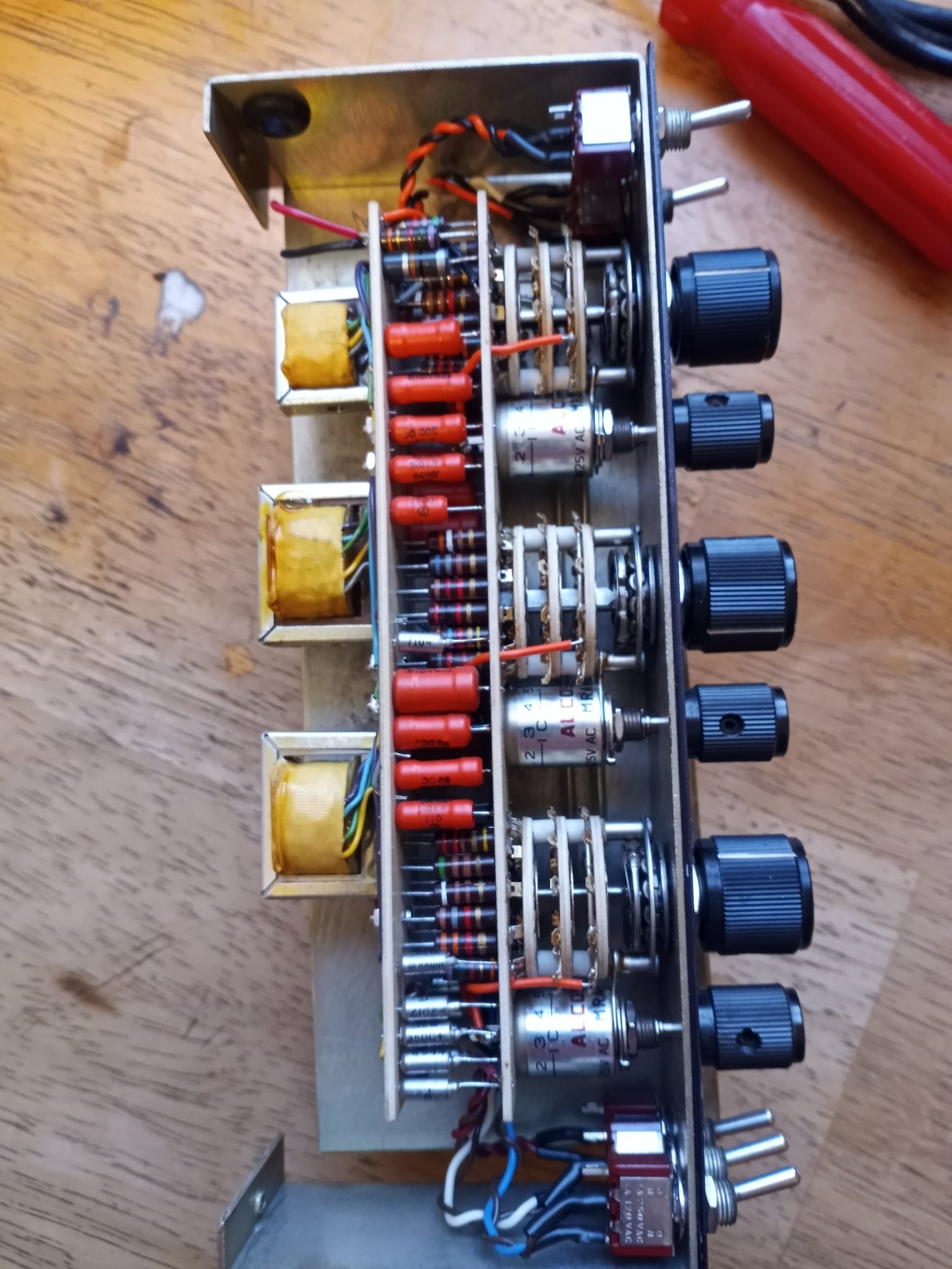

Back to the corrector , I need to figure out which of " white , red , black" cut wires is the output and input wire . Black appears to be a common ground wire. Care to make an educated guess based on experience with vintage pro audio color coding ;???)

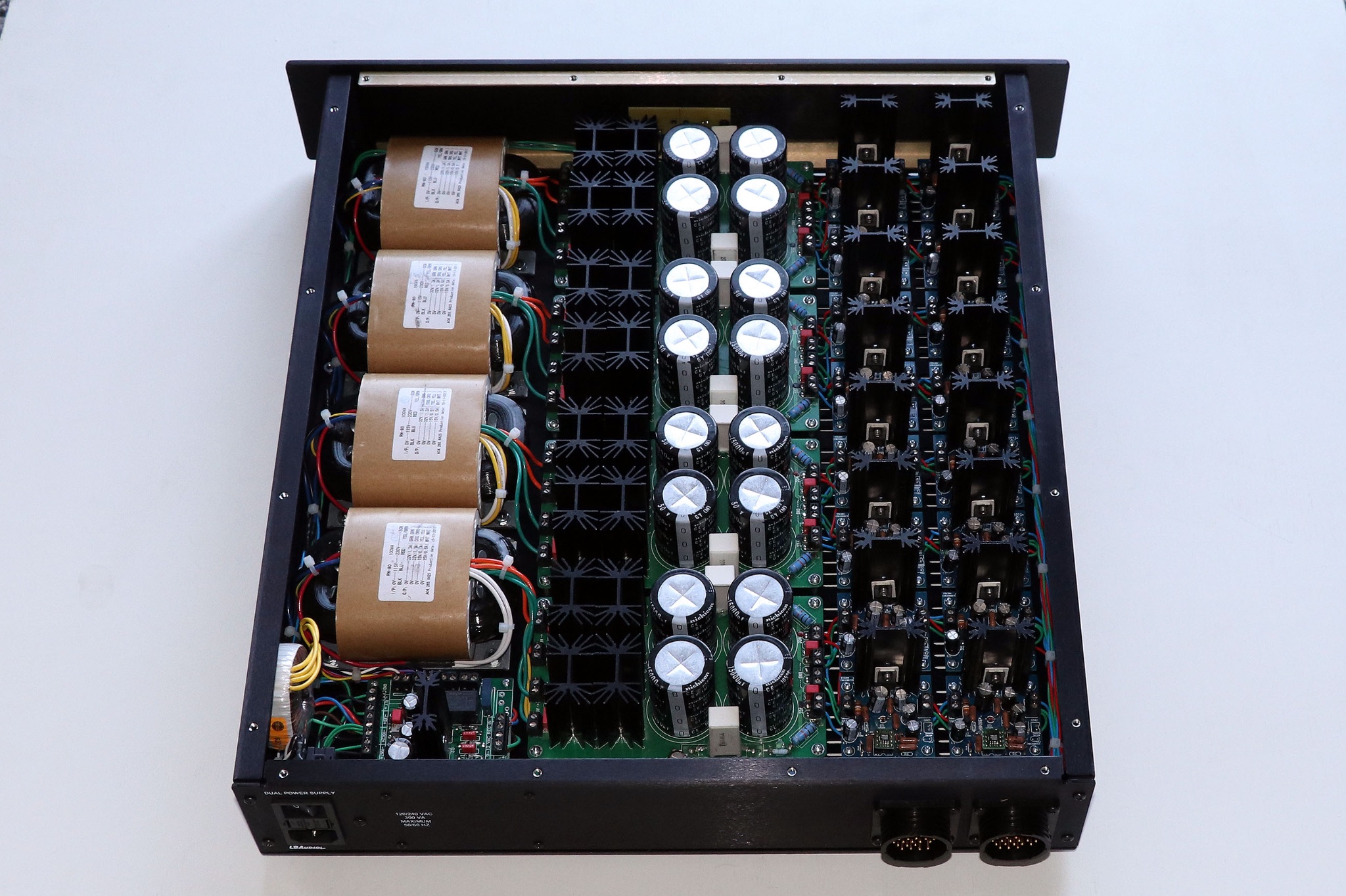

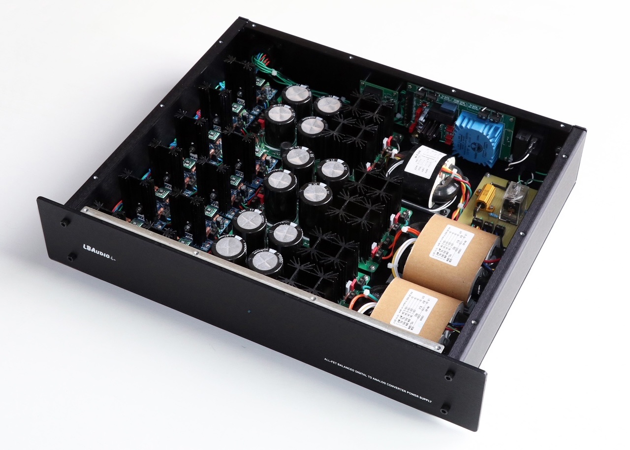

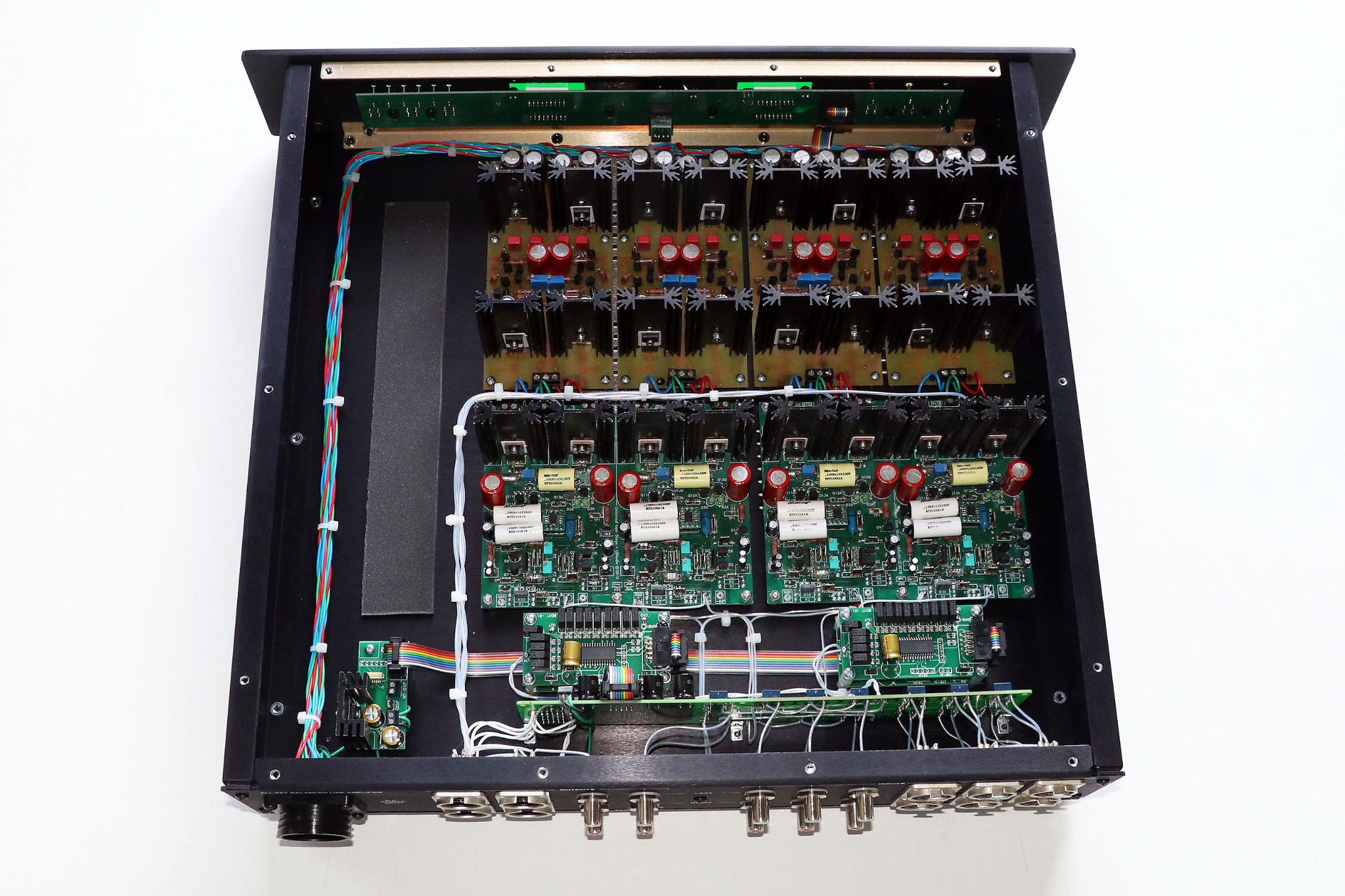

I too have Borbely’s phono, along with his line amp and DAC. Borbely s shunt regulators, film caps are Re Cap Teflon and RTX polystyrene , ( the RIAA caps are 1% teflon). Blackgate bipolar electrolytices, TX2575 resistors and trimpots. I have other tube and solid state - phono and line stages, one has from the 70’s tantalum coupling caps, nothing I enjoy now. . Line amp and Dac with power supplies pictured
Parts sourced and boards stuffed by me, chassis and assembly by Les Bordelon. Pre regulators are Jung / Didden +/- 31 volt super regulators on custom 2x 2 inch boards Each chassis runs 25 watts Class A dissipation. Teflon/Silver wired, stepped resistor attenuator. 100 watt R-core transformer per phase. Quasimode snubbed hexfet bridges for each polarity and each phase with 240,000 uf of CRC pre filtering. Now I’m broke and tired.

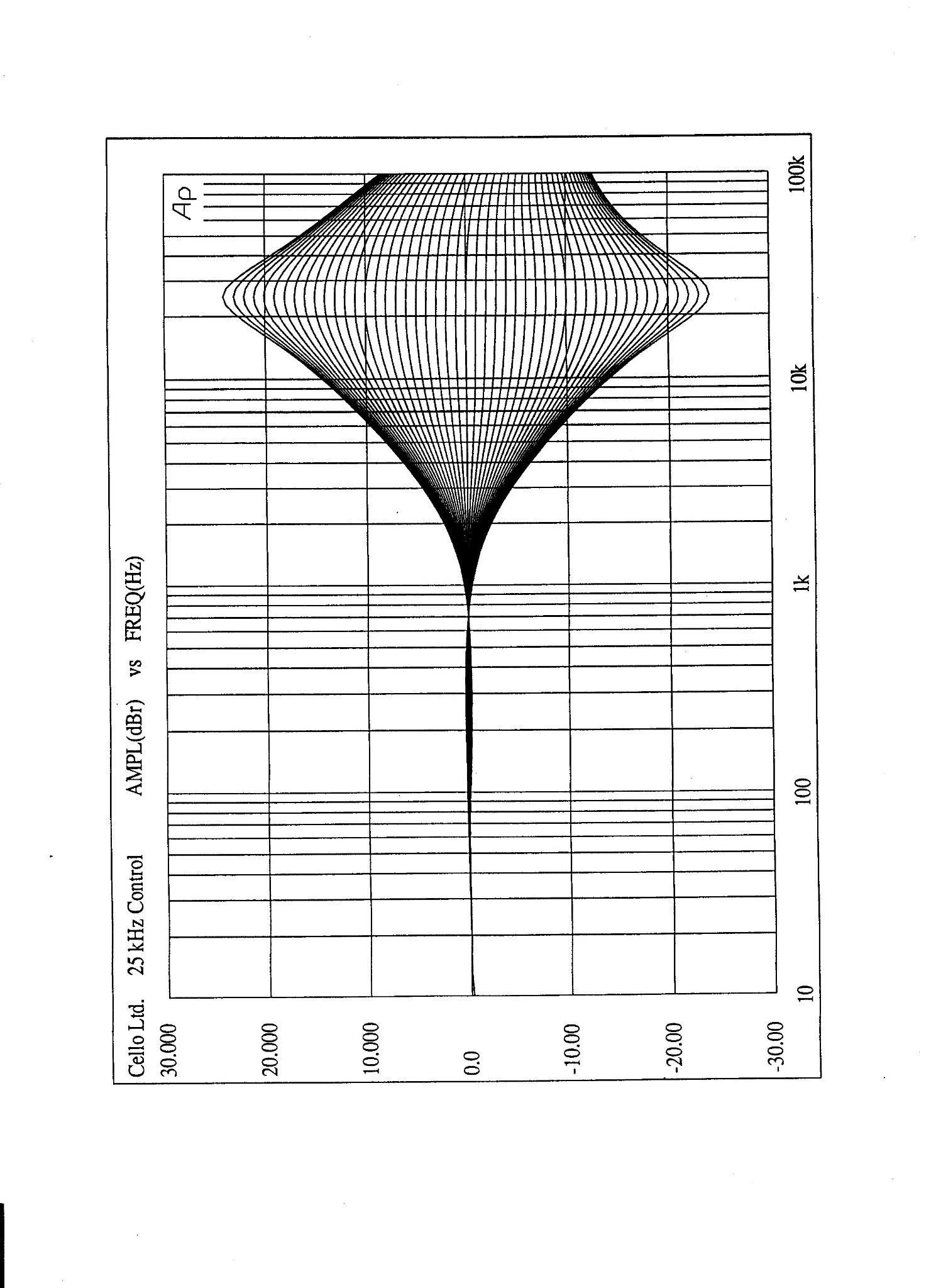

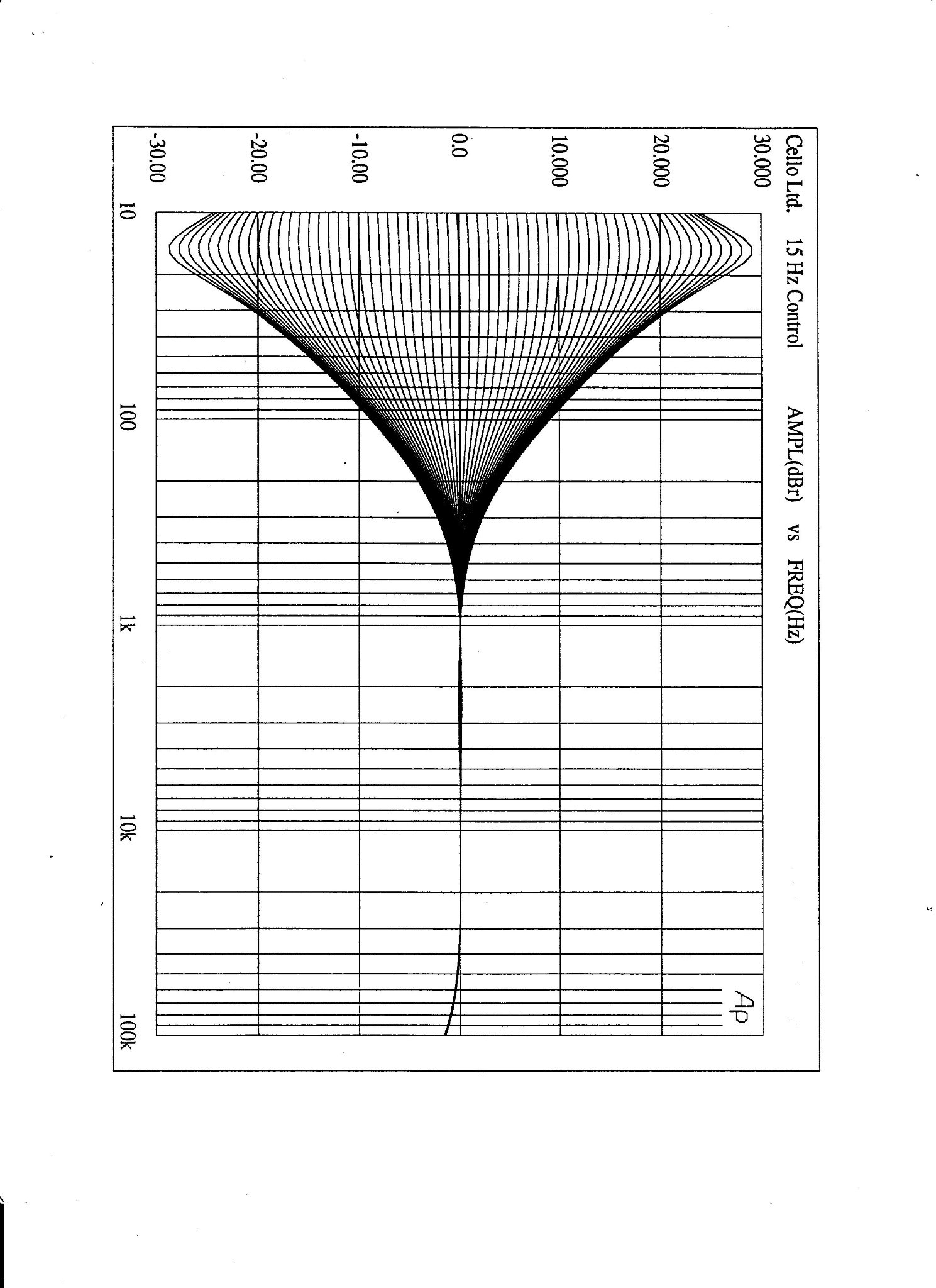

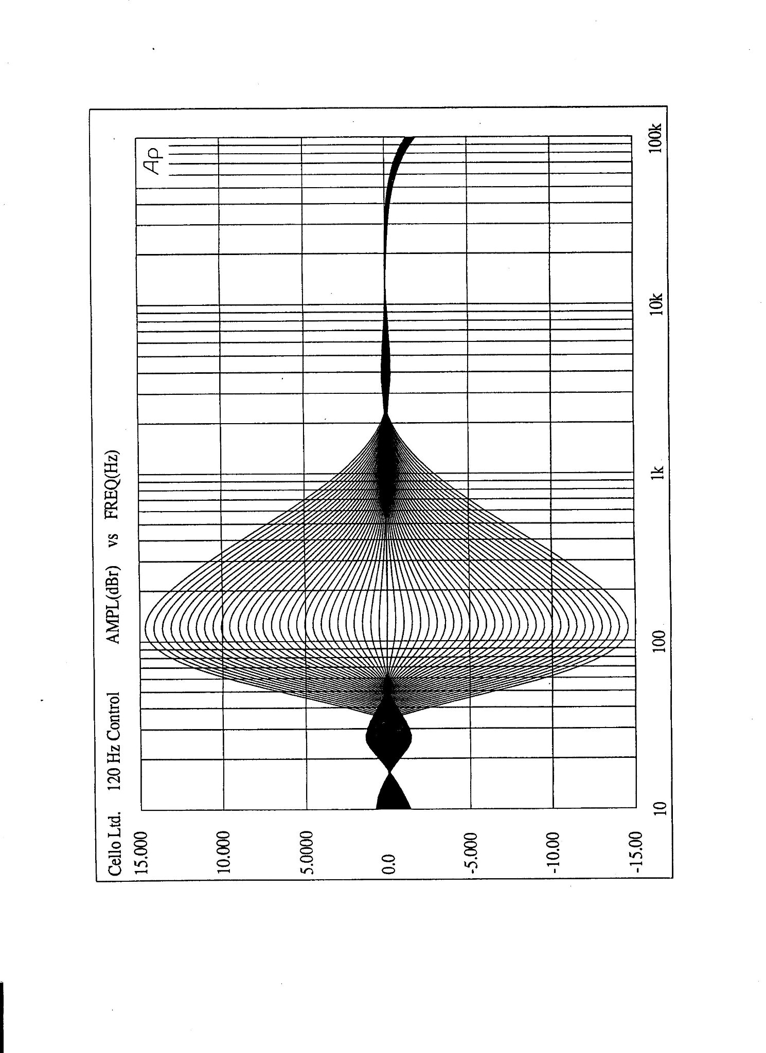

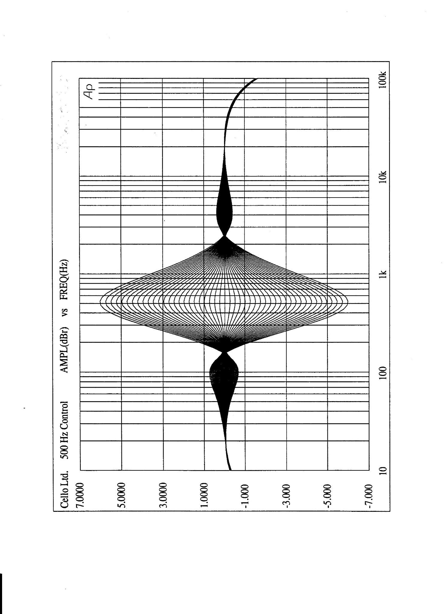

As written before, I had an opportunity to "play around with" (and implement) the Palette Pre hardware along with a lot of documentation on it; the original Palette and Dick Burwen's original (op-amp-based) concept drawing. Also looked up other equalizer info, especially that in the old (1985??) National Semiconductor (NS) Audio Handbook. Something always bothered me but couldn't put a finger on it. In a lot of program equalizer designs like the NS, the individual filter sections were all put electrically in PARALLEL - with appropriate input/output buffering. BUT in Burwen's and following Cello incarnations, the sections were put in SERIES/PARALLEL! Specifically, the 15hz; 500hz; 2K and 25Khz sections were in PARALLEL, followed by another paralleled 120hz; 5Khz section in SERIES with the first. Never had nor taken the chance to ask either of the few remaining original individuals if they remember why this was done.
There are certainly good electrical reasons why they should all be in parallel, like maybe lower noise/distortion. But do realize now that with this all paralleled approach, any boost or cut in any one frequency section is passed thru (unaltered) to the other frequency sections and then added together. Whereas in the parallel/series approach, there can be more of an amplitude interaction between the two paralleled sections AND any "corrections" in the later (120hz, 5Khz) filter sections will have more amplitude effect than in the all paralleled approach. Any thoughts? At least it's not keeping me up at night anymore.
Do have in front of me the original Palette's Audio Precision plots - dB vs frequency - for the each band's control switches Will try to copy and post them
Spice simulation of Burwen's original op-amped prototype of the Palette gives the same behaviour with the ripples outside the nominal filter profile. This is a result of using a positive summer - the filter outputs go into the positive input of an opamp - semiconductor in Burwen and discrete in the Palette.
If a negative summer is used, as per my posts an eternity ago, those artefacts disappear and the filter profiles are clean.
I have no idea why Burwen, and then Cello, used a positive or non-inverting summing topology. They are a real fight to design and make the filter profiles independent, so turning two profiles up might not produce an independent sum.
