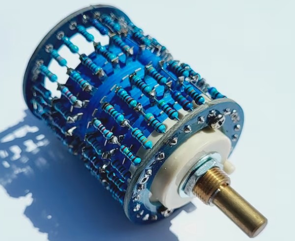

For that you need a stepped attenuator, here in the amplifier version:
All very tricky. But in fairness to Matt Haycross ( Who I think was trying to keep it simple for stupid, aka KISS...), even Celestion made this schoolboy mistake in the 551 brochure:

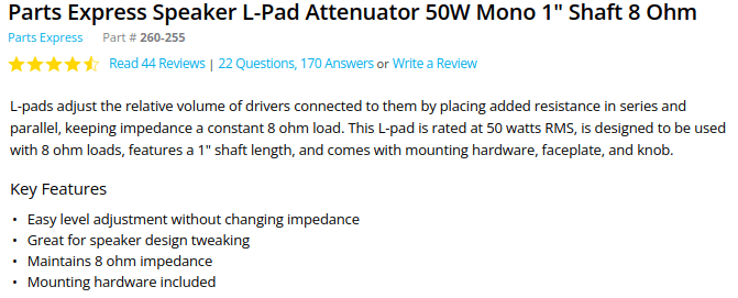

And you'd be wrong, @Galu the Googler! 🙂
Parts Express are equally mistaken:
https://www.parts-express.com/L-Pad-50W-Mono-1-Shaft-8-Ohm-260-255?quantity=1
Just set up the circuit diagram with, say, an 8 ohm or a 4 ohm load and assume the pot is 8 ohms and load impedance varies between 2.7 ohms and 8 ohms depending on the position of the wiper!
The only thing you CAN do, is maintain a constant source impedance with a zero ohm feedback amplifier with the circuit you quote.

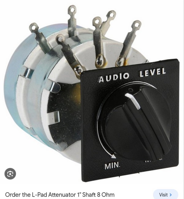

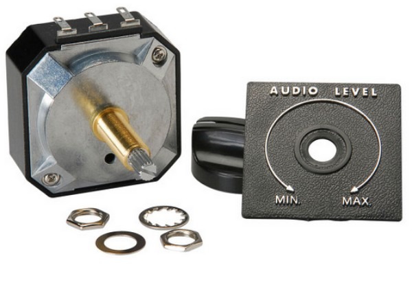

A potentiometer has one resistive winding, whereas an L-pad has two resistive windings, as shown below (courtesy of Perry Babin).
In an L-pad, the series resistance will vary from 8 Ω maximum to zero Ω, while the parallel resistance will vary from zero Ω to 120 Ω and then infinity at full clockwise rotation.

@Galu. I am starting to think that you are right and I am wrong here on this L-Pad business. 😳
The low resistance leg is 8 Ω while the high resistance leg is typically 120 Ω or could be even higher as shown below:
In the volume full DOWN position, the 8 Ω low resistance is in parallel with the input, and the tweeter is shorted to ground by the high resistance leg.
In the volume full UP position, the 8 Ω low resistance is out of the circuit, and the 600 Ω high resistance is in parallel with the tweeter.

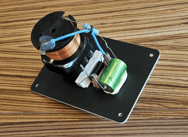

That's a nifty compact crossover > but note the steel back of the 'level adjustment devise' will change the inductor value.
Quite right, but surely you'd just adjust the coil value to compensate?
But it is UGLY and amateurish looking. In fact I don't believe this VERY sloppy looking crossover is what is inside a 2,000 Euro loudspeaker.
I think WLM were guarding their secrets with this smokescreen. 😆
What interested me is that you can build a good loudspeaker from such cheap components.

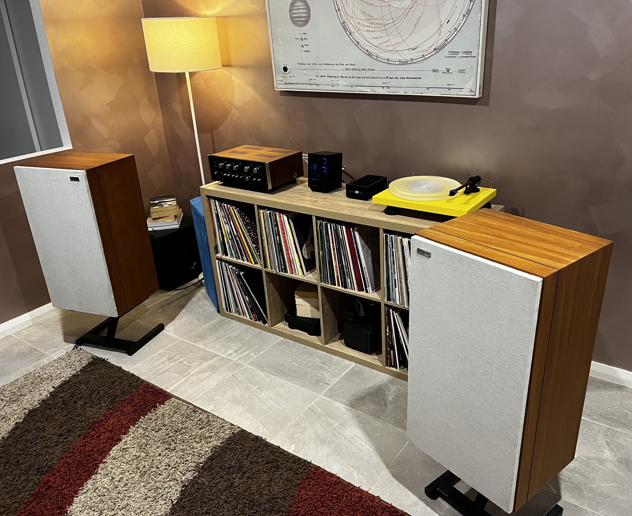

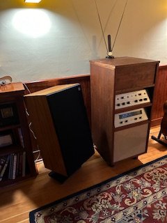

I find the bass to be really satisfying with my pair of Ditton 551. Their fibre cone woofers need plenty of power to get up and go. I wouldn’t think a tube amp would be a good match. I use a Sansui AU-555A as a preamp into an XTZ Edge A2-300 which powers the Celestions.
Beatiful looking speakers Hides!
Since recap I notice my speakers seem more "stable".
I am glad I did it as there were other connection issues that got addressed.
No fun taking out those drivers.
The Bass seems very dependant on the source recording.
If I go up to about 3 on the Fisher KX-200 they are pretty damn loud in my small room.
(Wife must be out!)
Next need to build some original looking stands!

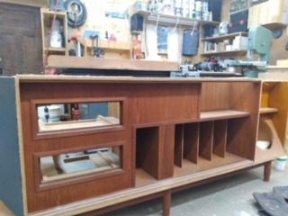

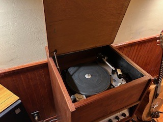

Pics of Fisher project that started the search for nicer speakers.
I had to shrink teak cabinet.
Original cab was almost 8' long!
