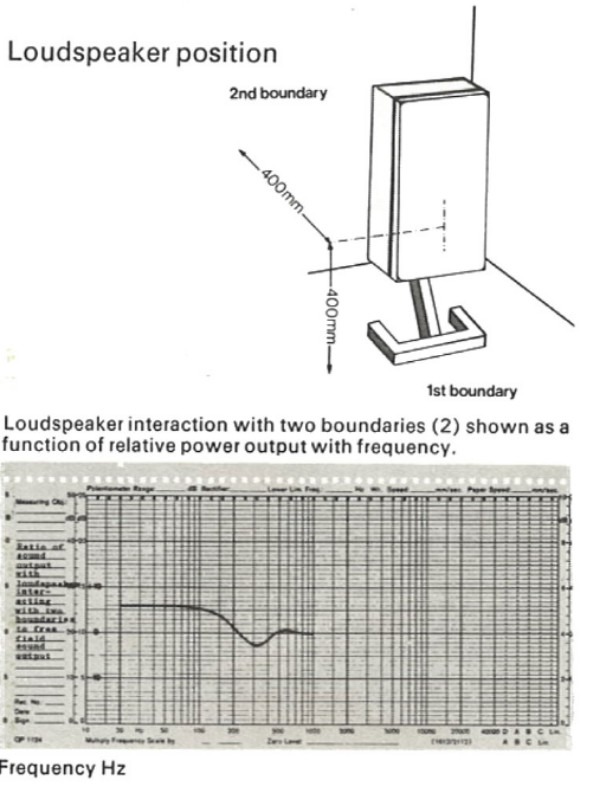

All very tricky. But in fairness to Matt Haycross ( Who I think was trying to keep it simple for stupid, aka KISS...), even Celestion made this schoolboy mistake in the 551 brochure:
