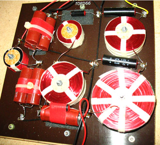

I only had time to test 2 of my speakers for DC resistance. Both pairs of 66's are in the same room...one pair on top of the other in a tower arrangement. The lower pair I'll call "blacky" because of the black front, and the upper pair I'll call "woody", for the wood front.
left woody:
high....4.4-4.5
mid....6.6-6.7
low....4.1-4.2
left blacky:
high....3.8-3.9
mid....6.7-6.8
low....4.3-4.4
...and from a spare woofer: 4.2-4.3
here is a pic of woody's crossover:

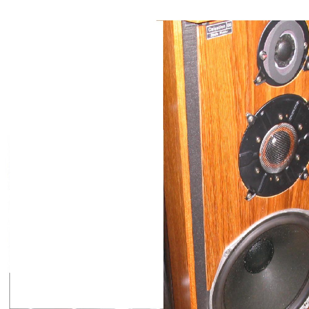

Diffraction control
tonedef2 said:
News> I finished messing around with the diffraction problem> net result was, attaching the audio wool to the upper grill works best and did have a good affect, I will describe as less blurring of the high freq energy, note: if you listen with grills off........then I simply used a custom cut wool with very little Velcro to slip under the top over hang (your grill will fit a little tighter), works great and am now working on the aesthetics.....
2-I will post some picks of the grill soon for analysis as im pretty sure as the audio wool loosens over time we have a ringing affect at moderate attenuation.
Pete, I'm pleased you have heard the effect of reducing the diffraction.
What you have reported is what I had expected would occur, and how I hear such myself.
I would also describe it as "clearer" {as distinct from "brighter" which can be caused by diffraction in some circumstances}.
If you try a strip down both front edges of the baffle panel from where-ever you have stopped in the tweeter area to down past the mid-dome a few inches, then you should be able to hear similar benefits in the mids' reproduction.
The strip will need to be at least 3" wide for the mids, as it has to absorb sufficient part of the longer wavelengths of the lower frequencies there.
Sound should be clearer with the grilles off, but if listening with the grilles on, than the tighter fit you mention should reduce vibration of the grille frame.
I am puzzled by the "ringing effect at moderate attenuation" you mentioned.
Is this when the wool is loose, or when the grille is looser fitting ?
Are you listening with those oval/rings around the tweeters still in place, or them off and only the wool on now ?
Yes, do post some pictures, as that will show us what you have done, and may help to see how to solve the ringing effect you have mentioned.
the DC resistances, and the large orange-red capacitors.
Great stuff sba !
thankyou indeed for posting the DCR's , as this confirms the figures Pete has posted also for those, and the two different vintage samples are of interest also.
Is your "blackie" 66s older than your "woodie" set ?
There may be a Date, or some type of Date Code printed on either the front or back of the cross-over boards.
Capacitor C7 - the parallel pair of large orange + small black is probably a 20uF electrolytic cap {orange} with the black cap the same 4uF type as C5 on one of Grahame's set of boards.
The large red-orange caps in the treble filter section of "blackie's" board I do not recognise, but possibly these are a Paper-in-oil capacitor type, as such were used in cross-overs years ago, and are said to give better sound than Electrolytics and some plastic types.
Can you read what is printed on them, and post here ?
I may be able to identify them from the lettering.
Some paper-in-oil types do not have as high dielectric absorption as electrolytics, but this depends on the type of material{s} used to make the paper, and the type of oil.

Pete, you know more about the vintages/versions of the Ditton 66 than I do.
Those two sba has seem to be older types than Grahame's pair, and yours - {if yours are the same as Grahame's ?}, ?

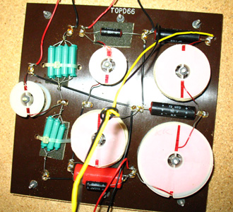

"woodie's" board has the two sets of old type plastic film caps in the treble filter the same as on those 2 boards that Grahame bought from the e-bay seller.
Notice that the DCR of the tweeter in "blackie" is lower than in "woodie" and in Pete's later model 66.
I wonder if this is simply co-incidence, as we only know 1 tweeter sample from "blackie", OR, if Celestion changed the voice-coil in a later version of their HF2000 tweeter ...
What-ever the case, and I do not know for sure but I think paper-in-oil caps have larger ESRs than even those old plastic caps, thus the ESR of the paper-in-oil cap may be sufficient to add to the DCR of that lower DCR tweeter to give effectively the same resistance at the 5 kHz cross-over frequency as the higher DCR tweeter + very low DCR of the plastic film caps ...
More on this when I post about capacitor selections, soon I hope .

sba - good to see that your crossover has the zip-tied green capacitors - I wasn't certain if they were originals on the crossovers I won on ebay - but this would seem to indicate they were.

1-Yes the sound is cleaner, however im-having trouble with something that may look good…Q>so Alan how thin can I go on the wool? Can you save me time trying endless thicknesses, also if you look at the front baffle, you will see that the outer router grooves that run the length of each side have 2 reflecting points as well!!!
So I will (after hearing from Alan regarding wool thickness) try and cover the entire top section for a test, if positive then the hard part of fabricating something removable, that won’t damage the wood and still accommodate grill placement can begin, L.
2-Ringing was the wrong word choice rather lower in frequency, I have tracked this down and a simple re-glue of grill cloth and fixed it, check your glue in this location folks….
3- Yes with the rings still in place as it appears I’ll need to replace the cardboard around the tweeter after removal of rings, cardboard in integral too as it’s used to hold the diaphragm in place. Alan could the simple application of 2 fairly thick and wide felted wool rings work to avoid the many reflecting & diffracting points on these baffles with the exception of the top overhang?
4-Will post with simple how-to pics when I get to the end of trial and error :)

"It seems to me like your crossovers have been switched, blackie should be sporting the older boards, hmmm"
tonedef2-- I think you had it right....blackie does seem to have the oldest point to point crossovers....blackie's crossover inductors lack the white plastic reels of later models (looking again at the blackie crossover pic, notice that those white radial spokes on the top side of the inductors are simply cloth tape), and Alan thinks that blackie's treble capacitors might possibly be of the older paper-in-oil type.
Alan-- I'll try to find some time later in the week to pull out blackie's board in order to look for a date, and to get info about the orange colored treble capacitors (whose info is hidden behind red colored electrical tape).
So, it seems then that the blackies are first generation 66. Mine look exactly like the pair that tonedef2 just posted from the ebay sale ($1500, wow) -- with black fronts; with beveled edges around the speaker terminal cutouts; and with metallic speaker labels surrounding (directly over) the speaker terminals. The labels also lack the word "Ditton".....It's just a "Celestion 66".
The woodies must be the next generation. Mine look exactly like Grahame's (pictured in this thread) -- with wood fronts; with 90 degree edges on the speaker terminal cutouts; with the metallic speaker label now at the top rear; and with the addition of quality control stamps and the word "Ditton" on the label. But, my pair has an older point to point crossover board with green-colored treble capacitors, while Grahame's pair has a more modern printed crossover board (until he replaced his with the same older board that I have)
And from the last generation, the 662, I saw a pair of crossovers on ebay that looked even more modern than Grahame's....in that the speaker terminals seemed to be connected directly to the back of the crossover board--so that either the crossover had been relocated to behind the ABR, or it remained behind the woofer, and the speaker terminal cutout had instead been moved towards the center.
So, does this sound right....three generations of Celestion 66 speakers, and at least four different crossover boards (two point-to-point, and two printed)?
I 'm sort of curious about the 66 date ranges. The U.S. reviews that I've seen date from around September 1977 (Stereo Review - vol 39, no 3 & High Fidelity - vol 27, no 9) This was the 66 woodie era. Maybe the 66's had a late introduction to the U.S. I wonder when production first began on the blackies. The B&O website says that the Beovox 5700--apparently using the Celestion 66 high & mid drivers (I read somewhere that the woofer, which has a differently shaped flange than the 66, was made by Goodmans)--were available from 1971 on. So the first Celestion 66's must also date from somewhere near that time.
Wouldn’t it be fun to see some retired Celestion employee from the 1970's chime in with more facts about the 66's production, because there's very little production info on this particular speaker (as well as that decade) in the history section of the company's website, or anywhere on the internet!
tonedef2-- My first pair of 66's, the woodies, came with light-colored grill cloths that were impregnated with cola and other stains. I tore off the cloths as a temporary remedy and, while procrastinating about what to do, glued the celestion emblem to the metal frames, and put those back in place. They've been like this for four years now. Have you ever seen speaker grille frames like those?...they're really a piece of work. And the highs come through a little easier without the cloth. With the blackies it wouldn't look so good though. Eventually I would like to redo all four 66s with a light colored fabric....so I'll be paying attention to your progress.

Now....the interesting part. No crossover board is completely identical to any of the others. Blackie #344 contains capacitors that are different than Blackie #249 (pictured above in post #84).
The treble section in Blackie #344 contains two small yellow-colored capacitors that read

and (common to both blackies) four large, dark red-colored, bakelite covered capacitors that read
A 316
Metallised
1.5 pf 150v
D.C. WKG
73 / 25
These A316s were wrapped with electrical tape and had a plastic zip tie around them. After cutting the zip tie and removing the tape, I noticed that the thick bakelite coating on these was cracked all over....in fact, a piece fell off in my hand--exposing the inside metal..... No turning back now....looks like I'm in this project till the end....LOL
Additionally, over in the sub section, Blackie #344 twice uses three capacitors where Blackie #249 uses only one.
The two woodie crossovers are almost alike except that one of them, #27343, lacks the small capacitor mounted with the larger one at the bottom of the board.
Confusing...huh!
