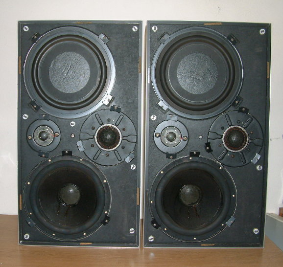

Hello you 2, looks like summer is taking our time away from this project somewhat, mine is certainly limited.
I just wanted to say the felt test is still pending, the speakers metal grill is posing a small problem.....
Im going to try mounting it to the grill instead, will report later next week.
Pete / ToneDef2

Hello,
Yes Alan i will do that first, my thoughts where since this is a potential defraction problem and it could not be seen with the grills on or off, it may just be a win win or draw ;-).
I will pick up more felt this weekend.
Recieved your email....wow....I will take a close look at those solder points and get back to you.
Pete / ToneDef2
doing the frequency response tests ...
Grahame said:
Alan - are there any issues I should be aware of when running the frequency response tests - I think it runs sweep tones / impulses via the inputs - 20-20KHz - I think - so that should be OK with the crossover in place.
If I run the sweeps directly to the drivers without the crossovers ( if I can wire it up like that) should I restrict the frequency range I subject each of the drivers to?
e.g. MD 500 says .5-5KHz on back
so I'd guess 20-500 for the sub
500-5KHz for the MD500
5KHz - 20KHz for the HF2000's
I won't try anything until I hear from you and have read the manuals on the measurement gear.
You can measure the frequency response of the 66 as connected to the x-over, though the result you will get will be influenced by the acoustic of the environment you are measuring in, thus you may have to measure fairly closely to the speaker to get predominantly the direct sound from the drivers and less of what-ever reflected sound back from the room, or ground if you are measuring out-of -doors, and what-ever other noises are in the background.
If the measuring system has a Gate you can set it to close before the later arriving sounds and thus not contaminate your results with anything further delayed in time than the original direct sound from the loudspeaker.
Depending on options of gate closing time, you may need to raise the loudspeaker somewhat above the floor, and/or put a thick layer of sound absorbtive material on the floor halfway between the front of the speaker and the microphone to absorb at least the midrange and whatever treble is reflected from the floor to the mic.
Don't worry too much about trying to measure the bass response accurately - that is very difficult to do, except in a large absorbtive chamber or with the speaker on top of a mast more than 20 feet above the ground.
Another method is to measure with the speaker lying on its back in a shallow rectangular hole which is filled in around the cabinet to be flat ground level with the plane of the front panel.
One has to make a correction for the bass response with such measurement, but that is not a problem to estimate.
Even if not buried to depth of front panel, a flat on back outside and well away from all other reflecting surfaces can give fairly accurate midrange and treble response, as those frequencies are more directional.
However you place the loudspeaker, ensure it cannot wobble, as the frequencies of any wobbles will contaminate the measurement result.
Try a 3-points support under the speaker, well spaced apart - such will minimise wobble.
4 or more points is not as reliable as 3.
If you measure too close to the speaker you will not get the actual response of the drivers added together in the way they would be heard, thus measure at the standard 1 metre in front of the cabinet.
You will get a different response in part depending on the vertical axis you measure on, thus try first measuring with the mic. directly on the MD 500's axis, as that was the standard axis then for flattest response from 3-way loudspeakers.
Try measurements also with mic. directly on the HF 2000 axis, and next from a height with the mic. at the halfway point between tweeter and mid-dome.
These results will show you the best listening axis as you will see the interference effects between the drivers, and hopefully less from one of those positions.
Vertical axis measurements are often done from 6 feet, or 2 meters, distance, because that is a distance more like a typical listening distance, thus if you can set a Gate time to accept that distance -{in time its just under 6 milli-seconds}- and then close before the arrival of the floor reflection, then try that distance for each of the 3 vertical axis heights.
Measure the other 66, at least from the mic. position that gave the flattest freq. resp. , to check its drivers are similar to the first 66s'.

partial error in my post #56
alan-1-b said:
The E.S.R. values of the electrolytic capacitors will be significant also, and likely need duplicating when replacing with the much lower ESR polypropylene capacitors, especially for the 72uF cap that is in direct parallel with the woofer, and perhaps for the other 72uF, and less likely for the 24uF -{which will have a lower ESR anyway}, and highly unlikely to be necessary for the 4uF black cap. <-- UP-DATE following this -->
I've changed my mind after thinking about an audible effect that tonedef2 described earlier. Now I think there may be need to add the resistance here to reduce to negligible level a possible audible resonance that a very low ESR cap could cause to occur here, as it seems it may be with the low ESR cap later put in his x-overs instead of the black 4uF electrolytic.
E.S.R. = Equivalent Series Resistance
It is so long since I worked with electrolytic caps in a wide-band audio-critical application that it slipped my mind that the ESR,
{which is dependant on the Dissipation Factor of the dielectric}, varies with frequency !
Basically, dissipation factor in electrolytic caps is higher at low frequencies and lower at high frequencies, BUT, do not confuse that with the Capacitive Reactance, which is of course higher at low frequencies and lower at high frequencies.
Dissipation Factor represents a loss, it is not useful, and it does not have the same phase angle in circuit as capacitive reactance, thus we cannot allow for it by simply increasing the value of capacitor when we substitute with a low dissipation factor plastic film cap.
Thus we have a different ESR at 500 Hz in the 24uF cap than is at 5 kHz !
So, how to simulate that with a fixed resistor, to try to keep the Impedance at what it is at 500 Hz region and 5 kHz region ?
Well, it can't be done simply, thus one has to compromise and select an in-between value, put it in and listen, and if not liking the sound then either slightly increase or slightly decrease the resistance value, but I hope if I estimate close enough, and am lucky, then you may not want to change the resistors !
The ESR in the 72uF caps will probably be about 1 ohm at 500 Hz, possibly a little less and hopefully not much greater.
The ESR in the 4uF black cap will probably be about 1 ohm, or slightly less, at 5 kHz.
ESR at 500 Hz is not relevant for the 4uF cap.
The 24uF cap is in Series with the mid-dome and both sections of the x-over filter, thus its ESR is relevant in the regions around both x-over frequencies.
At 500 Hz it could be about 2.5 ohm or slightly larger, and at 5 kHz it will be quite low, probably less than 0.2 ohm.
I recommend using no less than 1.5 ohm for the resistor, because less will shift the lower x-over point up a bit too much.
1.5 ohm will have minimal effect on the higher x-over frequency, but you might notice slightly less upper midrange brightness. If that is audibly not wanted, then reduce resistor to 1 ohm or 0.5 ohm, and yes that will have shifted the lower cut-off up a little, but will be part compensated by being a little bit louder at the low end of the mid-dome's output, for about an octave, approx. 600 - 1200 Hz.
As I said, this will involve a compromise, a trade-off, but probably not an excessive one.

Im looking for one orig 66 version 2 xover board to hack up for this next phase of our project......
News> I finished messing around with the diffraction problem> net result was, attaching the audio wool to the upper grill works best and did have a good affect, I will describe as less blurring of the high freq energy, note: if you listen with grills off........then I simply used a custom cut wool with very little Velcro to slip under the top over hang (your grill will fit a little tighter), works great and am now working on the aesthetics.....

2-I will post some picks of the grill soon for analysis as im pretty sure as the audio wool loosens over time we have a ringing affect at moderate attenuation.
