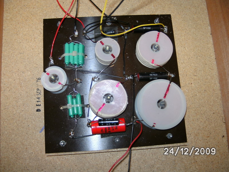

Buy the Seas 19TFF1. It's awesome! (Best get 2 of them 😛 )
Replace the caps as per Alan's ordering instructions.
Fit ESR compensating resistors as per Alan's ordering instructions.
Replace the binding posts. Remember that there is an aluminium plate on the current ones that will short out your speakers unless new binding posts are isolated from it.
Sit back, relax, enjoy! You've got one of the most pleasing pairs of loudspeakers ever made, improved beyond compare...

Also, if you have a circuit board type crossover, I'd consider re-making it point to point on a 10" square piece of ply. It will all fit easier, sound better, and teach you a lot about how your crossover really relates to the schematic.

Capacitors for specific sound, and Budget for ?
Hi again Wayne, - and also to "tojohndillonesq"/SC if you are following this,
for Sound-field it is priority to get the midrange correct, and next the treble,
and the bass is less of a concern in that aspect -{but NOT irrelevant}.
Regarding capacitors and sound, the most expensive one will be the 24uF cap at the input of the midrange filter,
regardless of whether one uses a single 24uF or 25uF cap, or a Parallel connected pair of 12uF caps ...
and which option depends on what each manufacturer offers.
At least a third of the total mids plus treble caps' cost will be for the 2 that input cap, and perhaps almost half the cost.
Caps for the bass filter, though larger uF, will not cost more than midrange caps, because for the critical audio determinant there a cheaper option is available.
The same Brand of cap as for the mids and treble could be used in the bass section also, but price then will be very much higher, thus I recommend you allocate your Budget to maximise the sound quality you want in the mids and treble, and buy what is adequate for the bass that will not significantly reduce the benefits of the better caps in the mids and treble.
What is the Total amount you will extend to for capacitors ?
Do you want all caps to be the same brand ?
or do you want the choice split as I described above ?
or do you want some other option, and if so please specify what ?
Keep in mind there will be about another 10% cost for Shipping -(more if you want Express or Priority shipping).
Likely for less expensive bass caps, they will be from a different seller than the mids + treble caps, thus two Shipping costs.
Post the Budget limits only for the Capacitors, not for the Shipping,

I think I understand the bulk of the money spent on the replacements caps is best spent on the treble and mid-range.
I' not sure if buying from a single manufacturer is best, although I would imagine that they would spend more time designing their components to work at their best with other components in their own range. But if the bass caps are less fussy regarding this issue and it would work out cheaper to source them from different manufacturers then so be it.
As far as the money I spend goes, that's a difficult one. For example, when looking at the 'Claritycap' range of capacitors my first instinct is to go for the most expensive. on closer inspection this is complicated first by the cost itself, which can be very considerable, and then the values(uF) and tolerance contained in each range. Then there is the physical size of them, which do seem to be rather large and possibly difficult to accommodate on the crossover board.
I also need to take into account my limited experience in building electrical circuits and I certainly wouldn't want to allow my lack of dexterity with a soldering iron etc. to ruin any of these expensive components whilst assembling them!
I would imagine it will be a compromise of these variables that governs my decision on how much to spend.
I would say that I have an overall budget of approximately £200 - £300 for the crossovers project (not including the speakers).
I have been looking at other aspects of the crossover design and was wondering what you make of these following points?
There appears to be steel bolts and nuts retaining the inductors to the board – if they are steel then they are magnetic and will alter the inductance value which will change the crossover response – these should be brass (non-magnetic).
Ideally inductors should be mounted so the windings are at right-angle to one another to minimize mutual inductive coupling.
The inductors are very basic types – upgraded inductors i.e. lower DCR for the 2 in the bass section will improve the tightness of the bass; non-bobbin air-cores will improve the signal path (and clarity) in the mid and top.
Best Regards
Wayne

Hi Alan,
The one thing I have noticed and am unsure if I have mentioned this before but the capacitor at the bottom of the crossover board if in fact two caps run in parallel. I think their reference numbers are 'C4' & 'C5'. These are rated at 6uF & 24uF respectively. The photos I have seen previously posted from others shows only one capacitor in this place in the circuit. I have tried to attach the photo of my crossover to this posting.
Regards
Wayne.
P.S. I can be flexible regarding the budget, it would just take me longer to accumulate the extra money. I do want to get it right, but as I said it's going to involve a certain amount of compromise and whether extra cost means a pro rata advancement of sound quality.
Wayne.

It's not unusual to have a 24uF and a 6uF or an 8uF in parallel in the mids section of the 44s and 66s. If they had had a 30uF available at construction, they would certainly have used that instead. It was a question of availability. In some speakers they only put the 24uF. I don't think it's been clarified for sure which is the earlier design and which is the revision. My guess is that the 30uF is the more ideal value.
Regarding improvements vs. cost (or getting good value from your upgrades) my advice is to completely forget upgrading your inductors, at least until you've heard the existing ones with the cap restoration. Buy Jentzen Cross-Caps throughout, Seas 19TFF1 tweeters and Welwyn wirewound resistors. All are plenty good enough, and would have been absolute luxury to the designers had they been available back then (except the resistors perhaps).
More expensive versions of all of the above are available in spades, but all subject to the laws of diminishing returns on these old but lovely speakers. The above components are all of excellent quality, and it is design considerations (such as determining the correct resistor values) that will really elevate your speakers to their full potential.
I heard a story of a man who replaced all of the caps in his 66s and hated the sound, so bought more and more expensive caps time and time again. In the end he went back to the original 30 year old electrolytics and said it was miles better. This is typical dumb upgrader behaviour. He knew nothing of ESR resistors, so of course his Mundorf caps sounded awful - he had changed the design and it had become awful!
Similarly, a hi-fi builder commented on the Pass Labs F5 power amp build page that he found the sound a touch clinical, and said he was going to remove the good metal film resistors and replace them with carbon film resistors, that are much poorer on paper, to "warm things up". The genius amp designer Nelson Pass told him that a simple adjustment in a single resistor value could achieve the same thing without degrading the sound and the man reported that it did.
My point is: Design first, exotic parts ONLY once the design is perfected!

Hi Lucas,
I am of course inclined to agree with you. I seem to remember you have gone through this exercise before? What sort of budget did you in fact have in mind before you started? and what was the final cost?
Are you sure about leaving the Inductors as they are? I am worried about my physically being able to mount all of these new expensive components myself. Did you start with a new crossover board? or adapt the old ones?
Best Regards
Wayne
It is design considerations (such as determining the correct resistor values) that will really elevate your speakers to their full potential.

Oh, by all means change their physical layout in relationship to each other if that is what has been recommended and it assists in fitting everything in. My point was more that they are of good enough quality to not need upgrading in a hurry.
Fitting new ones will complicate everything - it will mean that you are in a position of changing every component, and then there will be so many variables that it becomes far too hard to determine what is happening and because of what. I was for many years a professional classical guitar maker, and know well that making refinements needs to be done in small stages to properly evaluate the direct effect of the changes.
I used the existing crossover boards in my 44s, but I haven't fully upgraded by bass section yet, and that is by far the largest part. The existing boards do have those useful solder points that seem to work well. A 12" square piece of ply is what I'd use if changing it, strapping caps and inductors to the board through drilled holes with plastic ties and wiring point to point. I don't think it's necessary though.
If you really want to upgrade them, I would also consider some cabinet damping materials upgrade. Panels can be lined with adhesive material that reduces cabinet vibration, and the foam filler is not the best stuff - hemp wadding is said to be better by some.
