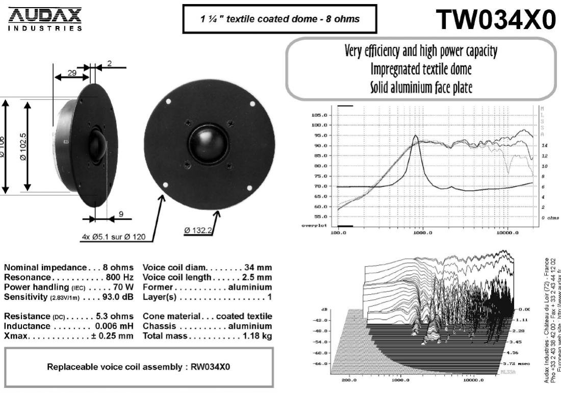

The Audax TWO34XO and Ciare MT 320 will NOT give their best performance with the lower sensitivity Celestion mid-domes,
{though both those tweeters would be very suitable for higher sensitivity loudspeakers, or for loudspeakers being driven to very high volume levels}.

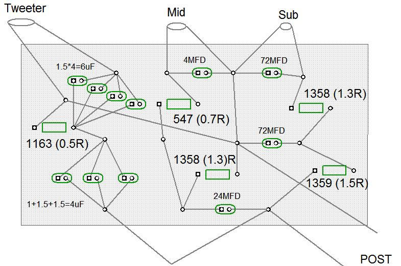

I have some photos of the crossover circuits currently installed in my 66's. They seem to be the same as the one's previously posted except that the the bottom capacitor is split into 2 parallel capacitors of 6uf and 24uf (C4 & C5). I will try to post the photo into this thread but I'm not exactly sure how to do it. I have managed to attach it
I think.
I hope this all makes some sense to you. I would especially like to hear from you about my new choice of the Vifa tweeters and the possible use of the additional Realistic Super Tweeter in their own enclosures as I previously described. Of course I want to make sure I don't do any harm to 66's

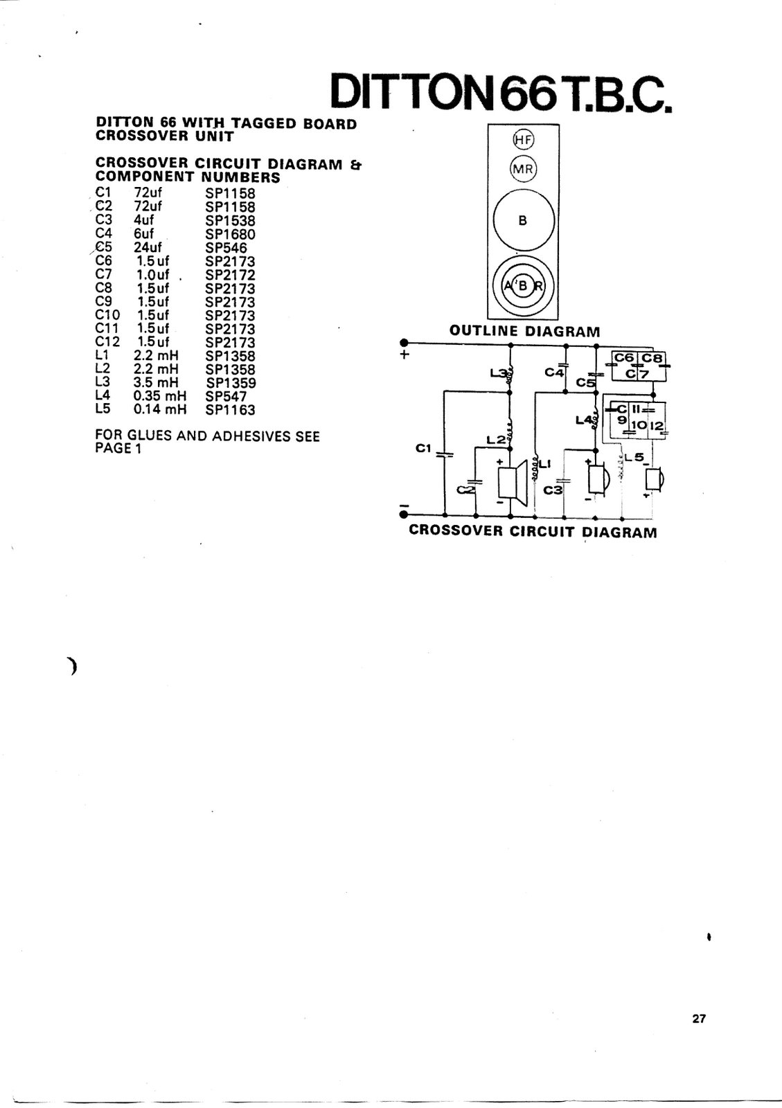

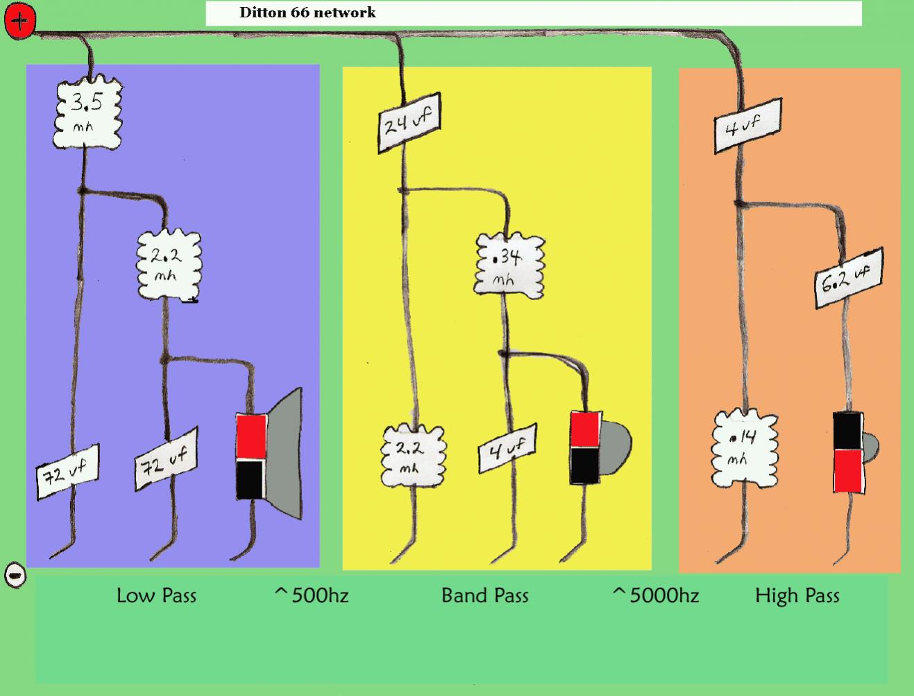

The photo of the other version of the 66's crossover schematic for my 66's crossover:-
Notice that the bottom Capacitor is a single one. Whereas on mine this has beeen split between two. A 6uf & 24uf Capacitors (C4&C5)
Here is a list of 66's componants-
I still want to restore the crossovers on my 66's, replacing the capacitors and coils if necessary but I'm still clear on certain things! Why have they used capacitors in prallell i.e. C4 & C5; C6,C7 & C8; C9,c10,C11 & C12?
Also I have not been able to find exact matches for C1 & C2 @72uf! what happens if I cant find an exact match.
Could you let me have a list of replacement Capacitors & any resisters required to bring them bang up to date using good quality components
The Schematc:-

Regarding the Scanspeak D2010/851300
Hi Alan,
I would be gratefull if you could look at the response curve of this Scanspeak D2010/851300 Tweeter. I have spoken to Wilmslow Audio and cancelled the order for the Vifa tweeter. They seem to be getting a little upset with my ditthering, still I'm the customer who's paying them!
If you don't think it matches the kind of response we are looking for I'll go ahead and purchase the Seas H737-08/19TFF1.
I will still go ahead and build these seperate Super Tweeters using the Realistics I have with their specified crossovers in their own enclosures.
Cheers
Wayne
Hi Alan,
Cheers
Wayne

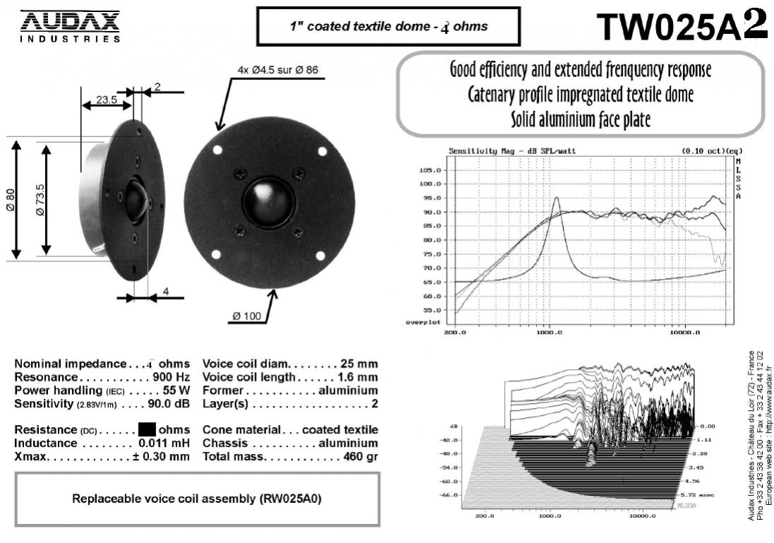

These two tweeters would be on my replacement list:
The lower efficiency Audax…4 ohms / good price, too--
https://www.madisound.com/store/product_info.php?cPath=45_229_324&products_id=374
The higher efficiency Audax…better power handling / more than double the price--
https://www.madisound.com/store/product_info.php?cPath=45_229_324&products_id=1707

Hi Lucas,
Many thanks for the reassuring remarks. Did you make any changes to the crossovers to accommodate the SEAS 19TFF1's?
Wayne
Hi Wayne,
The answer is "not yet!" as I haven't felt the need. Actually, all I did was remove a 1 ohm resistor I put in series with the old HF2000, which had been there as part of the ESR resistors I put in when replacing the old electrolytic caps with polypropylene ones.
I am not messing about with the crossover for a while, as I'm busy building a new preamp and amp, phono stage and then (eventually) a new dac. I will then probably get around to making an active crossover, which is where the crossover is in the small signal domain, and I would use 3x stereo amps to power the 3x sets of drivers, removing the existing crossover. Then, theoretically, I will stop. But probably, I will end up making a linear tracking tonearm.....yikes, I'm nuts! 😱
Lucas
The Capacitor changes in your Celestion 66's
Hi Lucas,
WoW! Good luck with all that. It's well beyond my level of expertise as you can tell! I was wondering which Caps you changed on your 66's crossovers and what resisters were required to compensate for the newer polypropylene caps? Which model of 66's do you have, mine were manufactured in 1976 and are the TBC type with the tagged crossover baseboard. Also did you you replace the combinations of caps wired in parallel with single ones? Also did you replace the large 72uF caps with polypropylene? As I thought they would be just too big! Sorry if this all sounds a bit basic!
Regards
Wayne
Hi Wayne,
Hi Lucas,
Regards
Wayne
Hi Wayne,
I have 44s, not 66s. Come mids and no VBR are the essential differences. The crossovers are mostly the same, except the 66s had more expensive air-core inductors throughout, whereas the 44s has half air-core and half were the cheaper iron-core.
Alan has contributed extensively to not only this thread, but also two others on the same theme of these excellent speakers. Do a search for Ditton 66. He (and others) go into great detail with their experiences of changing caps in the various models of 44 & 66. Alan, in particular, gives great advice on replacing these caps and also compensating for the ESR, present in the old electros but absent from the modern polyprops. Essentially, it is better for a cap to have as little ESR as possible, but simply replacing electros with polyprops sounds terrible, because it makes the crossover design screwy, for want of a better word, so calculating the correct ESR compensation is a critical part of this restoration job. Alan's your man!
I used Jantszen caps myself, and Welwyn wirewound resistors. I didn't replace the 72uF caps with polyprops but with electros (non-polarised type), so no ESR to compensate for. If I had the dough, I would have bought polypropylene though! Big, but not too big.
Good luck!
Lucas
Good luck!
