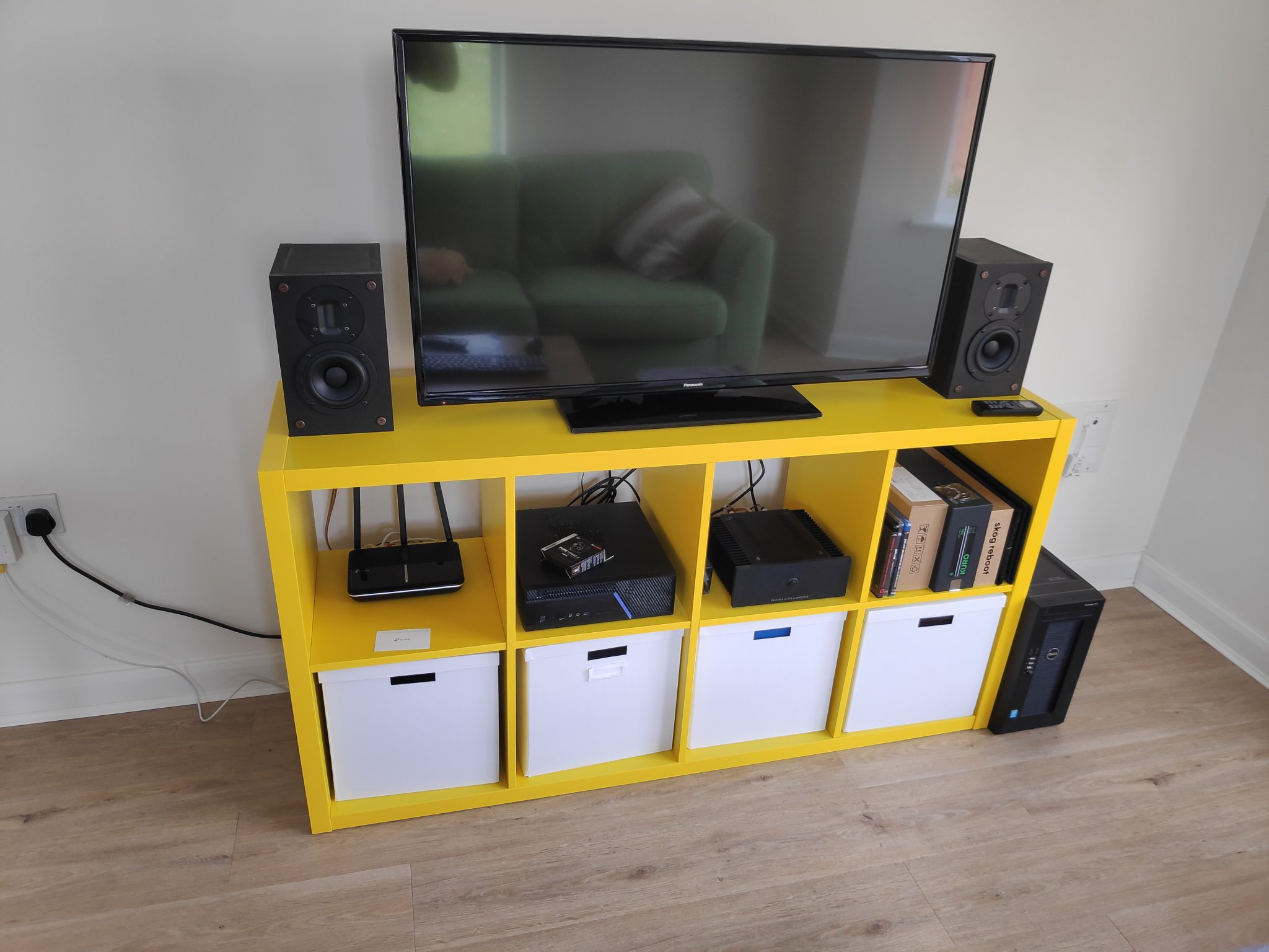

Maybe if i throw in a subwoofer that would be enough?View attachment 1043205This is my current setup. I am using Paul Carmody's speedsters with an ACA amp.

You mention that you are using an ACA in your setup. Have you tried another amplifier that has more watts with your speakers?

I have gone through a lot of amps but I have been downsizing recently. Before the ACA I had an M2 clone but I sold it.You mention that you are using an ACA in your setup. Have you tried another amplifier that has more watts with your speakers?
For bi-amping I would want something compact and simple ideally. Maybe an smps powered lm4780. A second ACA would be nice but they are not cheap and out of stock for now.

Or ICE modulesMaybe an smps powered lm4780. A second ACA would be nice but they are not cheap and out of stock for now.

You can look up the Topping PA5 as option for something compact with good performance.
If you prefer DIY, then there is xrk971's FH9HVX Class AB amp that is a relatively easy build and sounds good.
ACAmini? I like it better than single ACA on my loudspeakers. Thinking of using a bridged pair for bass and an ACAmini up top.For bi-amping I would want something compact and simple ideally. Maybe an smps powered lm4780. A second ACA would be nice but they are not cheap and out of stock for now.
