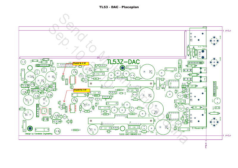

As instructed by CEC, I replaced the pF45 condensers or capacitors. Now I am pleased to inform you that the CD player working flawlessly.
During the examination of the circuit board, it appears the original soldering at the defective capacitors were manual soldering instead of machine soldering.
I suspect that the CEC engineers may have replaced these capacitors during final testing before passing the product. Or I may suspect the CD player is a refurbished one.
Other observation is the replaced two capacitors are identical to the new ones on terms of values and voltage (pF45, 50V).
Now the player works fine, but I still have doubts whether these capacitors fail again or the problem will recur after few months used.
Do you think it is a design fault. If it is the design fault, is there a way to overcome the problem? I welcome your suggestions.
Best regardshttp://www.diyaudio.com/forums/images/smilies/smile.gif
If the caps were replaced with new ones of identical value then it does seem as if there is a known quality problem with the originals... and the new ones shouldn't fail. Small value non electroylitic caps on low voltage circuitry last "forever".
If the cap was replaced with a different value 45pf ?, I thought you mentioned 47pf earlier, then that's a mod to correct a design issue. 45pf isn't a "prefered" value though.
I wouldn't worry to much... it's obviously a known issue with a known fix.

I have to inform you that the CEC TL53Z developed the crackling noise again. According to CEC Japan, instructions, I changed the 2 No 47pF condensers on the DAC.
If this recurring, is it due to bad design or is it necessary to replace these condensers with higher tolerance capacitors (with same values). Now I feel very dissappointed selecting this CEC Cd Player.
It all seems very strange... the circuit design shouldn't have to depend on the tolerance on the 47pf caps. Earlier you mentioned these caps appearing to have been hand soldered, which means whatever the reasons, the manufacturer has some issue around that part of the circuit.
I would certainly contact them again...
It might be worth trying replacing both with a 39pf and seeing what happens and also trying a 56 pf. See if it works with either. If it doesn't the design would appear very critical... which to be honest is not good design practice. Try that anyway and perhaps if using 39pf add another cap in parallel across it to slowly bring the value up. Values such as 3.3pf, 5.6pf, 6.8pf and so on. If it's critical to within 1 or 2 pf then I'm afraid it's bad design.
See what the manufacturer says first though. Maybe a supply voltage drifts slightly... there could be other reasons for this, but it's obvious the manufacturer knows there is a problem.
