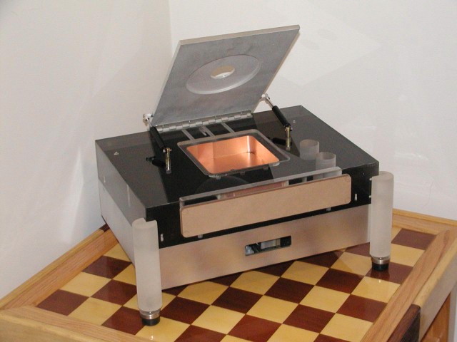

Here is a player that some of Brians boards are going in. It is getting nearer to completion, I have to finish the button panel, finish machining the top cover, anodizing and add the electronics.
The front legs will glow blue when the unit is powered up. The button panel will glow blue when the tubes for the output have warmed up and will glow read when the player is paused.
More pics under CDPRO at this link
