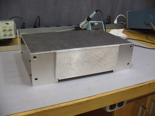

heh.. The case is going to be aluminum, and is a work in progress. The luxman will work for temporary buttons. I haven't found a more beautiful solution.
It is an LCD, and about 1/5 the price of a VFD.

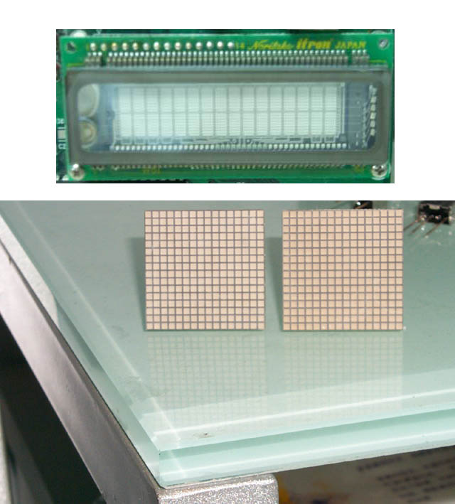

Which LCD are you using? Does it comply to either the SPI, or I2C interface? I also have a Noritake VFD. Here is a picture of it:
While the Noritake is more programable, I like the lcd, due to lesser power consumption and the 1/5 price. I also like that you can get it in different colors, which would require using filters on the VFD.
Brian
Good LCD module!
I like the LCD module! perfect!
high quality VFD module also good, but not easy get it with higt cost...(cost not mater in application,I think Noritaki is best choose of VFD module)
now, I have some sample (see picture,in application with filter-film),I think it is fit my application and low cost ( EMI and display quality,and size important to me ), but now, the problem is how to drive .any recommend or good idea?

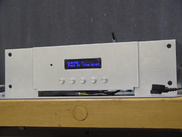

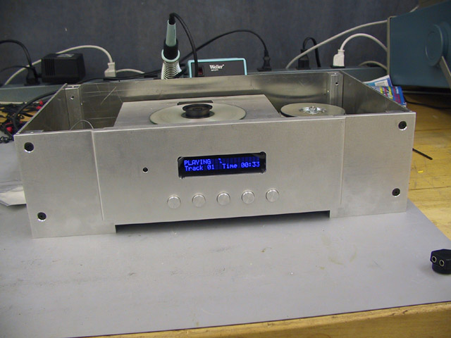

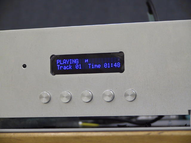

Here is a closeup of the front panel lcd. The hole on the left is the IR sensor, and the symbol after the PLAYING is a rotating graphic that moves when the cd is playing.
Note: the corners of the lcd window are not meant to be rounded outside, but there was some confusion in getting the hole milled, and there wasn't time to get it done again.
Brian
Brian

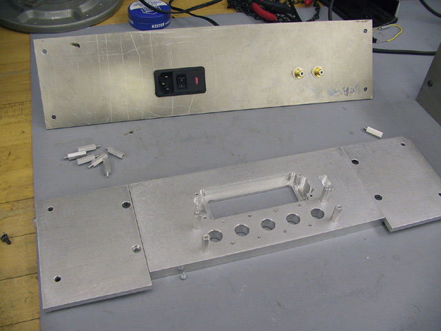

Here is one more shot of the front panel. The bottom corners of the front middle piece weren't originally going to be notched out, but a mistake was made on one side, so both sides were notched out.
The front middle part is 1/2" aluminum, and the sides are 1/4" aluminum. The middle part has a roundover on the edges.
Brian
Brian
