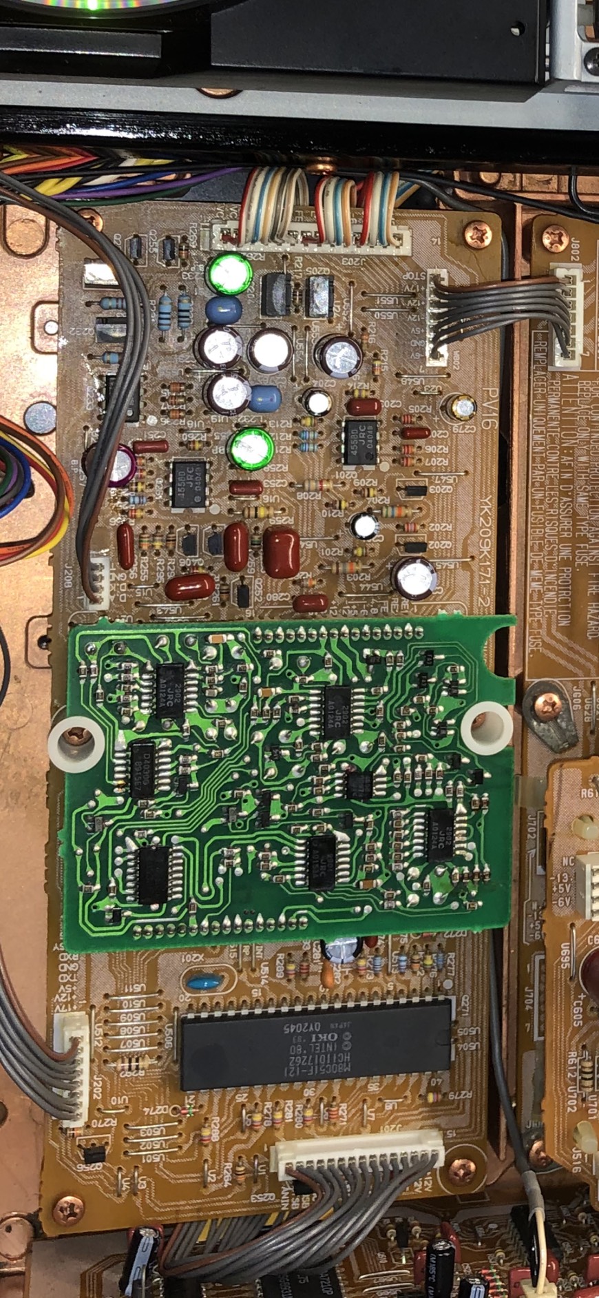

Please tell me, anyone has a marantz cd-94 95 99, adjust the laser power, measure the voltage of R309...A photo of the location of the circuit board...

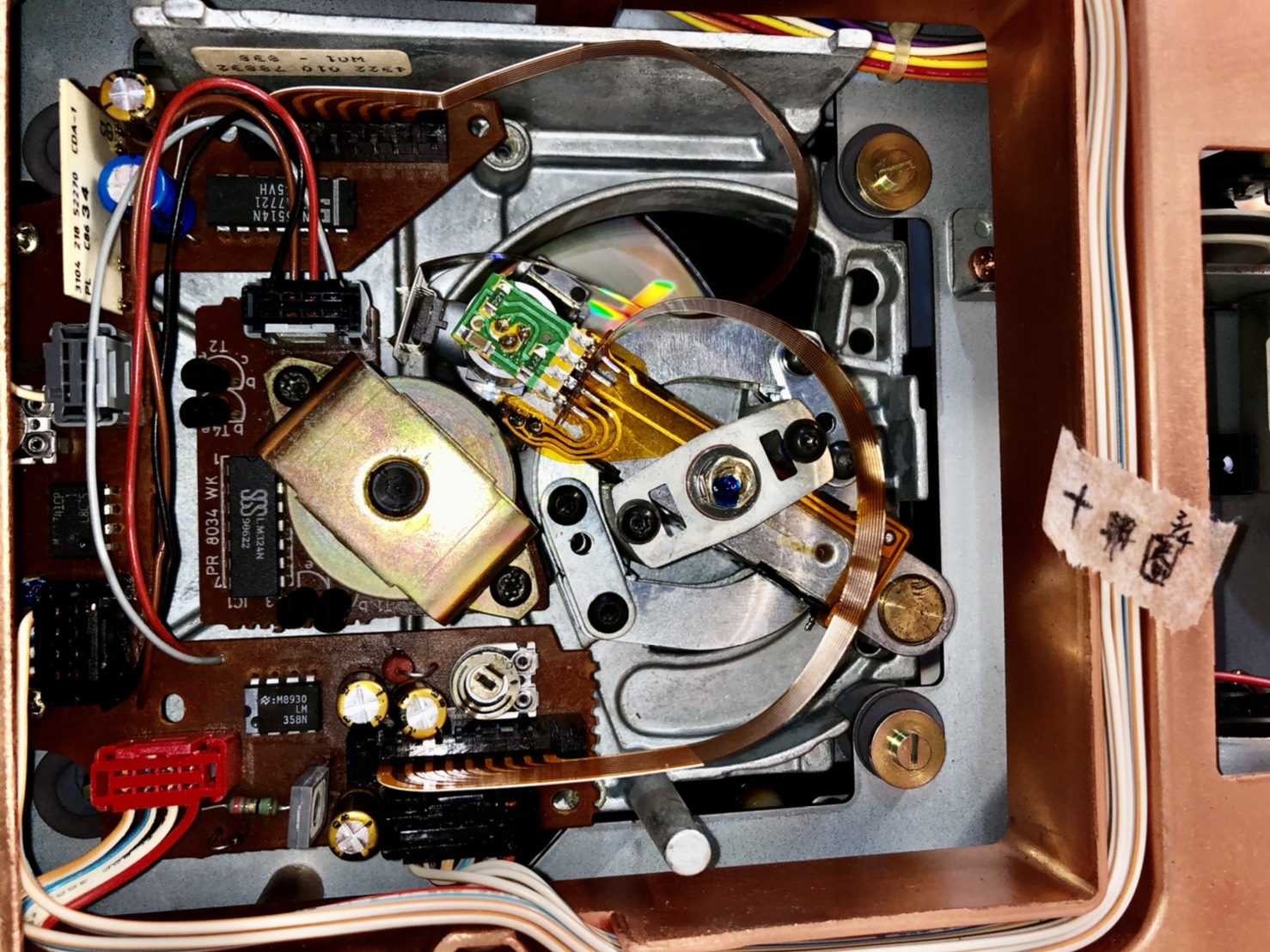

The laser power is adjusted by playing a test disc (or an average disc) by adjusting the resistor 3180 (or 3140) on the underside of the CDM-1, until the voltage across the resistor R309 is 575 +/- 75 mV. The variable resistor 3180 is 1k, located near the 8-wire flex cable going to the laser head.
You have to remove the bottom plate in order to access the CDM-1 PCB. I place the CD player onto a pile of books on the edges and use a mirror as a help for underside access. TBH I never had to do this adjustment.

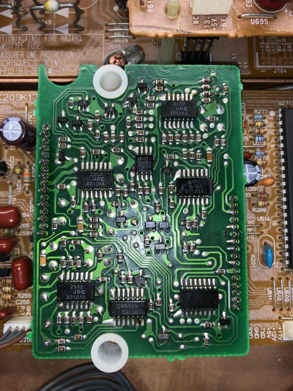

R309 is on the green Servo Board seen on your picture.

Something very confusing happened... The laser power is adjusted by playing a test discby adjusting the resistor 3180 on the underside of the CDM-1
The highest can only reach about 350mv
I don't know what else might be wrong??
