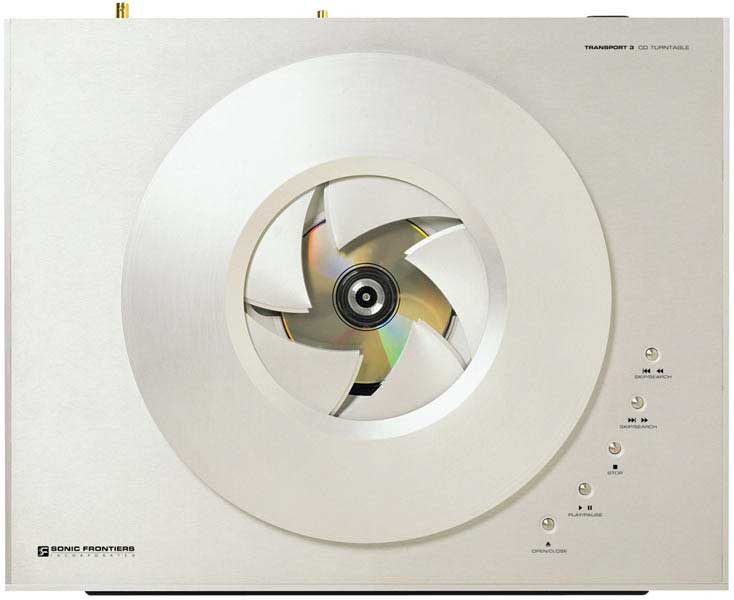

Thanks Audiofanatic!
Time to go to a diy-store and get a bit marble.
On Hawk Audio they say:
"The result of all the cutting, glueing and soldering job on the inside of this black box
is that we now have a CD-player which performs remarkably"
Does anybody know more or even has some pics what they "glued" in there?
This is my intention.
