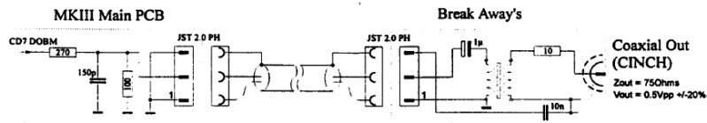

Are these the 270R, the 100R and the 150p we are talking about with this mod!?

About this resistor mod in the digital output:
I did remove the 2 parts as told and shortened the one resistor.
As i mentioned before i use my CD753 only as transport and this mod
definately makes the coaxial output sound worse, dirty sounding here!
I still don´t know what resistors these are and what they are doing.
The values are ~220 for the 3896 and ~160 for the 3897 in my circuit.
What brought a small benefit was removing the capacitor from the
coaxial plug to ground.
