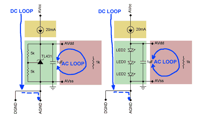

I do know how to set up a TL431 shunt, but to be honest, even after heavy digging I still do not know how to set up a LED shunt, as you proposed. Would you mind describing this a bit more in detail?
See attached pic below. Any element that has near-constant (ideally completely constant) voltage drop across it regardless of current through it can be used as a shunt element. That being said, in the real world, most of the effect is provided by a good capacitor accross it, while the semicondustor or vacuum shunt regulator provides the DC level.
In the pic attached, there are 2 versions of simple shunt regulation, the left one is with the TL431 shunt regulator chip, the right one with a series of LEDs. Keep in mind that actual component values are just representative, so in the real application should be tailored to the actual application - in particular the current source, and the capacitor(s). As drawn, the TL431 is set to 5V and the LED chain is 2x red and one IR LED, approximately 5.2V or so at the given current.
There are 3 parts to each verison, denoted by colored rectangles.
The reddish part is the actual load of the regulator, i.e. DAC, clock, OP-amp etc, which also includes it's own load (filter network, clock network, actual amplifier, respectively).
The green part is the shunt element itself - the one keeping th DC voltage constant regardless of current. In actuality, this action is not perfect, so voltage changes with the current, but the changes are very attenuated - in essence, it exhibits very low dynamic impedance. Also, a minimum and maximum current limit exists for each real element.
The yellowish part is the current source. In it's simplest form it can be a simple Idss connected JFET (gate to source directly conencted, and selected by resulting current according to need). A small damping resistor or even feritte bead inductor in series is a good idea to prevent HF coupling through the parasitic capacitance of the current source. The current source passes the same current regardless of the voltage across it, in theory. In actuality, the current varies very little with voltage changes. In essence, it exhibits very high dynamic impedance. Again, a minimum and maximum operating voltage exist for actual current sources.
Although it is not apaprent if one would look just at the schematics, this combination of elements forming a complete shunt regulator, is capable of separating the DC and AC current loops for the load and power supply.
Because the shunt element exhibits (idally vanishingly) low dynamic impedance, and is across the power supply pins that power whatever is supplying the signal to the load, so any load current has to appear across these pins as well, and current always passes through the path of least impedance, it will have to pass through the shunt element. Because 'dynamic impedance' literally means AC impedance, and these elements work to practically DC, all load current only stays withing the AC current loop as marked on the schematic.
In turn, because the current source is a very high dynamic impedance, any AC currents will not pass around the DC loop, which includes the actual power supply, pre regulation (Between AVcc and AGND). Of course, in reality, the current splits between the AC and DC current loops so there is always a residual of the AC current inside the DC current loop, but this residual is only as much as the ratio of dynamic impedances of the current source versus shunt element - the first being on the order of hundreds of kohms, and the second on the order of a few milliohms to a few ohms. So, the residual is a greatly attenuated version of the actual load current, or any current that appears between AVdd and AVss - easily 4-5 orders of magnitude if good layout and design is used.
It could be said that the DC current loop which is defined by the current source, only initially charges the capacitor in the shunt element until the semiconductor part limits the voltage on it. From there on, current is circulating around in the AC current loop, with the DC current loop only covering losses.
A non-obvious aside is that AC will not pass along a common path needed to connect all ground points, i.e. AGND and DGND, even if they are ultimately conencted to the same non-regulated power supply, and even if there are multiple paths. In reality, of course, the AC component will be strongly attenuated. (See dotted line in the DC current loop arrow). This means that if there is a common path for varius current returns, because the AC components in them are strongly attenuated, they have that much less chance to interfere with one-another and leak into power domains where they do not belong. The fact that they are creating a constant voltage drop (DC) across various ground paths is of little consequence as actual signals of interest are dynamic, and not static (of course, as long as voltage drops do not become excessive but then the device would not operate correctly in any sense anyway so this would be a fault rather than an imperfection).
Finally, most series regulators do not have this advantage, as they require some sort of capacitor at the input, which then connects the unregulated input via cap to the ground, alowing AC current from the unregulated input (due to ripple or nosie) into the local ground and from there along a ground return path to the unregulated source. In other words, now you gat an AC voltage drop along this path - or paths, which means that the ground reference will not be the same along the path, which in turn means that this AC component is in some amunt or form injected into various places in the circuit where it does not belong.
That being said, there are regulators that avoid this - the LM317/337 is one common example, but you have ti apply them carefully in this fashion. however, the concept is much more esily explained on shunt regulators as from the standpont of the unregulated supply, they look like a DC current sink, i.e. a two-pin element.

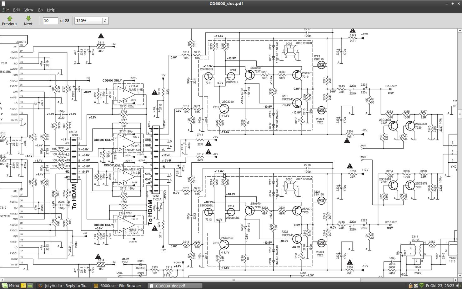

It's a bit unclear to me if you have the CD6000 or CD6000SE (se or balanced out). The schematic i put up is actually easily converted to a fully balanced output by addition of one more OP-amp or HDAM module.
Regarding tubes, it is actually easyer to do a simple balanced tube output than an unbalanced one, if the input to it is a balanced signal. For an unbalanced (se) output you need to implement a fully balanced circuit with both sides used as an output, but you take only one signal from one output, while you put a terminating ipedance equal to the output load on the unused outut of the tube stage. If that cannot be done, the tube stage gets more complicated as it needs followers on the output. The reason is that the load on the the output of the simple version needs to be equal on both sides or conencted between the outputs in order to equally infuluence both halves of the circuit, in particular the gain. If teh output load can be unbalanced, it has to be 'isolated' from the diff amplifier so that it does not influence it's operation, which complicates the circuit.

My player output is single ended, and adjacent equipment is SE as well. So the rebuilt player should be SE again. The circuit you posted - with the three opamps - seems to be perfect for me. My player has got three HDAMs per channel. In the pic I added, you can see circuit of CD6000. Instead of the shown 4 opamps my CD6000OSE has got the four HDAMs, I recently posted.
So if you consider these appropriated, I'd prefer to use these. Otherwise I would be able to find some opamps in my box. i.e. LM833, 2604, 627 (know, this one is just single opamp).
Also I would like to use tubes in the SE outputmode.
Means, I had to know the following impedance? A balanced buffer were needed to keep it constant? You had the follower as a buffer in mind, didn't you?

It should be perfectly fine to use the HDAMs instead of OPamps, as the HDAM is actually a discrete OPamp. You should be able to use the circuit I posted almost with no modification (save for the LO/RON and RO/LON dual connection via resistors to the first cap in the passive filter).
If you want to use OPamps instead, the best results I had were with FET input OPamps in the first stage, and bipolar in the second stage. I've tried a number of combinations and finally settled on AD712 in the first stage (one dual OPamp per channel) and LM833 (one op-amp per channel, so a single LM833 is shared across channels) for the second stage. A current sink forcing the LM833 into class A improved the sound subtly, to my ears.
Second best was LT1057 (if i am remembering my numbers correctly) in the first stage.
A number of people modifying CD63s have said that modern OPamps sound better than the HDAMs, but as the CD1020 does not have HDAMs, i did not have a chance to check this.
I will try to scale the filter components for larger caps when time permits...

Electrolytics can be left in place - in fact, MUST be left in place, in the sense that the capacitors should be as close as possible to the DAC pins. Even larger can be installed. The only difference is how long it takes for them to initially charge through the shunt regulator CCS.
The LEDs are not 'driving' them, just limiting voltage - hence shunting all further charge current once the voltage reaches the proper value. The current in turn is limited by the CCS, and should be at least 10x higher than the current used by the DAC, but also, within operational limits for the LEDs and transformer/pre-regulator, and CCS regarding heat generation. The capacitors themselves offer the closest and lowest impedance for the AC current component of the DAC/clock. If more than one is used in parallel, at least the smallest one should be as close as possible to the DAC chip pins, to keep the AC current loop as small as possible - see the CD63 mods thread, AVdd/AVss have been shunted by SMD chip caps directly on the DAC AVdd/AVcc chip pins to accomplish this, the SMD chip caps being the smallest of 2 or 3 caps that are all in parralel across AVdd/AVss. This keeps the highest frequency components inside the smallest possible loop where it cannot interfere with other things around it.
If you have done the analog output mod, you might want to try it out with the power supply as is, to check how it sounds, as a first step - then tweak that before proceeding (for instance change the 33-39k resistor thet fine-trims the final roll-off in the frequency characteristic of the filter at the highest point of the audio band).

Opamp draws 5mA, HDAM 15mA. Would it make sense to add the 6mA FET as shown in your circuit?
I'm really curious about the sound after having put in the LED shunts for XVSS and AVSS plus foil caps and SMD cap as suggested. Will do this next week.
Cheers Ernst
Well, from what I can read, it seems that the mods are giving results in the right direction.
Regarding HDAM-s and op-amps - HDAM works in class A (at least in theory) so no current sources are needed.
op-amps can be set into class A, usually by a current sink (to -V). Not all of them work well in that configuration, though older ones such as the 5532, 5534, LM833, AD712, LT1047 etc do - the reason is that older op-amps were not made using processes that are capable of making fully complementary transistors on the chip. As a result, the output follower is either quasi-complementary or complementary but with the PNP side (the one providing negative voltage swing) being markedly worse than the NPN side. In either case, providing an external current sink basically turns off the pull-to-negative (lower) side of the op-amp output (either completely or reducing it to a current sink). What is left is the better half, using a simple NPN follower.
Newer amps that rely on a fully complementary process might not work too good this way, often because disabling one side also tends to disable parts of internal compensation networks in some of them, and it's also not a given that the NPN side is better.
In any case, the current sink will make the most difference on the op-amp driving the output. It, in itself, is not a havy load for the previous stage OP-amps so ther outputs should not have problems, but again, it depends on the op-amp. You could hang current sinks off of the outputs of the first stage op-amps, but they do not need to be 6mA, 1mA should already be fine (of course, 6mA will keep the output in deep class A).
In the CD1020, I've used selected FETs connected as current sinks (essentially a two-terminal device), and jumpers to switch them on or off, so I could experiment with various conficurations. If you have the space to do it, this might be the best way to go.
Regarding the regulation of AVdd, this should make the most difference. Once it is set, you can tweak the cpas in parallel with the LEDs. The difference will not be great but it is audible - in particular, the selection of the large electrolytic cap (I am assuming you won't try some really bad quality no-name cap 🙂 ).
Regarding XVdd regulation, it will not make as much of a difference as it would if the internal oscillator was used, so I think you should give priority to regulating AVdd.
