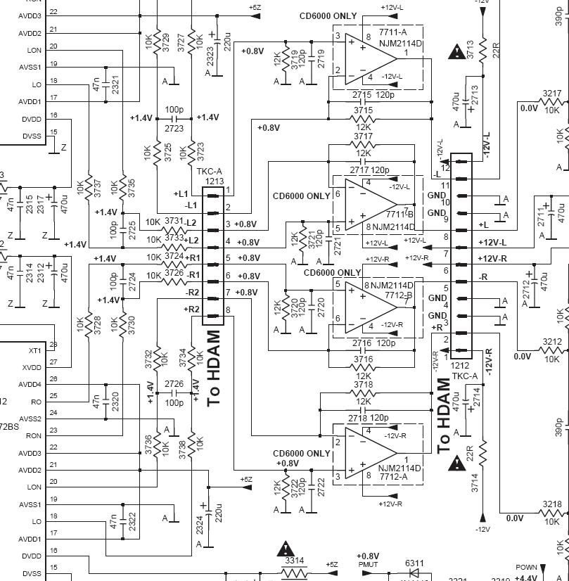

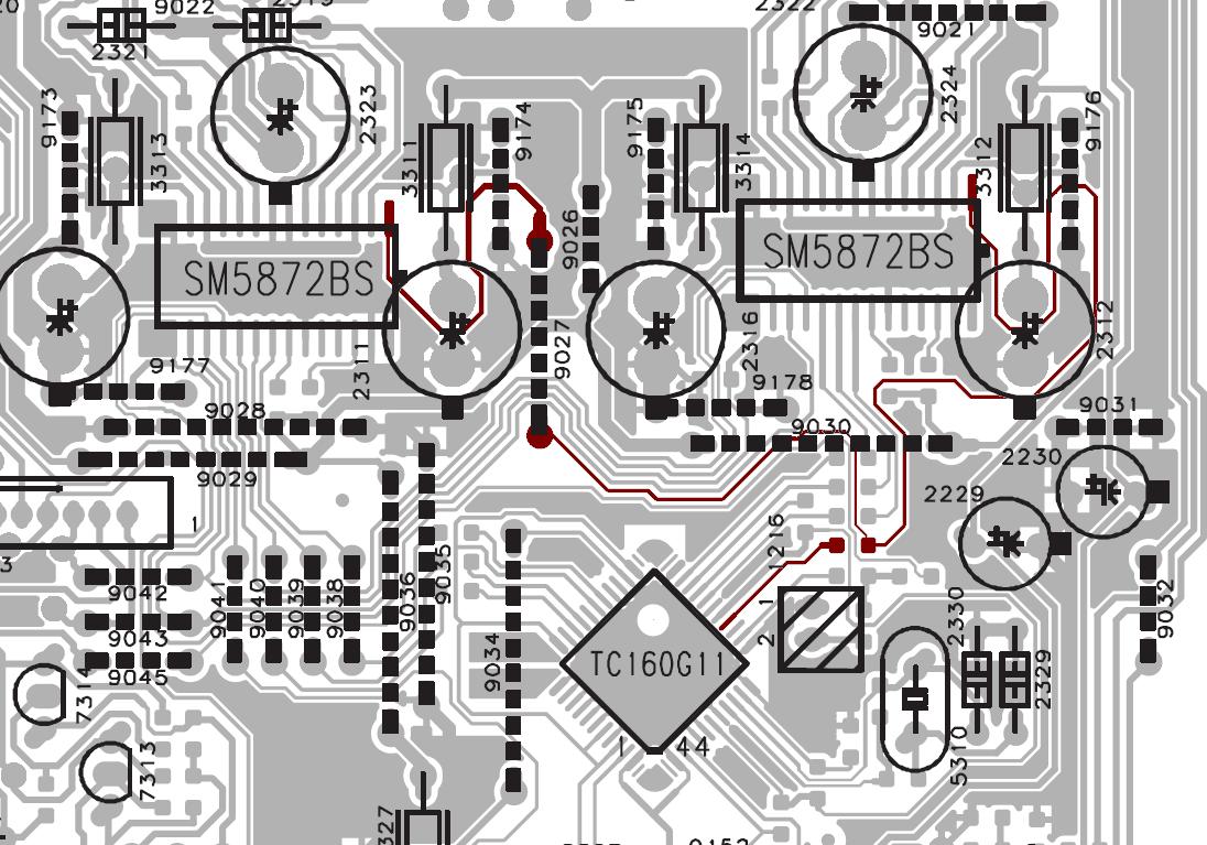

My main issue now is, that my player - unlike the easier tunable CD63/67 - has two DACs(SM5872BS) instead of one. Each of them is fed by the same integrated circuit, that modifies the I2S signal for each DAC (L/R flag and DATA content). Each DAC has four analogue outputs - normally: L+L-R+R- (two balanced channels) - here in this case one DAC has got 1L+, 2L+, 1L-, 2L-, the other has 1R+, 2R+, 1R-, 2R-. Now Marantz uses two differential buffers to get again two single balaced signals (L+L-R+R-). One more buffer (HDAM) module per side convert this signal into SE signals. So far so complicated. I hope this is understandable and right. Here the sheme:
So in my eyes I have a few options:
++ use just one of the positive outputs, i.e. 1L+ and 1R+ right off the DACs and add Thorstens tube stage.
++ use one balanced pair of each dac, add a transformer to make it SE and a tube stage

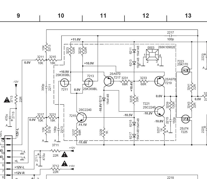

++ use the first part of the players HDAMs to summarize all the doubled channels and add a tube stage
++ build four differential tube stages followed by 2 balanced2 SE tube stage (6 double triodes)
++ deeply modify this player, deactivate one DAC, deactivate the separating IC (TC160G11AU) and feed the other DAC with an external clock and the I2S stream right out of the TDA 1302T (drive logic). As an analogue stage I'd use a tube like Thorstens one.
My questions now are:
?? Is my analysis of the circuit right?
?? Which of the options might be the best?
?? Which would be the best simple one?

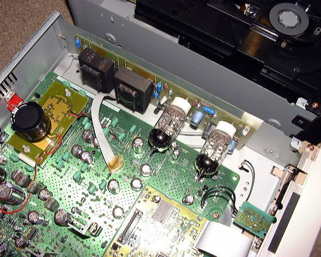

I found this on: http://www.marantzphilips.nl/review_marantz_cd6000_ose_le/
They explain:
Upgrades and Changes by Heart
Rik Stoet's Heart factory performs numerous modifications to the Marantz design. Most importantly in my opinion is that Heart disconnects the entire Marantz designed analog section (although it remains in the chassis) and substitutes a circuit using a pair of dual triode 6922 vacuum tubes. The pair is energized by two transformers, one powers the heaters, the other the anodes. The unit ends up with a total of 5 transformers, three for the power supply and 2 for the audio circuits. The printed circuit board is modified and relocated to reduce interference from the power supply.
The headphone jack has been disconnected to reduce the load on the audio section and increase performance. Additional Philips capacitors are installed in the high pass section. The transformer for 110-120 volt markets has been specially designed by Heart for use in those markets. Finally, additional damping to the chassis and transport has been added over and above that already installed by Marantz. Cosmetically, the only difference between the Marantz and the Heart unit is the addition of a small tasteful "Tubed by Heart" logo below the CD drawer.
Also I found this pic from the Heart CD6000:
There is no Opamp or HDAM visible. They route the signal out of the PCB far before the following opamp had been. And the added a clock.
I'd really like to know what they did precisely. 😕
Yes, you probably could do the same or something similar, if we found out.
By the way, which 1541 CDP have you tubed?
Cheers Ernst
Actually, the Heart 6000 is NOT entirely tube output. The signal taken from the SM5872 dac chips is voltage out, and therefore uses each dac chip's i/v converter opamp stages before going to the coupling transformers. The Heart guys did not take this into account, and thus did not add any extra filtering or HF bypassing to the analog supply lines to the SM5872's, which can make quite a difference. Personally, I have found, among the several Heart 6000's I've worked on and upgraded, a LOT of variability in sound quality, not attributable to the tubes. I had two Heart 6000's that had identical work done(including the same version, grey-cased transformers throughout), and, even with Dutch Amperex 6DJ8's installed, one sounded dismal & the other sounded quite nice. I did a lot of work on sorting out what was causing the difference, and either there's just a bad amount of variability in the coupling transformers, or there's a really unacceptable amount of batch variability in the SM5872 dac chips.

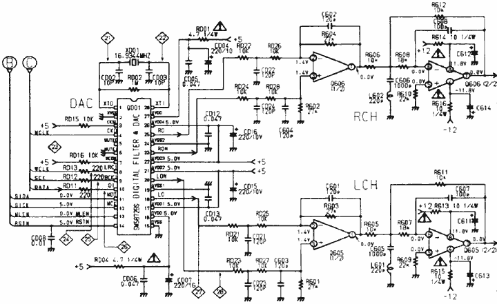

Yes I know, the SM5872 is a V-out DAC. Apparently it should be one of the better V-out types, referring to Thorsten Loesch, who wrote in his paper 'Thermionic Valvestages':
The generation before the latest designs is a bit more heterogeneous. We find many DAC’s with differential output but various different schemes of
on chip filtering and buffering and the occasional DAC with a single-ended output and really good on chip analogue silicon. In the latter case
(CS4328, certain OEM Products) the same as above holds true. For all other differential output DAC’s the circuit shown further down should/could
be used and should work under any conditions, offering good filtering and ensuring an easy load for the DAC Chip, keeping distortion low.
Finally, the original first-generation timeslicing DAC’s have no analogue stages. Some of these are early Philips chip’s as used in the QED "Digit"
external DAC, also the NPC SM5872 (Marantz CD-53/57/63/67 among others) and NPC SM5864 (Arcam Alpha - lower Models) and surprisingly
many OEM chips even in current use. All these will require some buffering and due to the lack of on chip filtering a direct connection without any
additional lowpass filtering a direct connection even to high impedance inputs is not advisable. Again, the circuit shown below will work just fine.

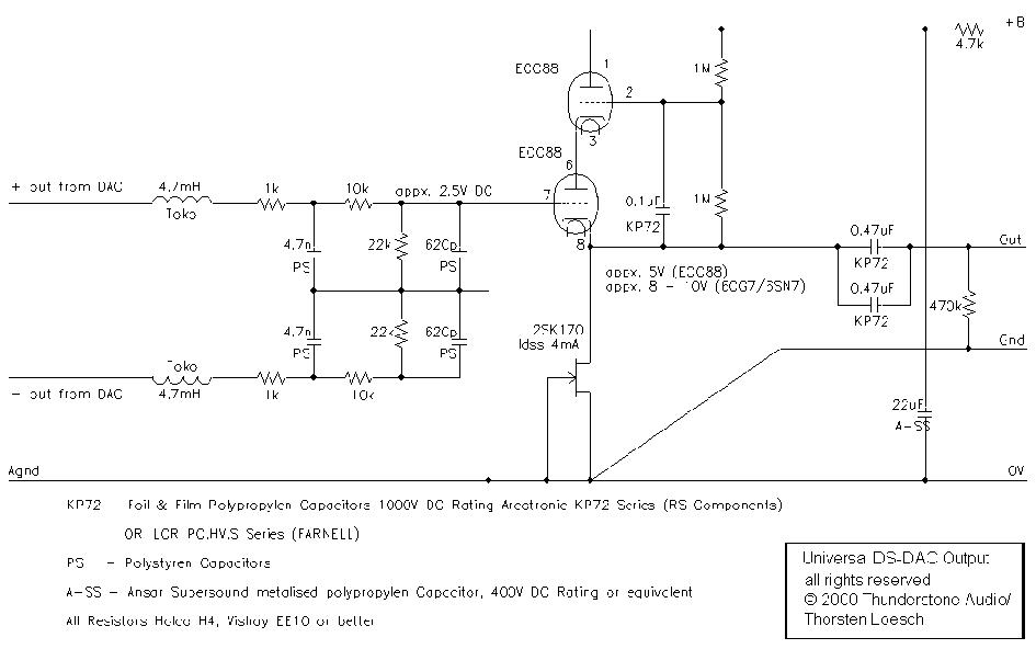

That’s why I started thinking about adding tubes to this player. Thorstens circuit includes filtering and puts load to the balanced signal too, although this signal is not used by the following stage. Almost perfect, if there wouldn't be the second channel per DAC.
You'd probably know, which outputs (of the 4 per DAC (2 pos and 2 neg )) the Heart guys used to feed the transformer with. It would be great if I could get this info. This would help me deciding how to move on.

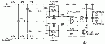

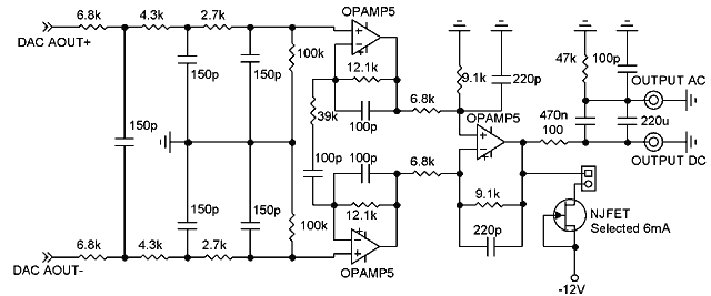

I never got a schematic for the 6000 series, nor do I currently have one of the players on hand, but, as I recall, the 5872's were connected much like Pioneer does with their PD65/75 level 'pulseflow' stereo dacs, where they sum R+ & L+ via some small value resistors, and do likewise with the negative outs. This would certainly make sense with the 5872, given what Loesch says about output current(implies, at least) on these. BTW, the datasheet for the SM5872(which I googled easily) DOES show analog buffer(at least) stages before the chip's outputs, and I definitely can attest to the benefit of being very generous with the size & quality of supply caps next to the analog supply line pins.
As you may guess, I believe one must first find a 6000 that actually sounds OK to start with, as the dismal sounding ones tend to retain some of that no matter what upgrades one does to them.

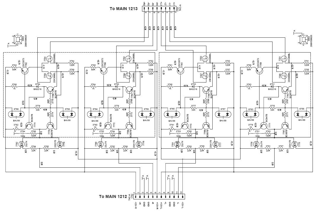

SM5872 requires external subtractio of the DAC+ and DAC- outputs:
DACOUT=(DAC+)-(DAC-).
If differential out is to be preserved, you must do this twice:
DACOUT+=(DAC+)-(DAC-)
DACOUT-=(DAC-)-(DAC+)
The reason this operation must be done to gt the full DAC performance is twofold:
Firstly, the DAC outputs are 'quasi-differential' - this is the term used in the data sheet. The outputs are pulses 0 to 12 MCLK cycles in length occuring every 12 MCLK cycles (0% to 100% duty cycle, at 32FS). Odd lengths of pulses (1, 3, 5, etc) cannot be symetrically centered around the middle of each 12-pulse PWM modulation cycle, so if something is not done about that, each odd length PWM pulse is 1 MCLK cycle out of phase - i.e. a 1 MCLK cycle jitter correlated with the output level is generated. To prevent this, the DAC+ and DAC- outputs are out of phase by 1 cycle for odd length combinations, and recreating a single ended pulse from these results in a 'halftoned' pulse which is centered around the midde of each 12 MCLK PWM modulation cycle, preventing the introduction of jitter. Becasue this jitter is introduced at the low resolution end of the sigma-delta DAC, the noise and distortion generated when only one of the differential outputs is used, without subtraction, is very high (and very audible).
Secondly, becuase the rate of PWM pulses is quite low (32Fs, whereas 64, 96, 128 or 192 Fs or even higher is more common), it appears that quite deep dithering/noise shaping is used to get adequate performance. Based on measuring peak values of the signal at the DAC+ and DAC- outputs, vs RMS post filtering, it appears that as many as 4 levels out of the 13 possible PWM output levels can contain residual quantizing noise.
Even though this is pushed higher in the spectrum by noise shaping, the low rate of PWM pulses means the rise of the noise floor is noticeable while still inside the audio band, rising as you go to the high end of it. In order to considerably reduce this problem, the noise shaping is actually common mode across DAC+ and DAC- outputs, and some care was obviously taken to prevent colision of this scheme with the quasi-differential out-of phase PWM trick described above. When only one DAC output is used without subtraction, the noise is clearly audible for a digital zero at the DAC input (this largely prevents jitter artifacts described in the previous paragraph from appearing as added noise). When proper subtraction is used, the DAC stays dead silent within the audio band.
In other words, if you only use one output, you get a large loss in resolution, a large increase in residual noise and an even larger introduction of jitter - 1 MCLK correlated jitter in most implementations means 59ns peak to peak jitter, compare this with picosecond speciffications on MCLK source clocks needed to get the most out of the DAC. So, with all respect to Thorsten, the above schematic is NOT recommended for this particular DAC, even though it is electrically correct.

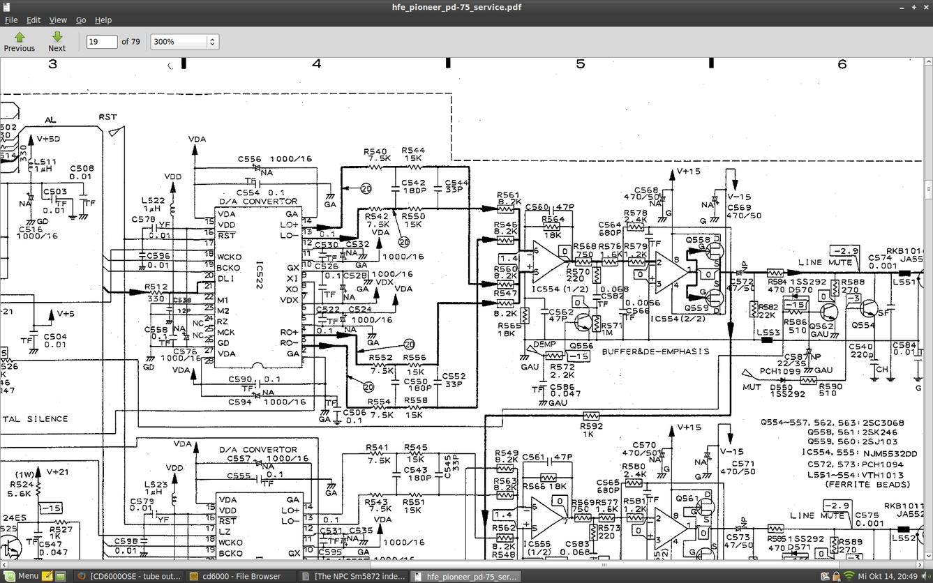

If you ever needed, I could support you with the manual, showing the scheme.I never got a schematic for the 6000 series, nor do I currently have one of the players on hand
Interesting Idea - I'll look after the manual.but, as I recall, the 5872's were connected much like Pioneer does with their PD65/75 level 'pulseflow' stereo dacs, where they sum R+ & L+ via some small value resistors, and do likewise with the negative outs.
Really strange but might be that way. After my early mods, good rectifiers - very good electrolytics - removed output elkos - removed mute transistors, slight damping of the chassis most people (the normal ones, not addicted onesBTW, the datasheet for the SM5872(which I googled easily) DOES show analog buffer(at least) stages before the chip's outputs, and I definitely can attest to the benefit of being very generous with the size & quality of supply caps next to the analog supply line pins.
I thought about doing that, but never did so far. Good advice, thanks - will do since it is a rather easy mod.Hi guys, I don't know much about valve output for the cd6000, but in my experience, adding a really good, low-noise reg to power the dacs and separator chip is the only way I managed to remove the ragged treble sound, and this was after clocking too. There's a 7805 reg on the board that does the job already, but with a really good reg in there, the difference is amazing. I've done this mod two or three times now to different cd6000's.

So does this mean that best I leave the outputsage, as it is or, if I wanted a tubed one, I have to build right in the way the current silicium one is?
Thanks a lot. Even I have to think about that hard, I already have learned a lot.

I meant SM5872 built in clock oscillator. This is not used in your player. The TC160G11AU is a mask programmable gate array chip made by Toshiba. It's function is determined by the last metalisation mask in the manufacturing process - you can think of it as a one-time programmable FPGA. The data separation logic is implemented in it.
It also distributes the clock - the oscillator is elsewhere (can't see it in the jpeg...). According to SM5872 specs, external clock is fed into the XTAL input pin, if I remember correctly. The clock that then ends up distributed to the internals of the SM5872 should be visible on the XTAL out pin - a good pointer of it's quality should be the shape of the clock pulses as observed with a good scope and probe. It is still highly recomended that the XVss and XVdd pins be fed with a clean supply because the clock signal still passes through the SM5872 clock buffer circuitry - the power for this is supplied by XVdd, ground by XVss. Any garbage present here will of course result in added jitter to the internal SM5872 clock.
Ilimzn, I think, the oscillator is close to the TC160G11, on the right side of the IC. There is a quarz, 16.xxx MHz, part 5310, there are 2 Caps pasts 2329 and 2330. The brown traces in my jpg (in last) post then lead to the DACs and end in XTI. Teh XTO is floating. So they are supported as there were an external clock. Just for info. Probably best would be adding an external clock that goes directly to separator chip and to both of the DACs.
Before you do that, check that the clock on the XTAL pins and the clock outputs to the SM5872 are not inverted. I don't think the gate array uses the full 384Fs clock directly in any way, but it is worth checking just in case. If it turns out you need an inverter for one of these clocks (to the gate array OR SM5872), feed the clock directly to the SM5872, and use one of it's XTO outputs to feed the gate array, or an external inverter to feed the gate array. in any case, make sure the clock to the DAC is the most direct one with no active components inbetween to prevent adding any jitter.

BTW, here are two pics of the two stages. First shows the first stage for both channels (at least in the CD6000 - the CD6000OSE has got for HDAM ircuits instead - pic 3) and from the second stage only one channel.
From what I can see, the CD6000(SE) drive the DACs in differential mode, meaning the left output is an inverted version of the right output. The gate array therefore gives each DAC the true data on one channel and the same data but inverted on the other. It is again surprising they did not do resistive summation in the filter itself, like I mentioned in my previous post, they could have saved themselves a fair number of passive components, lowered the nosie and use the existing OP-amps and HDAM to create a completely differential architecture. The good news is, you could do this yourself externally, probably even on the same board with some coponent relocations etc. I will try to find my solution for this for the CD63, whichis actually applicable nearly as-is, with the difference that the third op-amp per channel is in your case the HDAM module - but t hey are using it as such anyway.

Still, your player uses the data separator to drive the SM5872 in differential mode. The surprising thing to me is that they did not simplify the output filter - using one instead of two (one for each DAC output). This is still doable even with OPamps, and I think it should be done - it reduces the impedances, and speciffically the number of components in a passive filter, which is nice because you want to use at least premium caps in it (silver mica, polystirene), saving you half the money for this, or alowing for better components. I'll try to do a simple schematic in the coming days for you. Still, this approach requires the final diff to single-ended conversion - either by the HDAM, or, by a tube.
In case a tube is used, you would need a true tube differential amp, with CCS in the cathodes etc. The trouble is, the DAC generates a really high output voltage - about 1.1Vrms if you look at each output as single ended. Normally this is treated as 2.2VRms differential and converted to 2Vrms single ended, the standrard CD out voltage.
Using a tube differential output makes it quite difficult to make a diff stage with an amplification factor of 1 - for starters you use a low mu tube (but high current). Still, you are likely to run into amplification factors of about 4-5 or so single ended and 5-10 differential.
There are a few strategies you could use to get around this:
- attenuate the output at the DAC. As usual, attenutaion followed by amplification results in a higher noise floor, as there are components whose noise does not get attenuated but it does get amplified.
- attenuate the output of the tube stage. This will normally have the form of a divider incorporated into anode resistors of the tube diff stage. It has the advantage of lowering output impedance, and if any added noise is generated by the curcuit, it is also attenuated. It also keeps the system feedback-free if this is important to you.
- use feedback. The diff amp becomes similar to a differential arrangement of anode followers, and looks similar to Nelson Pass' supersymetry circuits. The output impedance is lowered, tube tolerances mitigated by feedback, BUT it is difficult to balance the frequency characteristics of the diff amp sides if only one output is used (coupling caps introduce low frequency poles and zeros). Also, important, at power up, the high anode voltage (before tubes heat up) can leak back into the DAC through the feedback and destroy the chip, so you need to take measures against it (protection diodes etc).
Keep in mind that DC offset is not a problem as it's common mode for the diff stage, in fact it gives you a slightly larger choice of tubes (you still need a negative supply fot he CCS). THe tubed stage has the advantage of presenting a very linear imput impedance, with a fairly well defined capacitance, which will minimize it's interference with the filter caps. The double drive from the two DAC outputs considerably helps in using lower impedances in the filter. Miller capacitance will not be a big issue but it will actually make the tube stage be another LP filter stage, and in this case it's actually useful.
You will notice that in your player they actually use parts of the filter as a divider to lower the voltage. This is not an ideal situation as it introduces a DC bias to the current out of the DAC, but only from AVdd to AGND. This results in asymetrical rise and fall times from the DAC output stage affecting it's linearity. Fortunately, in your case I believe it can be avoided because of the differential use of the DAC. As I said, it's very odd to me that they just basically did several copies of the basically CD63 circuits, instead of taking advantage of the actual topology.
If it's the same as the CD63 approach, because of the relatively low PWM fundamental frequency, the output filter had to use a relatively low corner frequency which means it slightly infringes into the top of the audio band. In the CD63 they used an LC correction network to mittigate this. As you may expect, I do not like the use of any cored inductor anywhere, and preferably no inductor at all, and they used a low cost one that looks like a resistor. Using the propper diff to se converter, it is not necesary. I don't see it in the schematics you posted, though, but I have not analyzed and simulated the filter to check it's passband, as time is short. Hopefully they use a better approach. In my mod of the CD1020, it was a relatively simple matter to change this correction (using a single cap and resistor), and I have found that differences as small as 0.1dB had impact on the percieved sonic balance of the player. As is always the case here, it comes down to personal preference. Also, the final choice of OPamps was surprising - the old well known ones (AD712, LM833) proved better than the new ones, probably due to the PCB not alowing adequate HF decoupling for the new fast OPamps.
Here are some schematics I found from the CD1020 mod project.
The first is the original output stage as in the CD43/53/63 (without the HDAM module which comes after the OPamps, in yours it's used in a much better fashion). Note similarity of the first OPamp stage with each of the OPamps in your layer immediately after the DAC output pairs.
The second in the modified version with largely passive filtering (note that the 100pF caps around OPamp feedbacks introduce another filter order but the turnover frequency is much higher improving HF rejection but keeping phase changes out of the top of the audio band).
A few words about this filter arrangement:
The DAC AOUT+ and AOUT- are actually the LO and LON, RO and RON pins respectively - as only one filter channel is shown. As I mentioned before, the first stage of the filter is differentially connected to keep the HF on the output of the DAC chip confined inside a vary small current loop adjecent to the DAC.
The 100k resistors from OPamp + inputs to GND adjust the output level so that the output is approx. 2Vrms.
The first two OPamps form a buffer, which also introduces a small amount of amplification at the very top of the audio band, in order to compensate for the 0.25dB roll-off at 20kHz introduced by the passive filter stages. The 39k/100p combo acts as a shelving filter which is counteracted at higher frequencies (above audio band) by the 100pF caps in the feedback path of the OPamps. The result is that the roll-off at 20k is very small, below 0.1dB. Tweaking the 39k resistor (between 36 and 47k) rises and lowers the response producing about +-0.15dB around flat response at 20k. You may adjust this to taste, the differences are subtle but unmistakeable. These two OPamps serve to present exactly the same load impedance for the passive filter network - 100k.
The final OPamp is a differential to single ended converter, also rolled off by the 220p caps. The different impedances presented by the + and - differential inputs to this circuit no longer present a problem at this point because the passive filter signals are already buffered here.
The JFET with jumper is used to force the OPamp outpit into class A, when the jumper is installed - the JFET acts as a current sink.

For starters, the HDAM module can be configured to perform the role of the final OPamp - it is configured similairly in stock form.
Since your player has one 2-channel DAC per output channel, the first stage passive filter resistors (2x6.8k) will be connected differently.
In the simplest form, there are actually two DAC AOUT+ and DAC AOUT- points in your player. These would be LO, RON and RO, LON respectively. each pair should connect to the differential 150p cap by it's own resistor with a vaule of 2x6.8k = 13.4k. In this way the outputs are resistively added keeping the equivalent impedance to the differential 150p cap the same.
A better solution would be to scale the filter components for even lower impedance values because connecting two pairs of DAC outputs to form one differential pair gives us the ability to source twice the current from the DAC. Actual standard resistor and cap values will not permit a simple halving of resistors and doubling of caps (unless you really want to use a pair of resistors and caps in parallel for each of the passive filter caps and resistors as shown in the schematic), so you must compromise some - and in the direction of higher than half resistor values. Say, scale the 150p caps into 270p, and scale all the resistors by multiplying with 150/270. The lowering of impedances will lower noise generated by input current noise from bipolar input OPamps if such are used in the first stage. Not lowering the impedances to their minimum values alowes the DAC to work into a higher apparent load per output pin, improving it's linearity, while retaining the virtues of lower input impedances as seen from the OPamp inputs.
Increasing the caps is particulairly beneficial should you ultimately install a tube output stage - as it's miller capacitance will then appear that much smaller compared to filter capacitances, and that much less impact the filter characteristic.
In case you decide to use a tube output stage, you can sonstruct is a true diff amp (as I discussed earlyer), in which case it can replace all of the OPamp circuitry. I will try to do a quick schematic of the idea (including how to implemet the shelving filter compensation ofor HF droop) as soon as I have some time.
The two pairs of outputs present on the CD1020 (the regular CD43/53/63 have only one) are used as DC and AC coupled outputs. The reason for this is that the mod alowes for changeing of OPamps, so depending on the type used some DC offset may result. In reality it always ended up being up to about 5mV which should not make problems - I've used this with a fully DC coupled amp.
The purpose fot he mod, amongst other things, was to be able to evaluate different OPamps, so sockets were provided (using separate pins installed directly into the PCB for absolutely shortest signal path and best signal integrity). Generally, the best results were obtained with FET input OPamps in the first stage and a bipolar input OPamp as the final amp.
In your case, the requirements differ somewhat.
