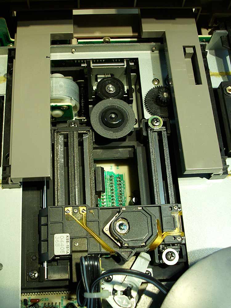

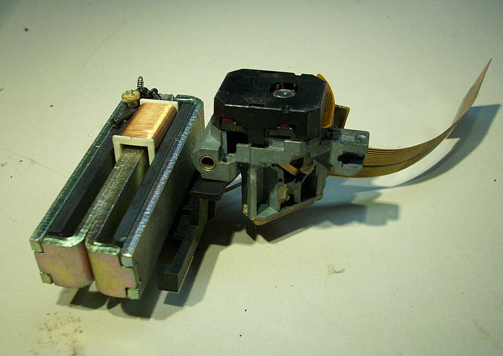

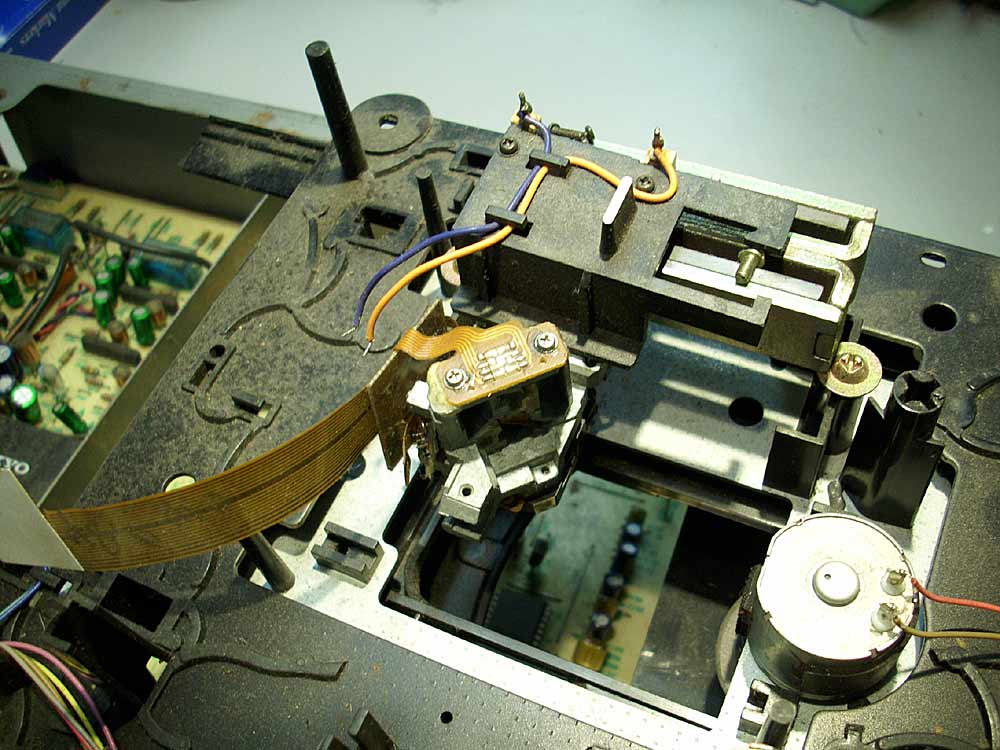

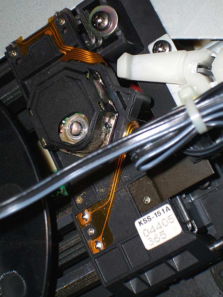

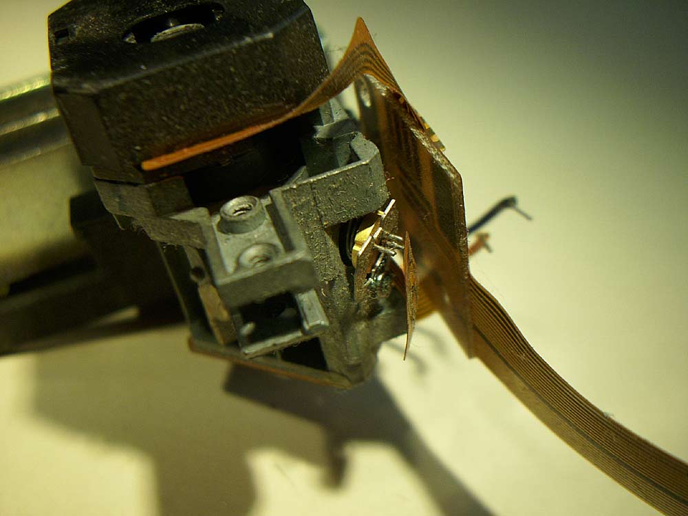

This is a bit hard to see but this is what the underside of the transport assembly looks like with the laser sled and laser head plopped back into place... sitting on top of the main chassis...
The dirt is from sitting out for a few years under a bench and feeling hopeless. There is another one that is all together, awaiting resurrection.

i think beyond trying to understand how the laser diode works ... and then replace the diode ... you will need to know also how the rest of the oprtical system works ...
on the onkyo case it seems to me by the condition of the device that the laser diode might be in perfect condition .... though if the lens inside ( not the outer ....the inner prism ) is dirty then no laser diode will make it work .... dirt is more serious trouble to an optical device than laser diode warn ....
inside there is almost impossible to clean ..... at least so many times i try it never worked again ....
as about the kss 151 its comonly available here in greece since its working also in the very popular cd player TEAC VRDS 10 it might be still available in your local TEAc shop ...
as about the onkyo ....rings a far away bell ....it seems to me that ive seen it before but cant remember where ....

Do not be concerned about the condition of that Onkyo!
I took it apart to investigate some years back. I have a complete one that is all clean and together. The problem on both is the same, it has gone "blind" and no longer reads the disc, as most do, they start by skipping and then not reading some discs, finally not reading most discs... So that one is just to see what was inside. Don't worry, I could clean it perfectly, but I don't need to.

I looked at some CDR computer transports that were "extra" and found that they are epoxying in the Laser Diodes these days...
I was hoping I would have been able to pull one of them. That was a few years ago... fyi. The nice part of the Onkyo's construction is that it isn't epoxied in place.
I was able to check the Esoteric transport using my digital camera, it saw the laser light up no problem. Still doesn't read properly.
It looks to my eye that Sony is using the same "head" assembly with different side boards with different pinouts and headers for different models (the transport part is different, but so what) ... so I may order up a few inexpensive Sony replacements and have a go at it that way.

actually very easy the kss151 is comonly available in greece after all and was easy to locate by the first phonecall ...it will cost the astronomical figure of 18 euros
two things bother me though one that the prize is actually too low which might mean that the product is not really a good quality thing ....( the importer say that is excelent quality )
the second thing is that kss 151 comes in two types one with 17 pins and the other with 18 ( if i remember correct ) so you need to let me know what do you want and i can ship it for you ....

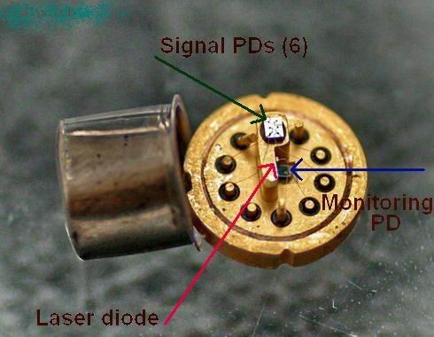

bear said:
When you say "external signal photodiodes" what are your referring to?
These are the photodiodes marked as A, B, C,... on the schematic. I called them external since they're not housed in the same package as the LD. In this case the optical path might be changed/obstructed in some way...
I hope I'm not confusing you, here is a case where the signal photodiodes are inside the same package. Sorry for the quality...
