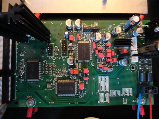

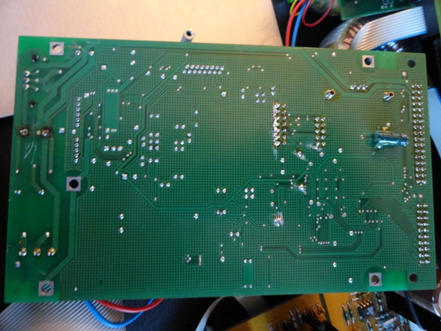

CD reading probs for Berendsen cdp1
Hi SS,
Gladly! Hope they view well:
Murf
Can't tell a lot from the available photo resolution, but I'm concerned about what looks like heat damage around the leads of that big 4700uf/16v through-hole cap. Can't tell if it's from repeated resolder/desolder attempts, or if the cap is getting that hot, which it darn well shouldn't. If it does get hot, it should be replaced. Can't see much else, except that the chips are, surprisingly, Samsung, and the servo chip is, indeed, of the "auto calibrating" type, likely a clone of the Philips. Assuming that replacing that one cap doesn't fix it, and no service info can be found, I would do two things. First, I would resolder all three of the large qfp chips & the other chip under the heatsink. Second, I would replace ALL of the electrolytic caps on the board. I'd use through-hole Nichicon caps with leads cut & formed, as I still don't trust smd lytics. If you don't have soldering "tweezers", I've found the best way to remove smd lytics is to use two soldering irons, to heat both leads at once, flipping the cap off the board once both sides are melted. If these steps don't fix it, it might be hosed. You could see if you can find datasheets for those three big chips online, which could help narrow down the locale for the fault.
