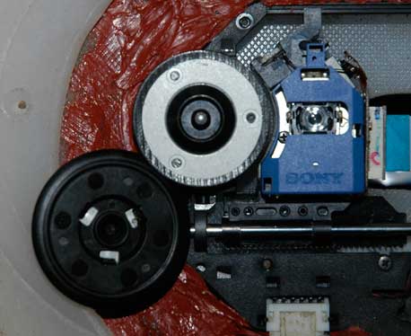

wait a second ! you said :
I took off the plastic crossmember that goes across the transport tray & holds the magnet disc which would sit atop the cd & mates with the drive spindle when playing . With this removed, all CDs play, even CD-Rs! If I put it back on, even without tightening the screws down, no play.
and:
Now the cd tray won't stay closed with the top magnet off of the spindle. The machine with the magnet on is now reading only redbook, no cdr's at all.
So, maybe you can investigate deeper the symptomes.
1. remove the plastic bridge that holds the puck
2. dissassemble the puck by turning it anti clockwise, easy there's just some glue
3. reassemble the puck (3 parts)
4. remove the draw, and pay attention to the switch that it activates when closed
5. put a tape or something else to keep the switch as in closed draw position
Now, try again to see if you are back to the first post events. Probably no improvement, but never know...
a pic to show you the puck, and good luck
