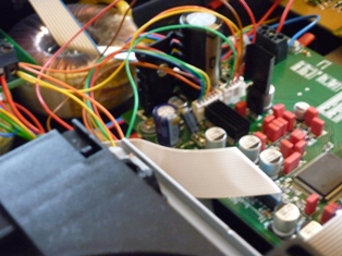

Hi Mooly,
The machine is pretty much the same as a GamuT, if that helps. DAC is a Crystal cs4290, laser pickup is an 'OPC-A15', I can't find any ID for the transport, on the web but it has #s GM9350, & what I figure to be the control board has Samsung chips, but no adjustment pots.
Thanks, Murf

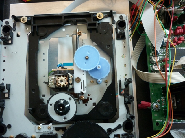

Looks like a Sony loading mech, but pickup # doesn't coincide. A photo with tray open & clamping support removed would help. From description, sounds like it's possible, assuming not a weirdly bad platter motor, that the probable cause is that a "press-fit" platter has slipped on the motor shaft, giving wrong focus distance. Generally, if you roll the laser to innermost position, the bottom edge of platter is usually about 1mm or so above the top of the laser plastic cover, so that cd surface is 2-3mm above lens. Just ballpark figures there, but an easy check to make.
Not at all sure, but I would guess that it is a Samsung laser(seems supported by presence of Samsung chips), very much in imitation of a Sony KSS213 type laser(though unlikely a drop-in replacement) and it's mech. The loader is a dead ringer for a Sony mech, if it's not the real thing. However, I can't at the moment think of another likely cause for the symptoms you are experiencing.
I can't come up with much either I'm afraid.
A scope check of the RF signal is really what is required as it reveals so much.
Could it be a weak spindle motor ? as it played without the weight of the clamp (if thats what you mean). A trick that sometimes works if only to prove something is to apply a 9 volts battery across the motor for a few seconds to "burn" and clean off dirt on the commutator. If you try that you must isolate the motor electrically first.

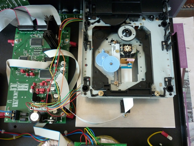

It seems my laser does work. BUT, it is not reading CD-Rs, and it looks like the previous owner had adjusted the laser power up. The control board (?) has no adjustment pots, so I figure this stuff is working well. The laser pickup goes in & out, up & down.

I think all you can do is try another pickup but without detailed scope checks it is a guess in the dark.
CDR's vary enormously in how "good" the recovered signal is and are dependant on discs and the CDR burner used... again the scope confirms what is actually happening.
You need to ID the pickup too.
