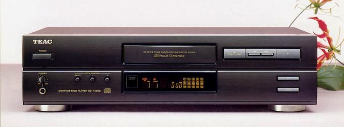

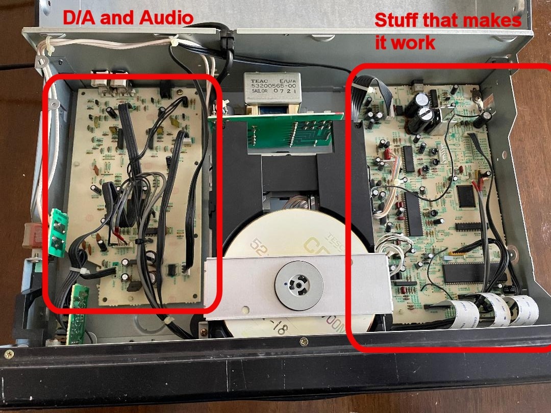

Teac CD-P4500 acquired seems to be a CD-5 with sensible case (and a daft pitch control) which is nice 🙂
The board numbers almost tally Audio board is 9155110201 vs the CD-5's 9155101202, Servo board is the same
Andy

It's sadly without numerical buttons so you can't directly chose track before you find your remote if that even have them. They sadly started to this feature in the late 80ies. -Backwards evolution.

A BITIt is a bit bland.
There is nothing to commend it visually whatsoever - like 1001 other players of that vintage. It's fun that it seems to be a 'Blanded' CD5 though and at £40 rather than £400 I'll take it. The CD5 has an "aesthetic" 😎
I am not a fan of Bitstream, or at least I never found one I really liked. That's the point of this thread you could remove the whole D/A board and still it works!
Andy
