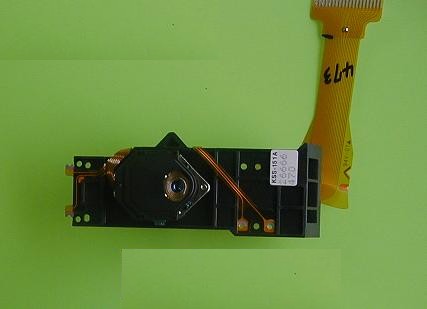

If my book is correct, the laserunit is a KSS151A.
Let me be honest with you, this is not the kind of laserunit to replace yourself if you're not used to work on machines like this. IIRC there's some fine soldering work to do.
Try to find a decent service center and ask the price first.
All this of course assuming you are not used to do this job.
Which doesn't mean you could see it as a project and learn a lot...
/Hugo 🙂

Did you consider:
one of the 4 rubber suspensions of the transport could be broken.
defective tracking electronics
bad tracking adjustment
buy a working DCD1500 / mkII on eBay and change the laser
If the flat cable is the same there is no soldering.
