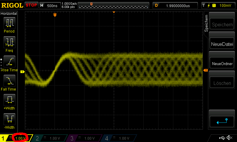

Just checked the RF eye pattern of my Arcam 170 transport with my €400 Rigol DS1045Z, see attached screen shot:
Sorry for being OT, but looking at my scope shot from #16 again the RF eye pattern has around 1.9Vpp. The transport works very well, but the service manual of both the Arcam 170 and the CDM1-MK2 (i.e. CDM4) says it should read up to 1.2Vpp. I searched the forum and found this post, so I checked everything mentioned there but the 1.9Vpp didn't change at all. Everything is resoldered and recapped, I even replaced the RAFOC unit. Is it a problem to have too much RF eye pattern amplitude?
Have you checked the RF the old fashioned way by manually setting the scope to say 1 volt/div (or 0.1/div with a divider probe). Also if using a divider probe (and you should for this) you must calibrate the probe correctly using the scope CAL output as the setting will affect the apparent amplitude of a displayed signal like this.
To much RF implies the laser is being overdriven and that is really the main issue but it can also saturate the photodiode array and lead to 'crushing' of the signal and deterioration of the all important diamond shape in the RF.

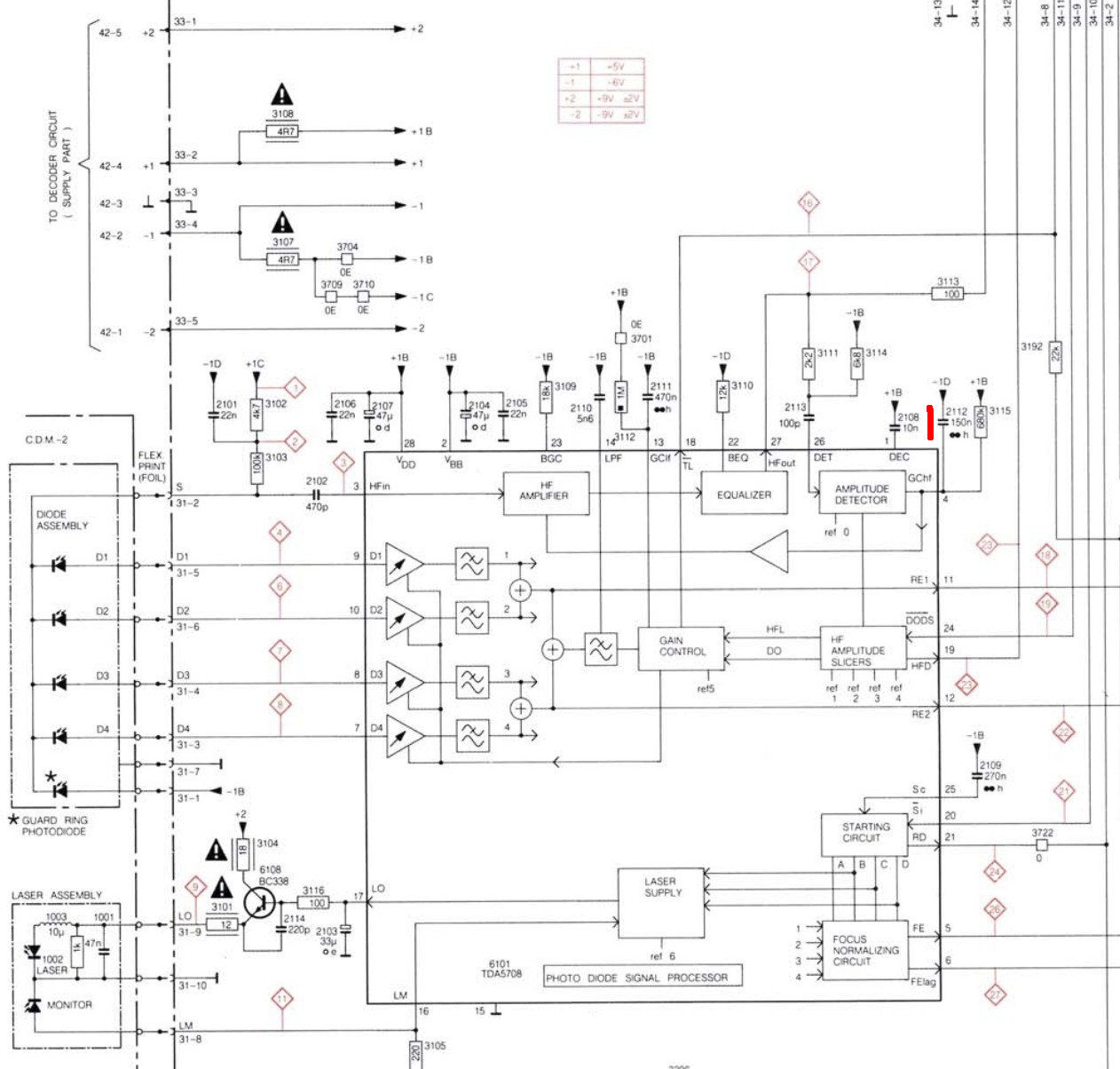

Yes, the scope and probe is calibrated, I used it in the x10 setting, the laser ist adjusted to less than 50mV (on most CDs somewhere around 43mV), focus offset is set around 400mV, and the eye pattern doesn't look clipped on the scope (see attached screen shot). I checked the surrounding of the RF amp IC:
the DC supply to the servo board has -12V, -5.6V, +5V and +10V. The network at pin13 of the TDA5708 is correct (gain control of LF amp), but the network at pin4 (gain control of HF amp) has a 470nF film cap instead of the 150nF (ref 2112) that is shown in the schematic. I checked the other parts around the TDA5708 including the 3 white SMD caps (are they C0G?): the HF blocking cap at pin3 (2102), the DET cap at pin26 (2113), and a cap in the laser supply near pin17 (2114), all of them measure perfectly fine.

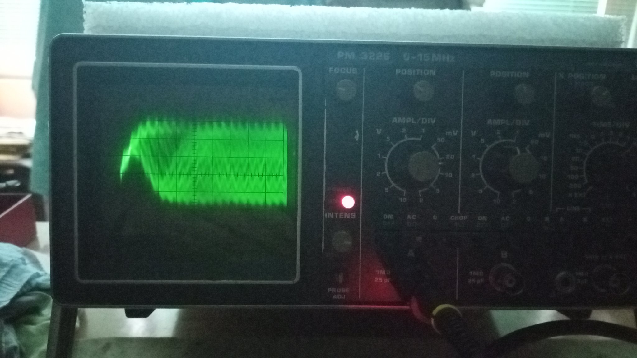

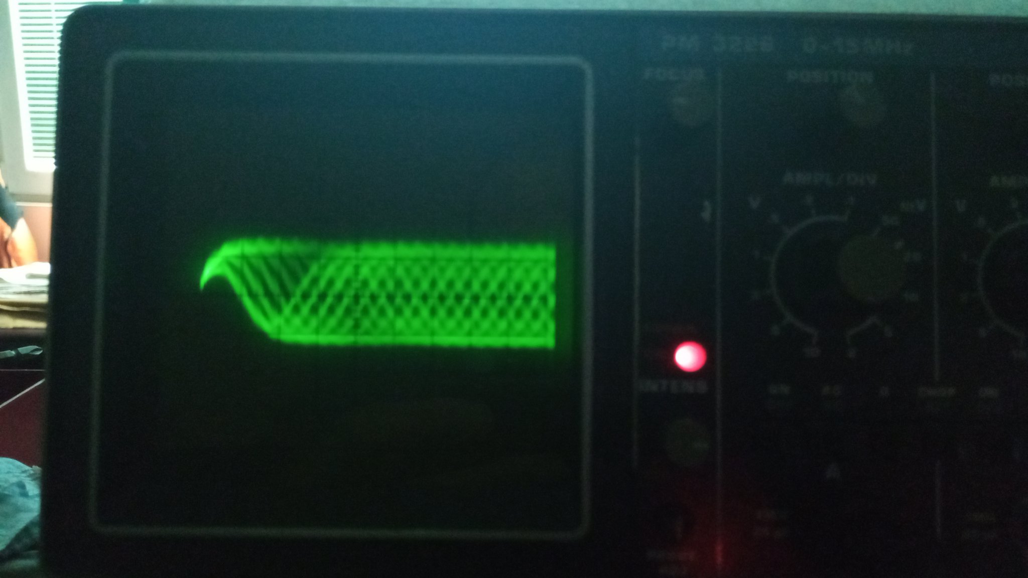

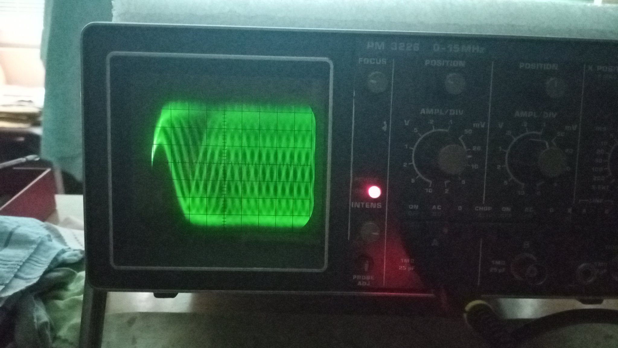

Hi guys,
I think the analog scope is working fine now.

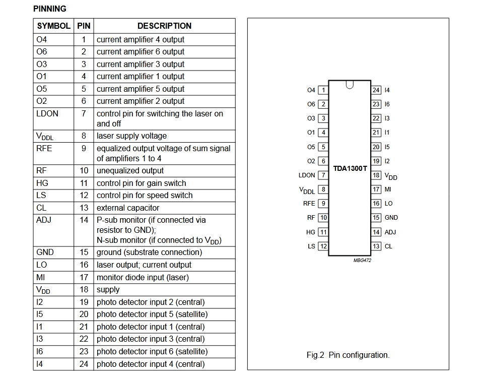

However, I cannot find the RF signal. I am looking for on the ribbon cable to the servo board. Is that where I should look for it? I try on a disk that reads normally.
The range is set to:
AMPL/DIV : 200mV
TIME/DIV : 0.1ms

With a disc playing normally you will be able to find the RF on the chip the the ribbon cable goes to (on the main board). Normally a quick whizz around the area with the scope will find it without having to look up any circuit details but if you can not locate it then identify the chip and look up its data sheet to find the RF output.

At face value it does seem low, also the CDR result can not be used for any measurements. If its correct on a normal pressed CD then whatever a CDR comes out as 'is what it is'. 0.14 volts isn't an expected value and a player wouldn't work down to those levels so I suspect the measurement point or the measurement itself is in error.
Are you taking into account a divider probe? 140mv pk/pk at 50mv/div would actually be 1.4 volts if using a divider probe.

Mooly, the chip is tda1300t. I measure between pin 10 and pin 15.
Oops, the probe was in 10x mode 🙂
👍 pins 10 and 15 look good to me. So 1.4 volts pk/pk.

Its worth seeing what you have on the input to the chip. If that is 1.2 volts pk/pk (ish) then I would say it was normal and maybe something different in production.
Ok, thanks for the hint! I checked the data sheet of the following IC that takes the RF signal in, in my case it's a SAA7210 which expects a differential signal up to 2.5Vpp, so I guess the Arcam guys intended to set the gain of the TDA5708 higher by applying the somewhat unusual supply voltages and/or with that 470nF cap at the gain control pin. I will leave it as it is because it works flawlessly.
