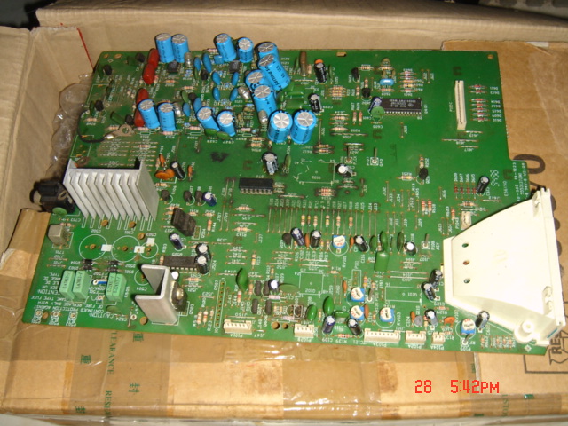

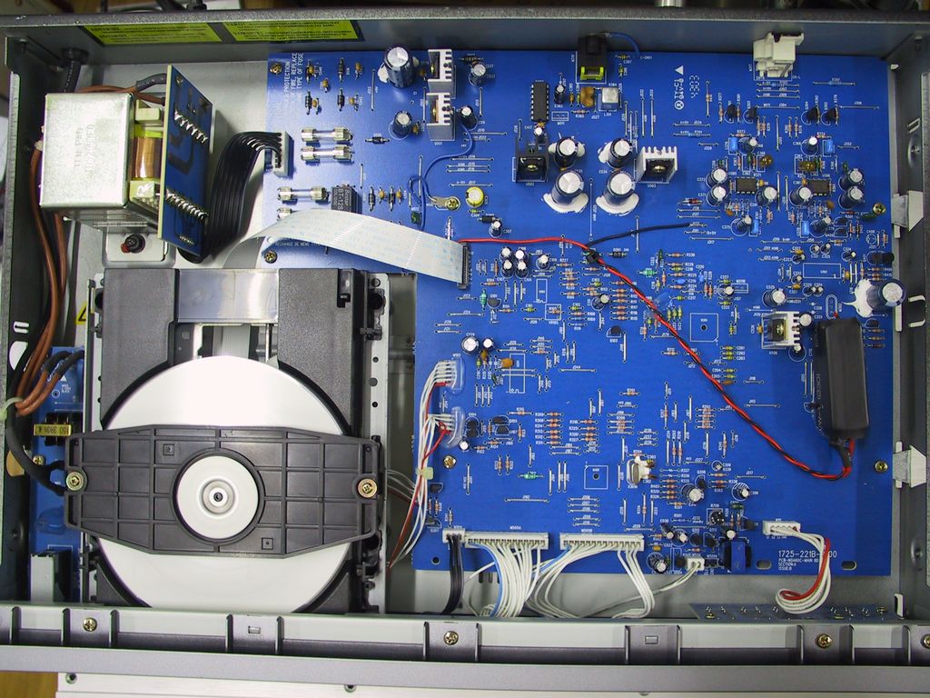

Audio Pro CD.7 similar to NAD 502 and 514

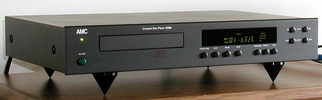

Also similar model is the AMC CD-8b
