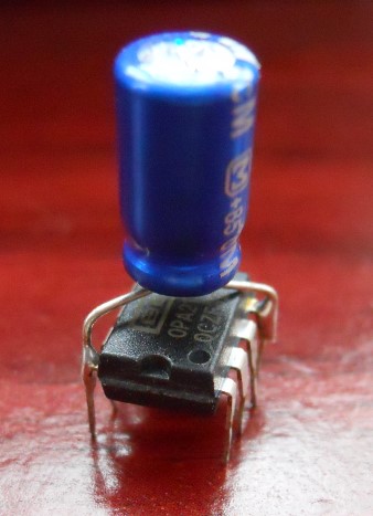

One more question.. Am I wasting my time and money buying "audio grade" capacitors for this? Elna Silmic etc, vs the normal Panasonic/Rubicon from Farnell etc? I have a big list of caps 😀
Erm, everyone has their own ideas on this 😀
(I would fit good quality commercial grade parts every time here, make sure the size is correct as there is nothing worse than big parts that don't fit and then having to 'wire' them in... which in most cases not only negates any possible benefit but can actually be very much inferior as it is open to pick up and increased impedance. So Pana and Rubycon from Farnell and the like are perfect. Go for 105C rated where possible as these tend to be higher spec than 85C rated parts and check those dimensions)
