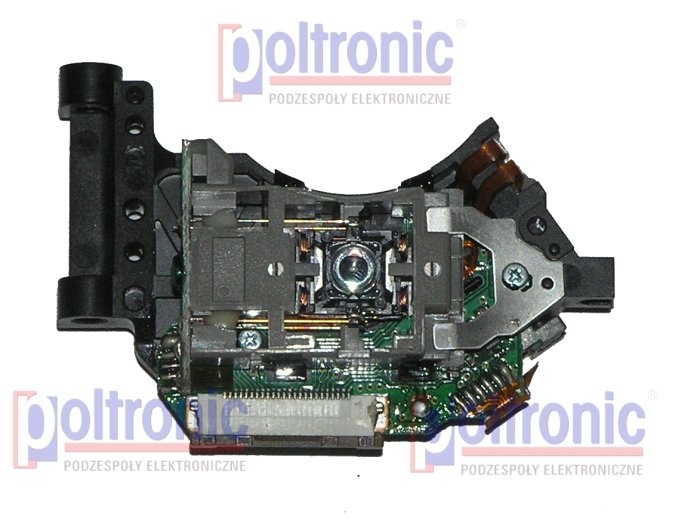

I have a Shanling CD S100 using, I believe, a Philips 12.1 transport and a Sanyo SF-HD850 optical pickup.

I'd read that changing the laser fixes the problem. I did this but I've exactly the same problem 🙁
If I change the transport etc will this cure it or am I stuck to a Philips 12.1 (or VAM1210) and Sanyo as above, hoping I finally find a comination that works?

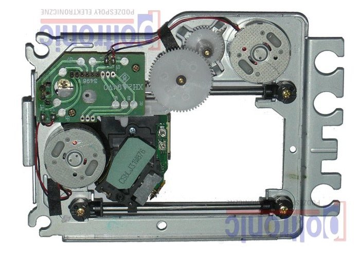

I am puzzled with the references to the CDM12.1 and Sanyo pickup. The CDM12 is a Philips unit and has no connection with anything Sanyo.
CDM12.1 here,
cdm12.1 - Google Search
Sanyo here,
Sanyo SFHD 850 - Google Search

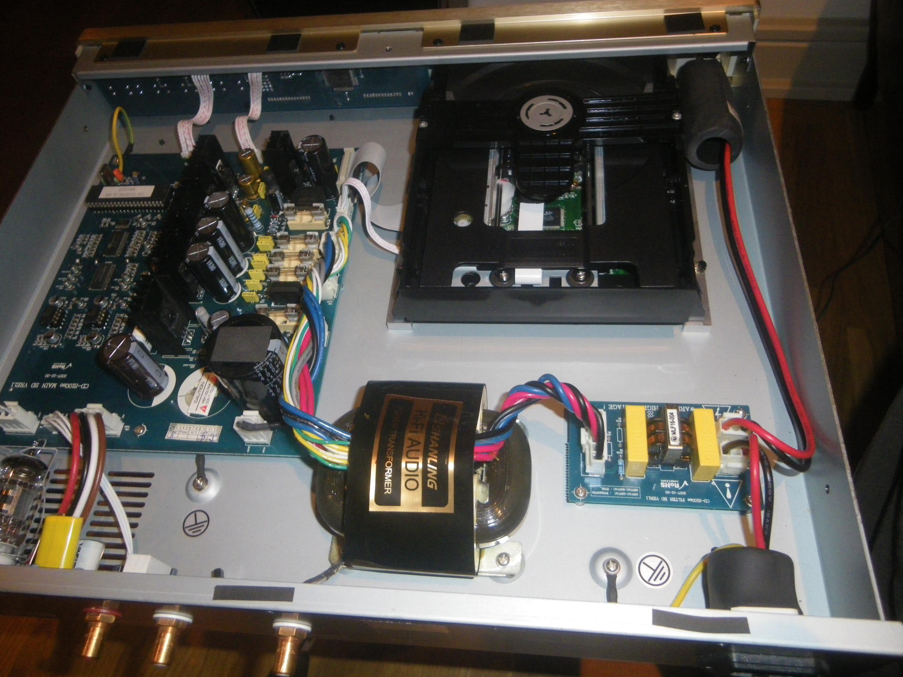

The unit makes the same noise regardless of the condition of the disk (even brand new). I diagnosed the transport type from all the reviews I've seen, such as this:
Product Review
but if it's different then fair enough (pics below).
The laser I replaced was the Sanyo one but I'm not sure what to make of it all now.
Is it as simple as buying a cdm12.1 as shown in your link, with the laser assembly and sled attached (or a VAM1210 if easier to find) and that's it?

It's not a Philips CDM12 for sure.
Not familiar with the unit, but, looking at the large ribbon connector to the pickup I wonder whether this is in fact a DVD drive (which many manufacturers use for both good performance and cost), in which case they can be a little noisy in my experience,
Thanks. To tell the truth I only looked up the transport type recently and long after replacing the laser (so convinced was I that it was the laser).
Do you reckon, I'd be better off using another transport and pickup in there instead? They're cheap enough and I've so far had bad luck with both attempts with this one. Is a straight switch like this possible or not so good an idea looking at the circuitboard fixed to it etc.
If the other Shanling units as per the reviews are anything to go by, a 12.1 should "fit"?
I'm now, and was a little before, out of my depth.
Apparently it's a HDCD so the wider ribbon may explain it but yes, I think it's a DVD pickup.

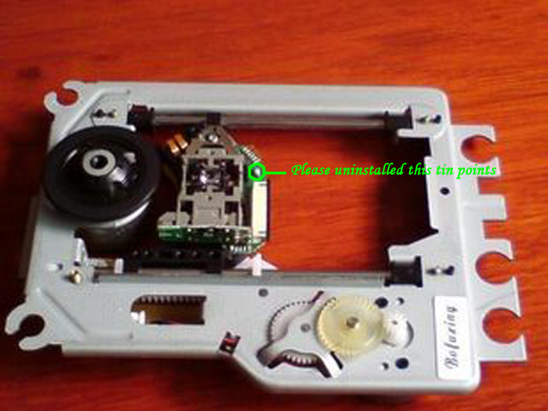

The shop tells me:
Hello!
"I am sorry.
Products in send out before,We must undertake strict test.
Laser head is more accurate instrument, In order to ensure the safe transport of laser head, So some laser head need added protection solder joints.We must use before use iron solder open this protection, Otherwise, laser head didn't light.
Thank you!"
Does this mean I have to de-solder something on the pickup?

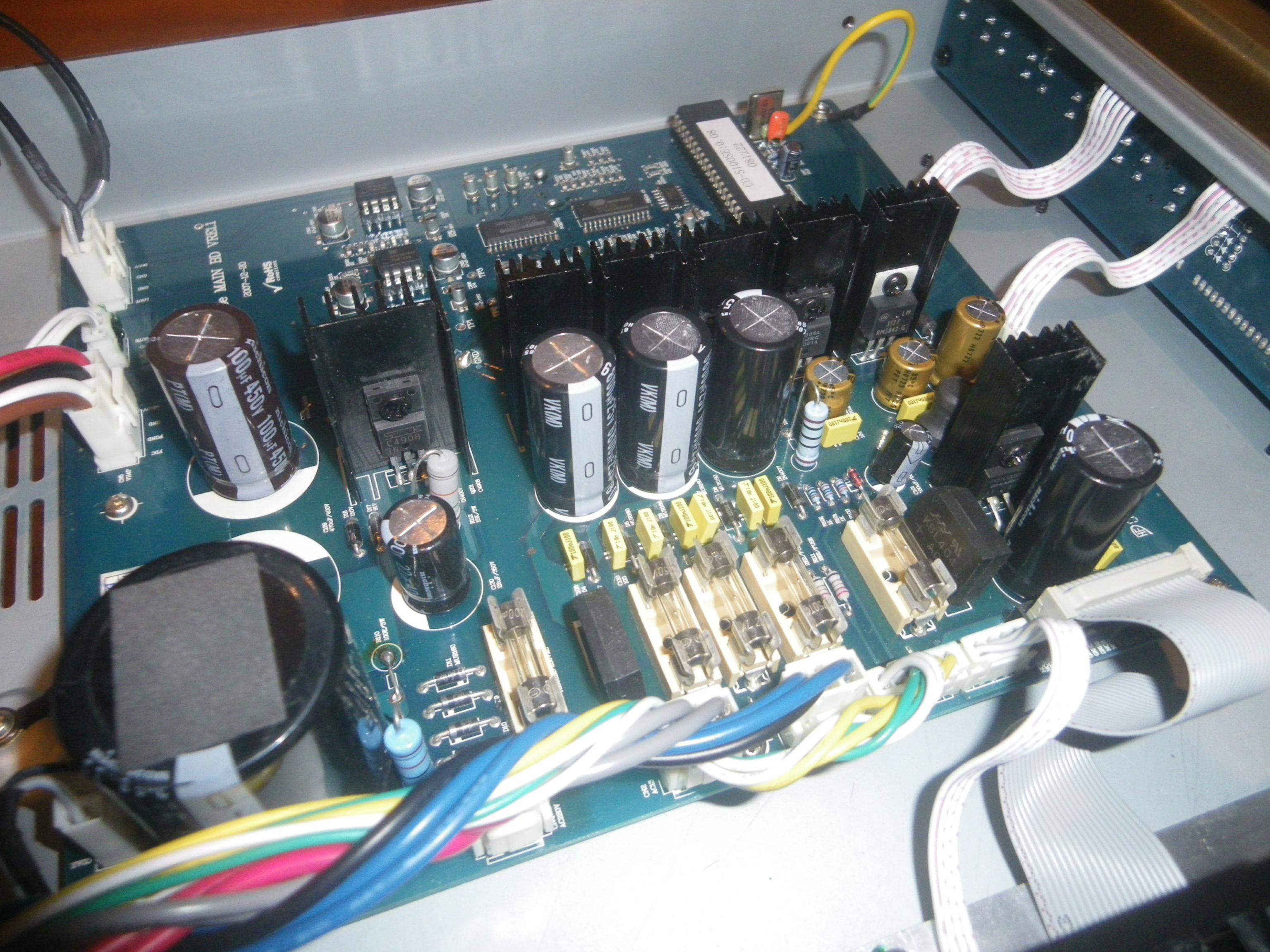

Are the trim pots easy to locate (No, because I'm asking but you know what I mean). Where are they and what do I do?

Any adjustments may need to be done via software or a modified "service" remote control etc however I still think the noise is going to be "normal" and not something that can be adjusted out. As mentioned DVD drives are often noisy... just try playing a CD in a DVD recorder.
I couldnt see any on the board, but they can be pretty small. There are 4 adjustments that might be considered 'typical', but not all players have them. They have to do with how the player tracks the 'grooves' on the disc.
Basically, the transport is looking for the groove in a certain place. The pots adjust where its looking. Its never perfect, so the mechanism has error correction to find the groove. If the adjustments are off its giong to be looking in the wrong place. The chirping is the error correction working harder than expected - moving the laser around and such.
There are other symptoms that go with this problem. The player will be picky with discs, especially those that are not mint. It may also not play discs all the way through, or take an unusually long time to load.
In almost every case, there is a very little pot, often looking like a little disc, on the laser itself. You may want to try fiddling with that.
