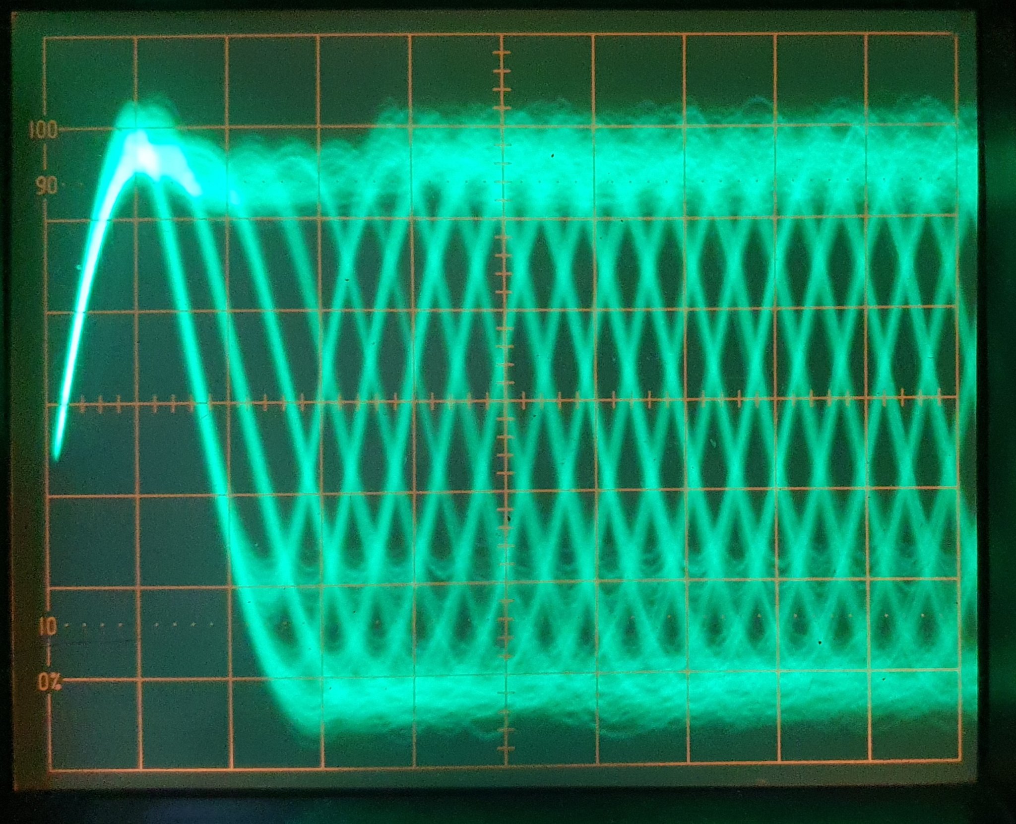

I have this CD nearly impossible to play:
https://www.discogs.com/release/7480130-Johann-Sebastian-Bach-Miklos-Spanyi-From-Das-Orgelbuchlein
I measured the eye pattern an it is about half of any other normal CD. It is even lower than that of a CD-R. One literally can see through it.

Frame it as an example of a really bad CD pressing.
CD-R are totally different. Normal CDs are pressed, then metallized. CD-R discs depend on the laser to burn the coating so it doesn't reflect. There are so many differences between them that CD player manufacturers do not warranty their machines will read a CD-R. They usually do, but HF level may be well out of spec.

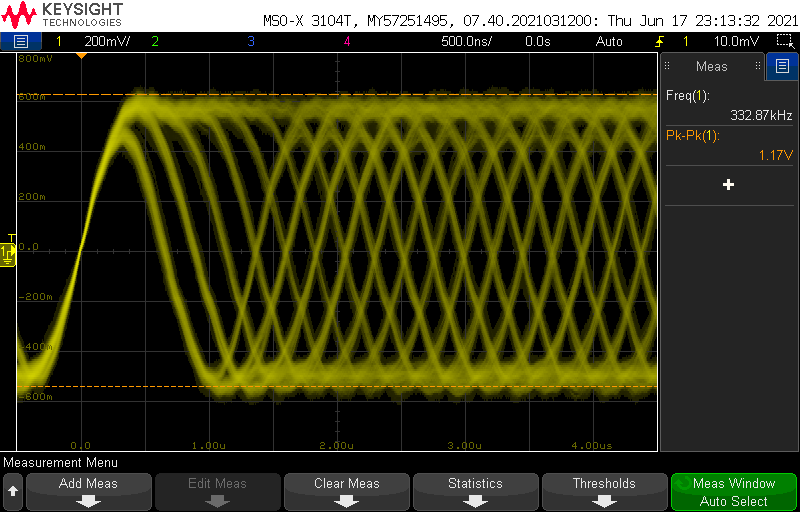

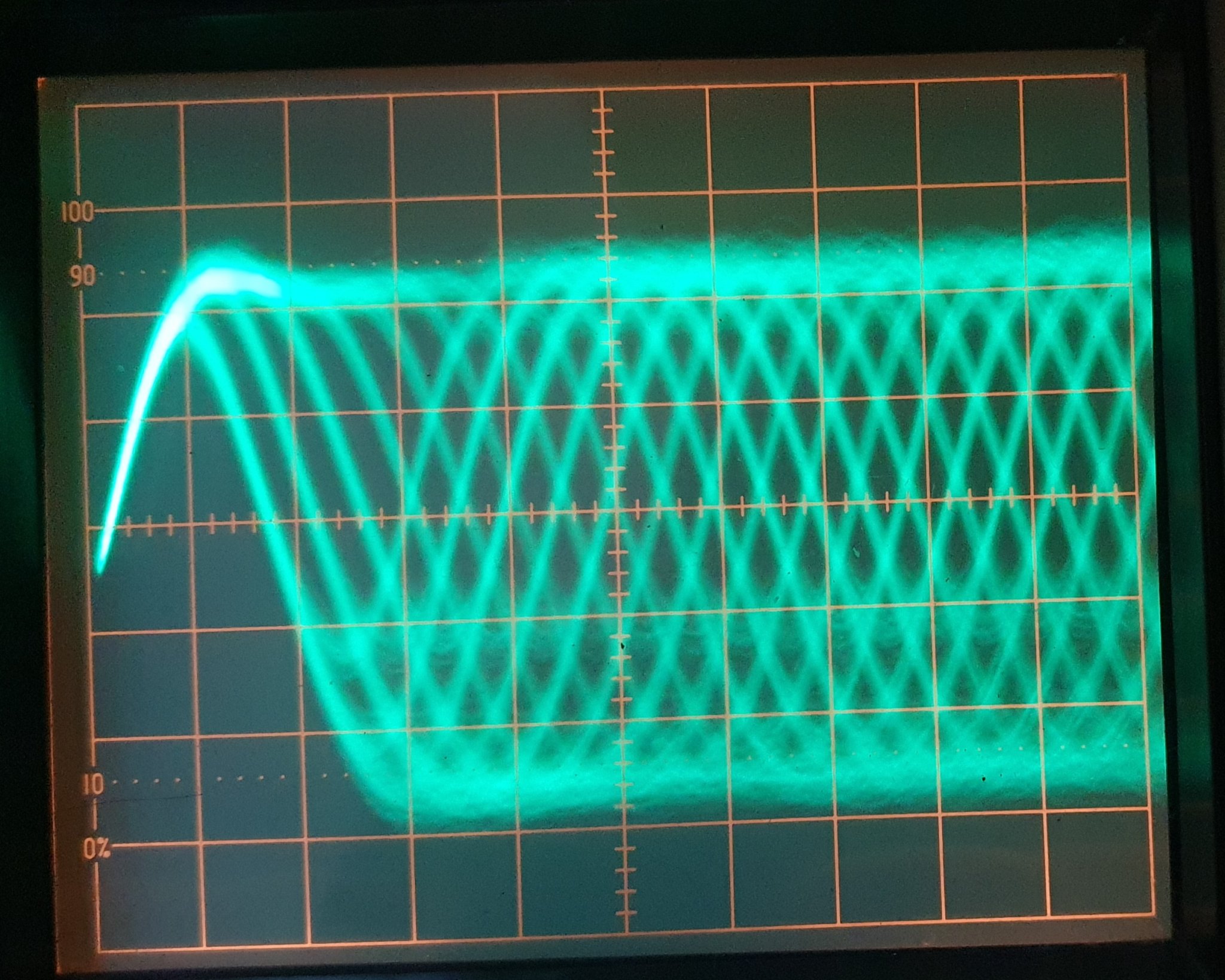

Could you post an image of the eye pattern?I measured the eye pattern
In my case the oscilloscope is too old but it was a present so I cannot complain 🤣🤣 the quality of the signals that I can see is a good value for money (0€) 😂
Indeed but that shot is way better than most hobbyist oriented digital scopes could ever dream of. Nice 🙂I like analogue scopes for this work.
That is the one most important reason I bought this scope. It replaced three instruments and was the only digital that handled like an analogue scope with a decent eye pattern. That was my #1 test when I tested all the scopes at the time.

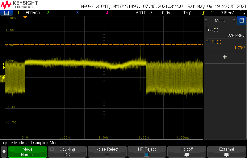

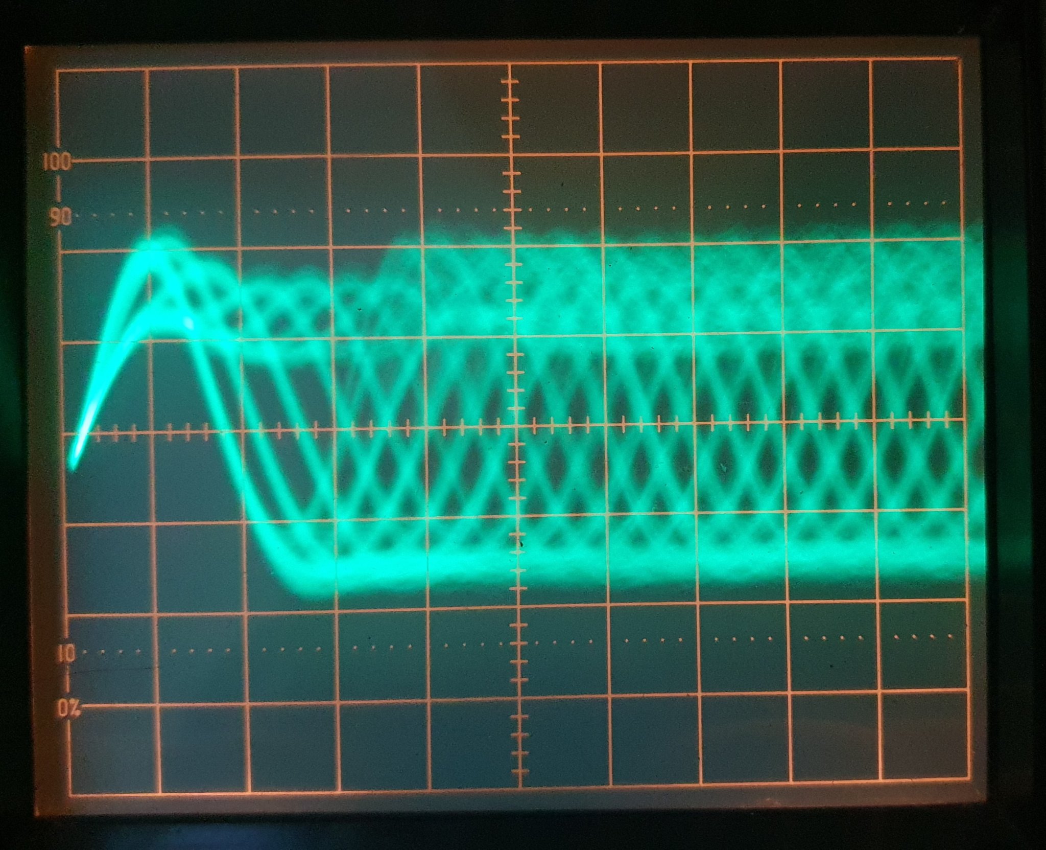

Here's how I set E-F balance. Pierre Verany test CD, two disc set.
This is a massive interruption in the information layer, most CD players will not track this. It's a Denon DCD-1630G, my bench unit. I liked the DCD-(1,2,3)560 series much better with the KSS-151A head, better machines.
