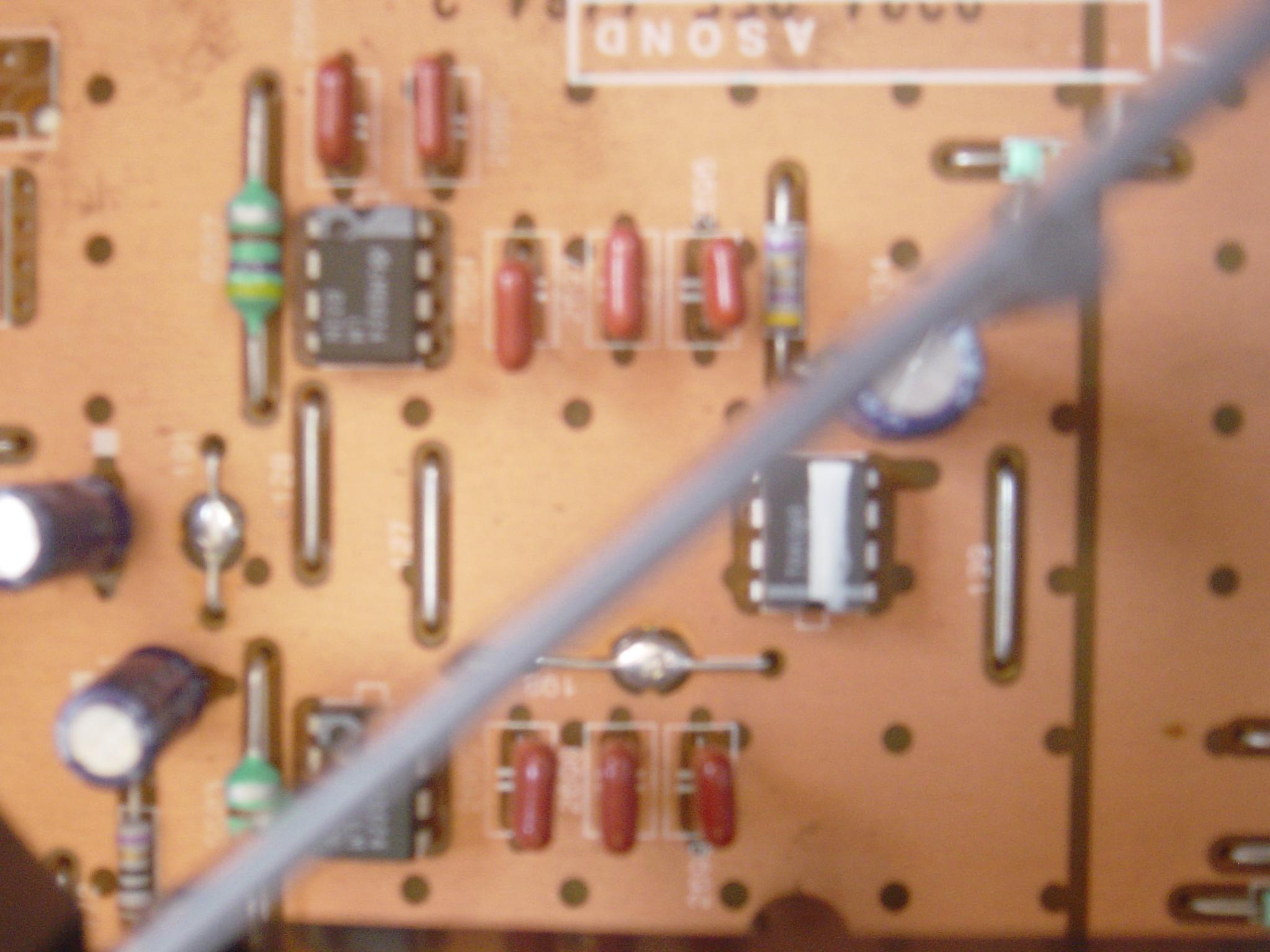

Hi, I know that one if it is the one with the yellow LCD display. Cheap but reasonably good sounding in stock form. If I am not mistaking it has a Mitsubishi chip driving the TDA and LM833 at the output which can be omitted or replaced. Please remove muting transistors anyhow.

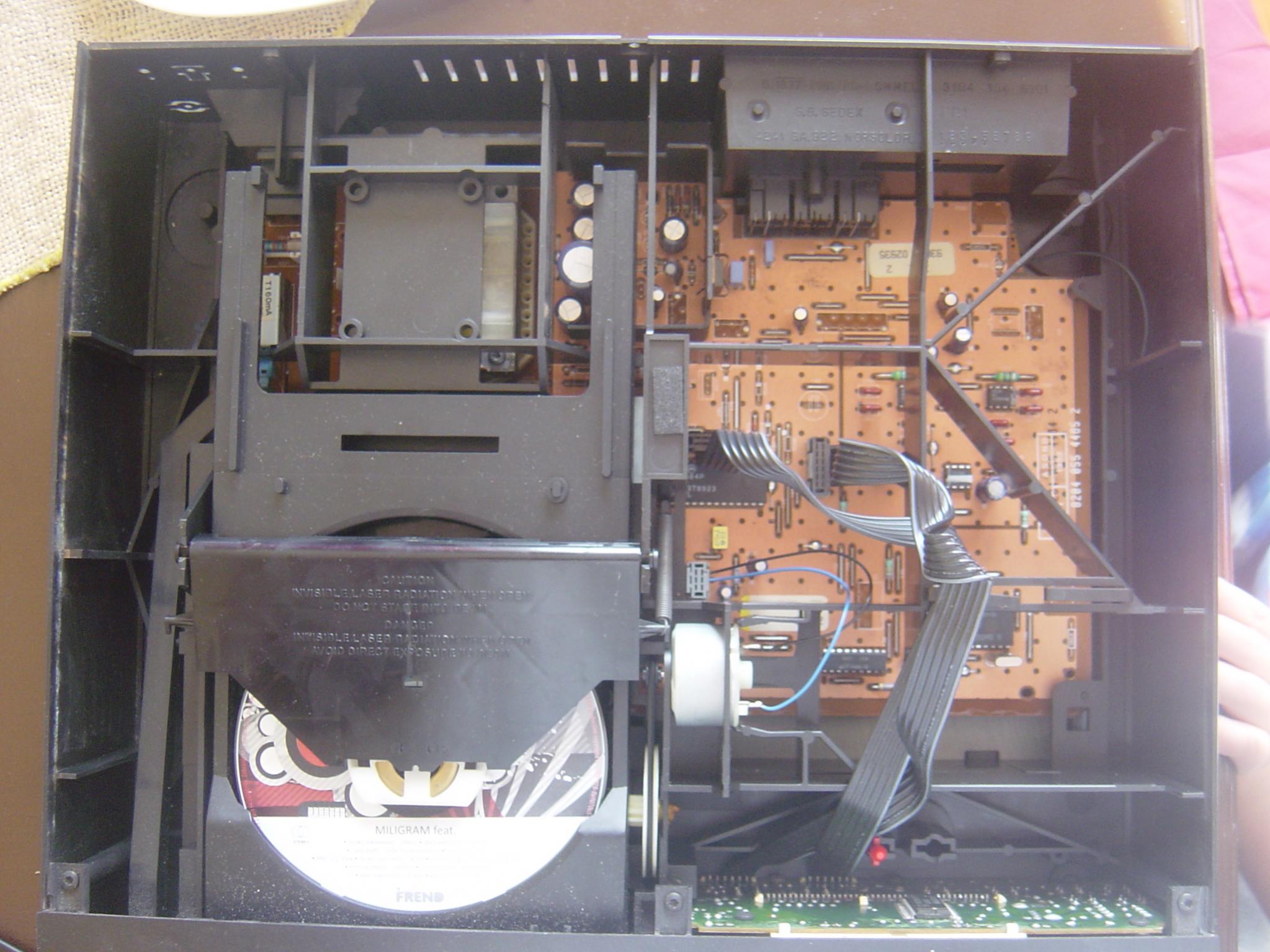

My CD Player is in stock form.take look at the attachments for more info.
The purpose of this thread was to get into cd player mods and learn what is the most cost effective way to upgrade.I don't want to buy kits,or spend lot of money on it.I can do psu upgrades with the parts I have,I also have bypass caps. For clock circuit,if it i is a good upgrade, I am willing to invest some money,but to build one.About I/V stage,I would use a simple resistor followed by an discrete active stage and a passive Bessel filter.I know that I need to make DAC non oversampling to go without the filter.
So guys, suggestions in that direction are welcome.
Sorry about the quality of the photos.The DAC is the chip with the white line.The line is factory made.The other two chips are the analog section.

Hi - I think somebody else linked the service manual here. I played around with the 1543 for a while in NOS (that mod's also detailed in the link) with great success. I think I just had a resistor to ground (1.2K) on the output, a 100uf cap bypassed by a 100nf and another resister to ground (100K) - check those values though! One of the biggest improvements I have made on my current TDA1541 player is the addition of a dedicated PSU on the filter (SA7220 in your case I think) just a +5v using an LM317 from a separate transformer, lift a resister or jumper as near to the chip as you can get (make sure nothing else 'feeds' from this), then ground it either under the board on the pin itself or again as near as possible. Keep any decoupling caps in there.
You can go further with these mods by giving every stage a dedicated PSU including the DAC, even running off the original transformer but with a local regulator at least. (For the psu I just used the 'low ripple' schematic from the lm317 datasheet.) I think the DAC can take a higher voltage (8v+ check though!) but I never experimented here.
I thought the NOS tda1543 was great, you can get the dac chips in the uk cheap and the supporting circuitry is dead simple.
I'd be tempted to go NOS, tap into the i2s signal before the dac, then build a separate DAC board, you can experiment with topologies & output stages then without disturbing the rest of the player.
Happy modding!

I do. A better clock will almost always pay off but I would search for the least expensive solution concerning the value of this particular low budget cd player. Please check the frequency, I might have a clock left. I don't use cd players anymore for some years now so things are fading but I recall the strange Mitsubishi chip with an odd clock frequency. AFAIK there is not a crystal in this cd player but a ceramic resonator (even worse).

Removing wrongly implemented muting transistors (i.e.collector on signal) is a good mod and you will hear the difference at once. Costs nothing, takes one minute and it is easily reversible.... I haven't experienced cases where i could not hear an improvement. Slight drawback is that you can hear pops with very heavily damaged cd's or at power on. Set the volume to lowest setting when you quit playing music or switch the amp to another input when switching the cd player on. Of course you can use a small muting relay if you like the muting. Please have it shorting the output at power on and not in series with the signal.
http://www.diyaudio.com/forums/parts/199156-mute-transistor-choices-2.html
I would leave the filter where it is and improve decoupling of the new opamps. This is a quite decent sounding cd player when modded right. I recall having changed all caps for Pana FC/FM and the opamps.
