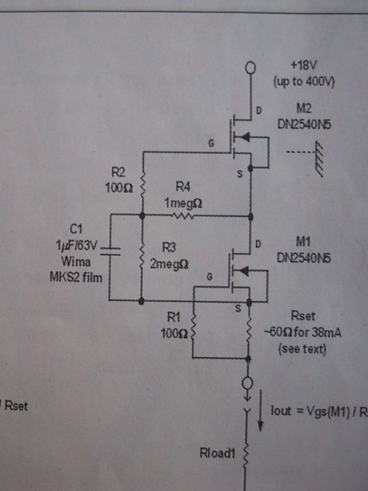

I have been messing about with CCS anode loads for a headphone amplifier, and it's taken me the last month to notice that the idle current stability isnt all that great 😡
I have been using two different stages, loaded with different CCS; one BJT cascode delivering up to 1mA (BC557 and ZTX558), and another MOSFET cascode delivering up to 8mA (both devices DN2540).
Both circuits use LEDs to lift the cathode above 0V, but I have replaced the LEDs with bypassed cathode resistors of appropriate value to get close to the same Vg.

Besides the obvious, adding a heatsink..., what's the best way to mitigate this? Any clever tricks out there? Maybe adding a PN junction between the D-S cascode connection, and bonding thermally with the CCS MOSFET?

I drop a total of 50V across the cascode pair, at up to 10mA; so 50×0.01 about 0.5W.
Any ideas how I can reduce this drift further?
Can I use a diode or two between DS cascode connection thermally bonded to one device of the other, to compensate for the drift?

For reference, I built this schematic for CCS using DN2540, which was mentioned in another thread, not so long ago.
It has been mentioned in that thread, that turn on transients damaged the capacitor eventually and I have experienced this.
I'll probably build a simple cascode and bin this schematic and check I still have two functional MOSFETs...

Yes, depletion FET CCS have a tempco. But LEDs do as well, and the performance will not be improved much (if at all) by using them.
A stable anode voltage while presenting a horizontal anode load-line is exactly what a "Gyrator" style anode load is designed to do. Check out diyAudio member Ale Moglia's Bartola Valves site, to see a good implementation of this method.

As Rod said, FETs have tempco which are the cause of your drift in current. If you get hold of this book: Linden T. Harrison’s “Current Sources & Voltage References”, highly recommended. Linden explores in detail and provide the formulae to get to the zero tempco bias point of the FET. Given the variance of the FET parameters, it's just indicative. I covered some of this in my lecture at ETF.18. You can read it here (have a look at page 15 in particular): ETF.18 DHT Preamps Lecture – Bartola(R) Valves
For the LND150 voltage reference, a current between 300 to 500uA is ideal. I haven't measured the DN2540 but has not great tempco. In fact, looking at the datasheet, assuming minimum IDSS=150mA and a VGS(off) = 2V, I(0TC) is about 15mA. Above that, you get worse tempco. Again, DN2540's parameters (IDSS and VGSth) are all over the place so it will depend on the device.
There are more complex circuits to implement to improve tempco on a 2-pole CCS, you can move to a bipolar CCS with PNP cascode though and with a more stable voltage reference.
