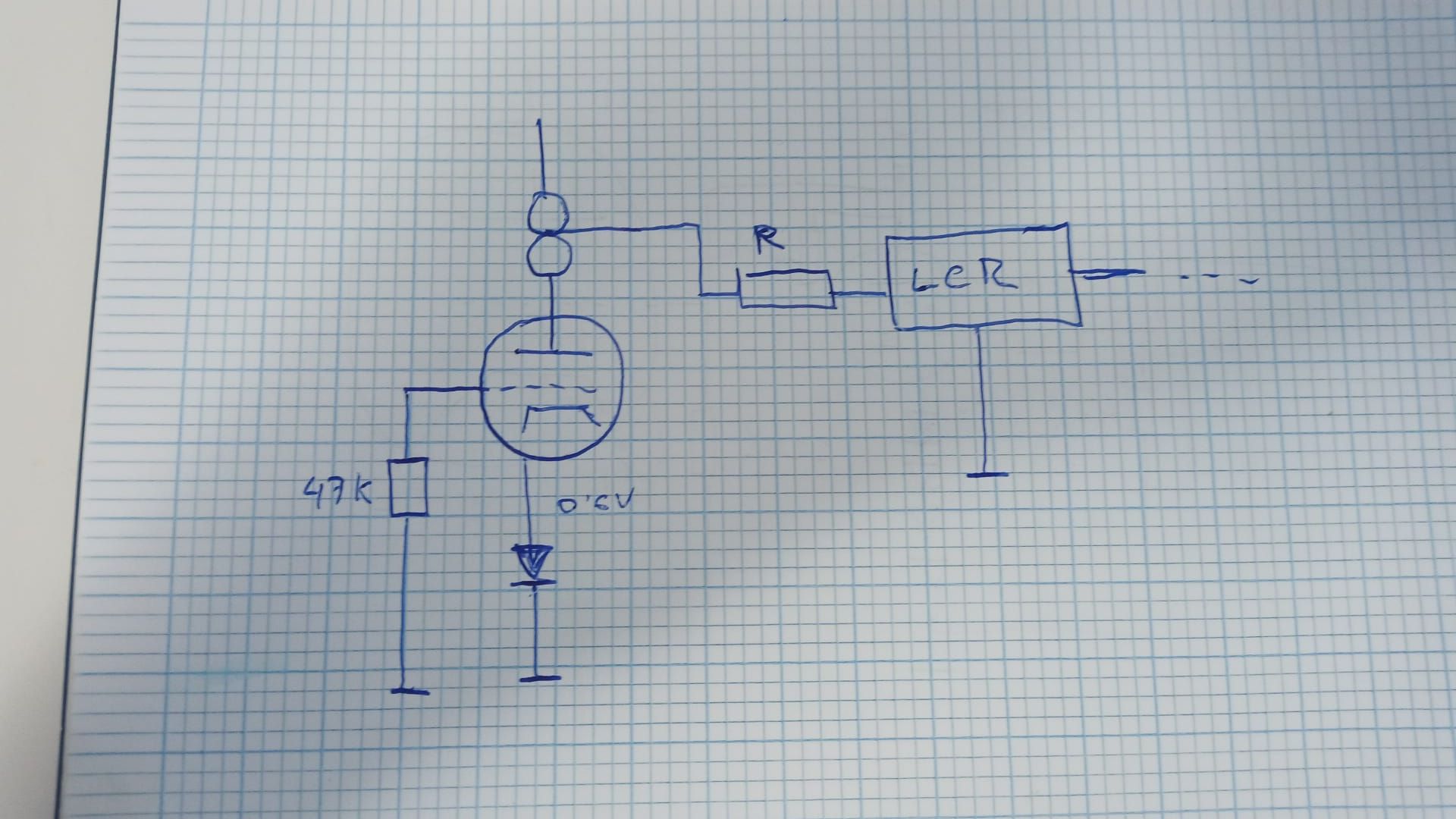

I try to calculate the Z of CCS low mu E180f triode for a phono preamp with LCR eq to match the LCR haismoto 600ohm need to be precise in z out:
Zout = Rp / (1 + μ * gm * (Rp + Rk))
Rp ( triode ) = 2700 ohm
μ = 50
Rk ( her207 diode cathode ) = 5 ohm ( maybe less )
Zout = 2700Ω / (1 + 50 * 4.4 mA/V * (2700Ω + 5Ω)) ≈ 11.54Ω
Who can confirm the Z out
Any idea, I'm not familiar with these formulas found on the internet.
other option to match without loose gain transformer 2700:600 4.5:1 loose 4.5 times the gain.

I need to know the Z to adjust to 600ohm with Resistor before LCR,
"Zout = Rp / (1 + μ * gm * (Rp + Rk))"
Where did you find this formula?
It shows nothing of anode load parameters.
If you use simple grounded cathode stage, the output impedance is (un-bypassed cathode resistor Rk, triode rp, Ra anode load) from the anode:
Zo = (rp + [mu +1]*Rk ) || Ra
If you use CCS, the CCS impedance is orders of magnitude greater than tube's rp, so from anode the output impedance is almost rp.

BTW if you want to load LCR EQ module, there is two method:
1.) driving it with LCR (estimated) own impedance (for example 600R) and loading with large resistance (as @revintage suggested);
2.) loading it with 600R and driving with undetermined (not 600R, but not larger than few kOhm) impedance.
The LCR modules average loss is -about- 20dB (1kHz).
Euro21,
Absolutely correct. On the downside is that the LCR network must be driven by an very lowZ source, if the signal loss is to be kept to a minimum. Ie a Zout of 1.8k will give a loss of 12dB(added to the 20dB loss in the network). Consequently a driver Zout of 600ohm will give a 6dB signal loss.
This means a E180F should be used with a CCS follower with enough current to drive the network. In this case the Zout is not critical.

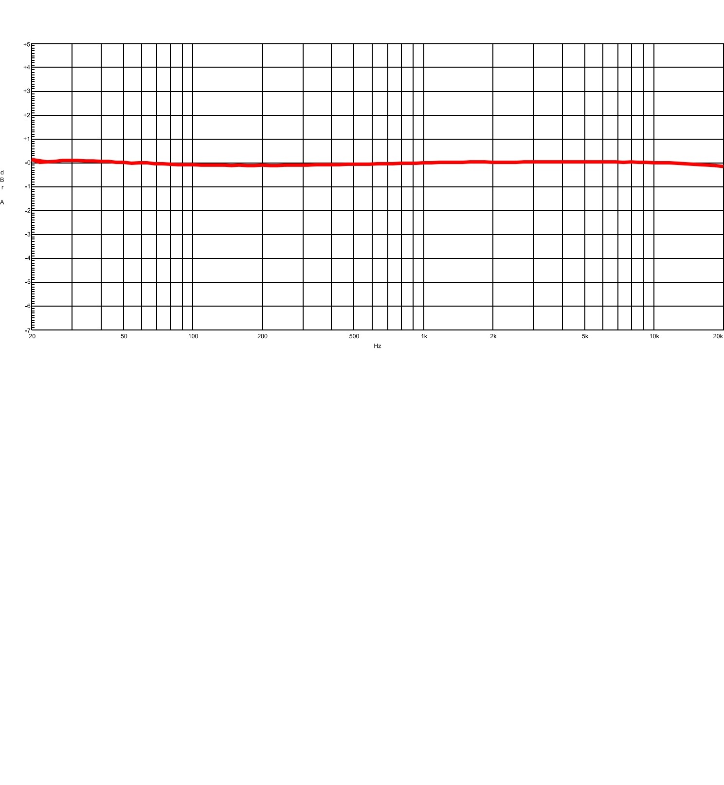

In attach the respone of LCR network only
Zs=600 ohm
Zload= 100k (red), 47k (blue), 10 k (yellow)

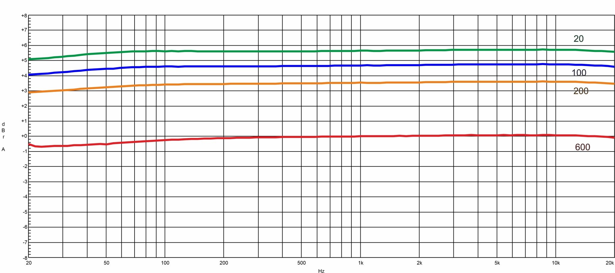

Then the response with diffrent Zsource and Zload=600 ohm
little bit better and different level

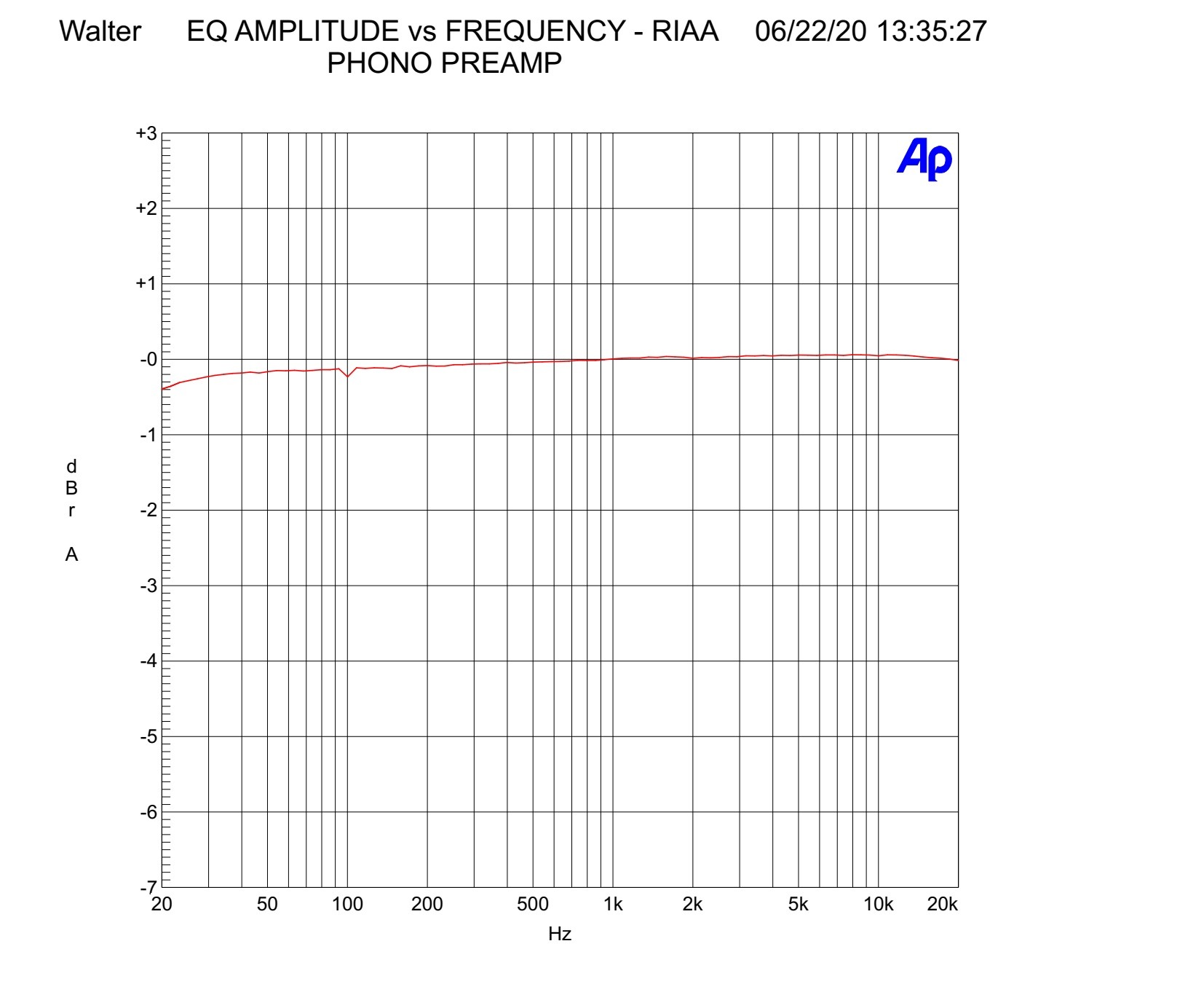

Then the response of Tango network terminated with 600 ohm

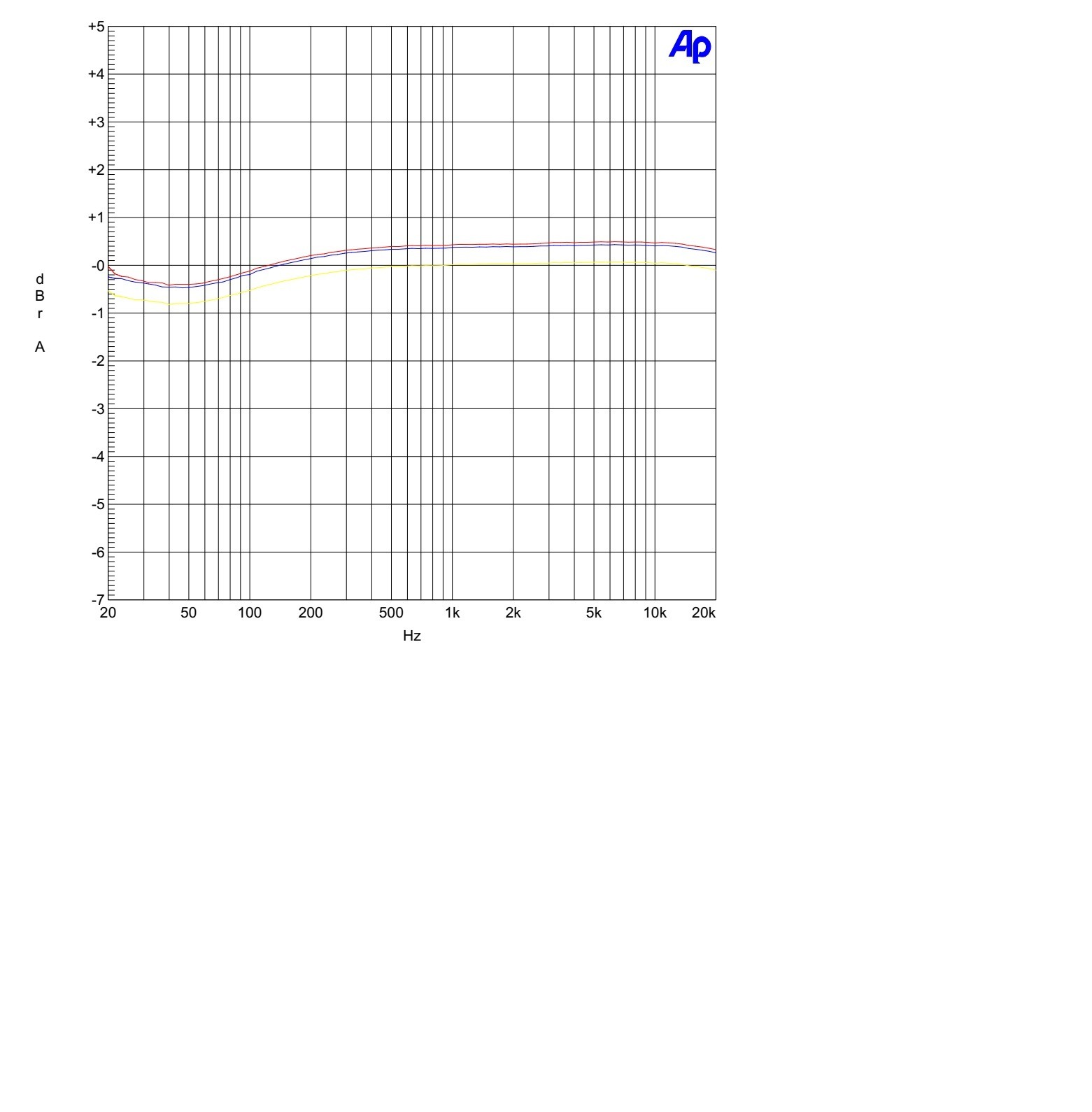

Then the resppnse of all circuit with the load of LCR with 600 ohm anf in parallel a trimmer to fix the best response, it is only a test.
The trimming of load compensate the little differences on coils and other components mainly in th e low freq.
In the final test the trimme was no used and the respnse was also good.
Last respone
In every case the LCr MUST be terminated with 600 ohm.
As the Tango data sheet says
