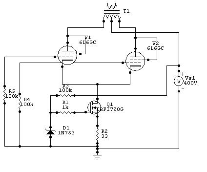

I'm using a 12V 30A LED switching supply an 8200uf cap for the heaters and LEDs. It connects with 15 gauge speaker wire and banana plugs.
The high voltage is actually a voltage doubler off of a 120:62-0-62 300VA toroid. Runs through 2 6H chokes in parallel into 3500uf. Then it runs through a female to female 5.5/2.1mm DC power jack. The wire was rated to 300V anyway and so far everything is good. I'd prefer to use screw on DIN connectors though.

Mainly because they wire in just like the LM317 would so it's a simple drop in replacement. They're also about $1 CAD a piece on eBay at the moment 🙂
I also wire point to point so one heat sink is easier to work around.
Nice. I think you'll be pleased with the result.
Another reason I went with CCS was to try toroidal power transformers as outputs (and because there's no DC mismatch they actually sound damned good).
This was my first integrated amp attempt so it has an 6N1P/6N2P Aikido phono, 6N5P/6N6P Aikido headphone, 6N1P ACF buffer, 6N1P CCDA driver, and a 6N2P doing floating paraphase into the CCS loaded 6P1P tubes biased at 56 ma. 300V B+ in tetrode connection.

Using a CCS instead of a resistor increased the efficiency by almost 100 percent.
Really ?
Can you provide some details ?
Really ?
I'm fuzzy on it but with a resistor in the cathode and the plate on a common cathode amp the max efficiency in class A is 12.5%, with a CCS it's about %25 and with a choke load it's about %50. I'll look for some technical papers on it and post them when I find them.
EDIT: This applies to single ended triode amplifiers only. If using a triode in push pull you can basically double the efficiency.
