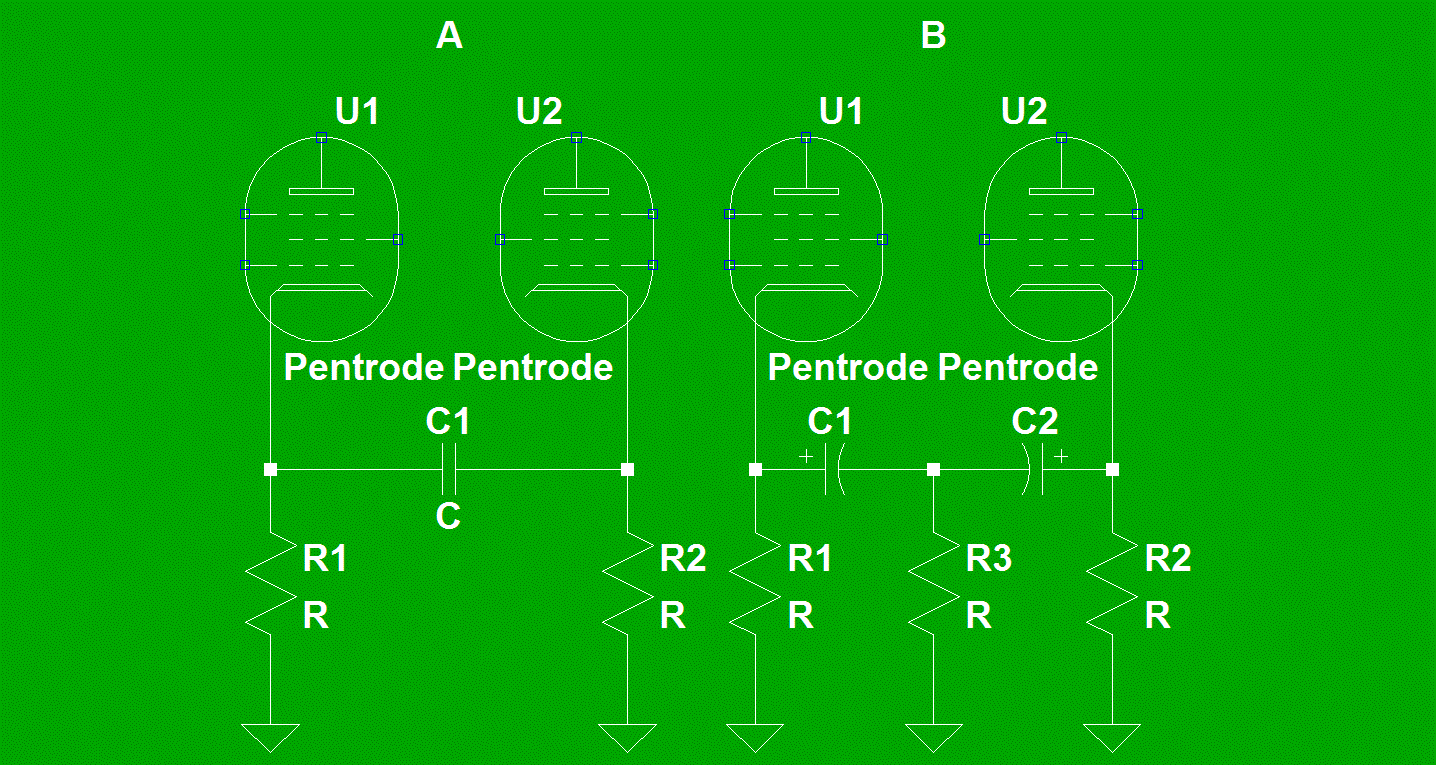

Mosquito asked what is the advantage of cross-couplinmg cathodes with two series capacitors with the centre point grounded via a high value resistor?
The resistor value is completely non-critical and it disspiates neglible power. Therefore it costs only cents and will just about never fail.
It's advantage is that it polarises the cross-coupling capacitors and thus permits them to be electrolytics, which are smaller and cheaper than non-electrolytics in the capacitance required.
However, I said in an earlier post, I prefer to use a non-electrolytic anyway - in which just a single capacitor between cathodes is required.
Yes, I delete the post because wrongly designed schematic. Anyway Here you're answering my question, and I'll try the modification in a Push Pull that I have, to see how this mod affect the performance.

For your possible interest:
6 x EL84 PPP with current source biasing.
http://www.keith-snook.info/amplifier-hifi-schematics/Beard Audio Service data P35 M70.pdf
I used "Ring of two" transistor current sources in my Baby Huey. A general purpose NPN small signal transistor with an MJE340 as the pass device.
The problem with current source biasing is overload recovery. The bypass caps are required to achieve Class AB. When these bypass caps charge up during momentary overload the time taken to bleed away the "extra" voltage is even longer than when using cathode bias resistors.
Ian
Ian

Back to topic, have you actually tried these output stage biasing methods?. If so, which CCS did you try and did you have means to balance the standing currents between the tubes, further.. were you using DHT output stage, or some other 'VW Beetle'.
One size does not fit all, and no need to throw away the foot if the shoe doesn't fit.
L.H
The late Allen Wright was truly on to something with his DPA amplifier. Common kathode CCS (without) bypass capacitor, and means to adjust for plate current between the two output tubes. I was following Lynn Olson and his Amity amplifier with PP drive to PP output, and preferred the SE to PP via a custom transformer in lieu of the Lundah, be it SE or PP drive. 5687/7119 with PP drive less good than 71A in SE drive, for me and me alone. Common kathode resistor without bypass capacitor was better, for me but I had means to adjust for plate current courtesy of the split secondary windings of the interstage. And of course, following on from that comparison between pure cathode bias (bypassed and not so) and fixed bias with grounded filament return. In the end, common CCS in the filament circuit, with means for DC adjustment via simply paralleled pots between the common CCS to signal common with wipers to grid returns (separate), worked very well and sounded about the same in magnitude of order over the aforementioned scheme.
But hey, nothing wrong with cathode bias in the strictest terms.. just to say, don't discount other things, and stop with the 'tubes weren't designed for fixed bias', indeed most if not all manuals, and I have some dating back to 1927, prescribe a C supply.
