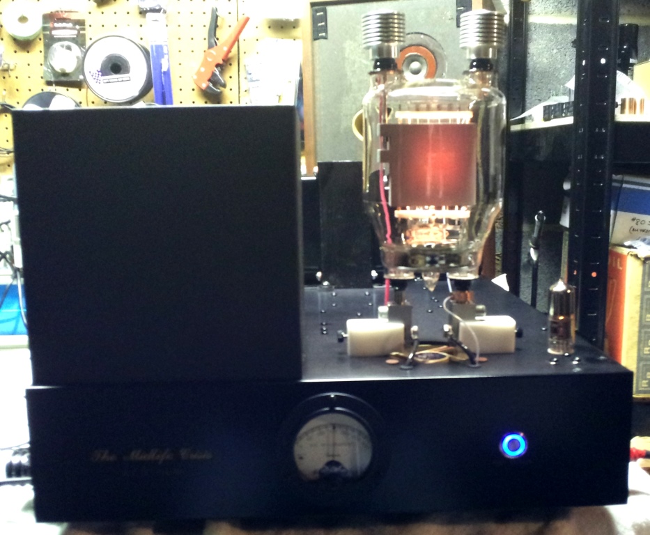

That's why I have a big old 3 1/2" Simpson milliammeter on the front panel. I can read it from my listening chair. An occasional glance at it assures all is well. It's actually been very stable for more than a year now.
That big ugly naked trasmitting tube's anode is glowing red.
Yeuuchh!
But transmitting tubes with thoriated tungsten flaments are inherently more tolerant than oxide coated filament tubes. They are made with much more care.
Yeuuchh!
Yeuuchh!
It's supposed to glow red, it's graphite so it's extremely rugged. The glow is a feature.
Ugly to you, pretty as Scarlett Johanssen to me. To each his own.
